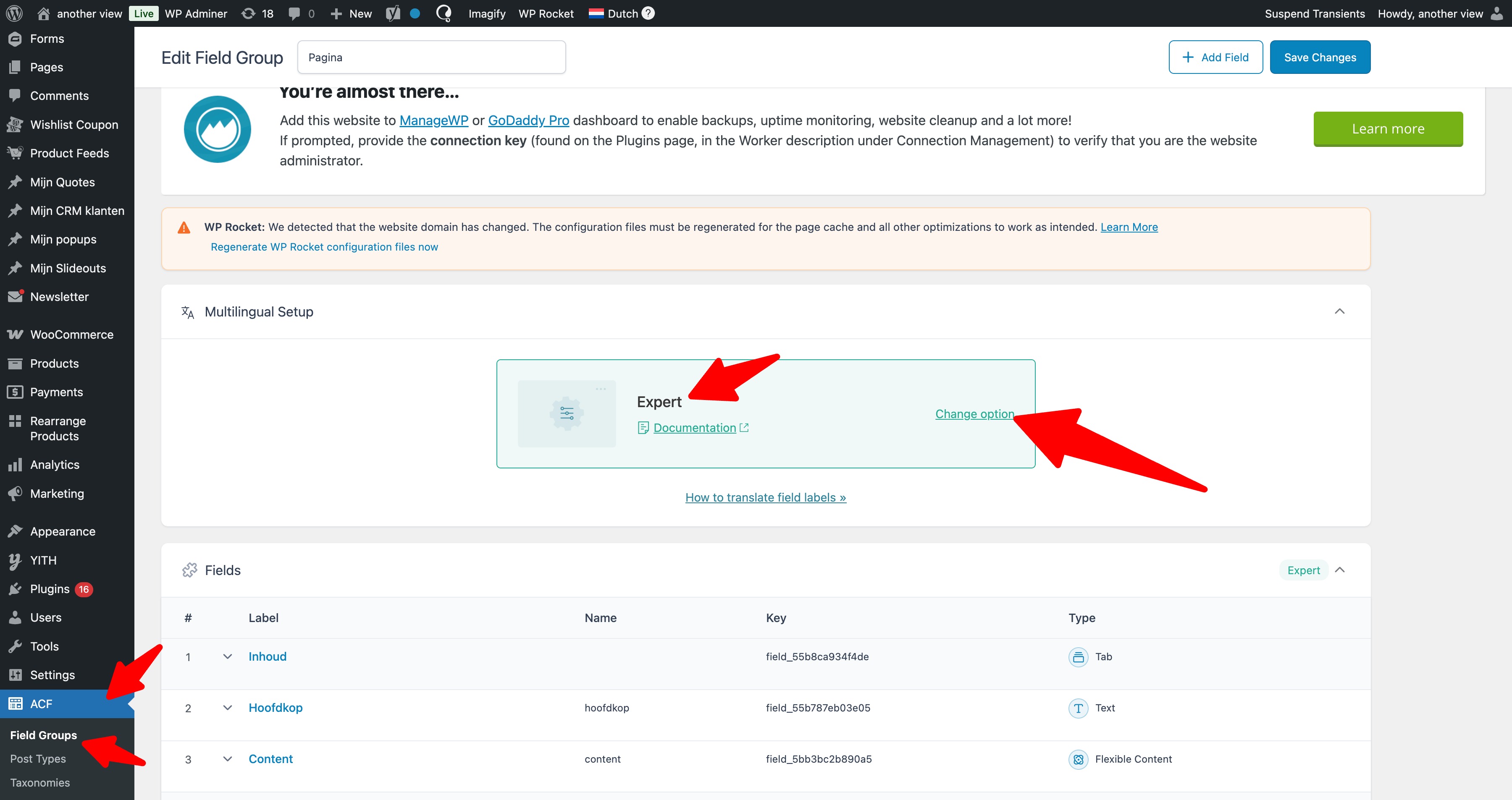

June 26, 2025 at 2:17 am #17171123
Shekhar Bhandari
WPML Supporter since 03/2015
Hello there,
- Go to ACF->Fields Groups
- Change the translations preference to Expert for this field group [Attached screenshot]
https://wpml.org/documentation/related-projects/translate-sites-built-with-acf/
Once this is done, for the flexible field set the translations method to copy.
Wich exact to delete once?
You will need to login to postmeta tables and delete the content field as we already did here: https://wpml.org/forums/topic/turn-off-automatic-translate-texts-strings-from-acf-field-group/#post-17153036
