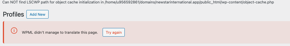

samaraL
I am now getting this error on my production site
June 30, 2025 at 9:46 am #17182748
Thanks for your reply. We are having issues with our translation server capacity and this will be fixed soon. I apologize for the delay.
