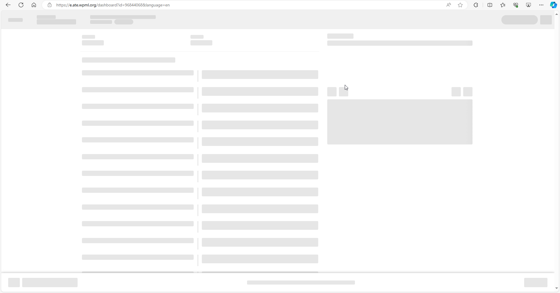

I'm trying to workout item 1 today but was unable to complete.
First I created 3 questions to replace the original questions in C7002 course.
However, when I click the translate button to translate these 3 questions, the screen freezed.
What should I do next?
2024-04-17 14_43_41-Question Bank ‹ P.L.A.I. Behaviour Consulting — WordPress and 8 more pages - Per.png

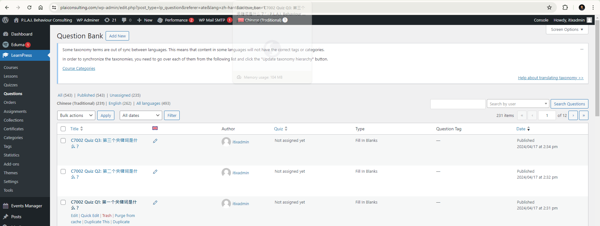

April 18, 2024 at 7:35 am #15535725
stephenH-20
I created 3 new fill in the blank questions and tried to translate them.
Again the Chinese version shows a True/False instead of fill in the blank. Even if I clicked "Copy content from English", still same.
