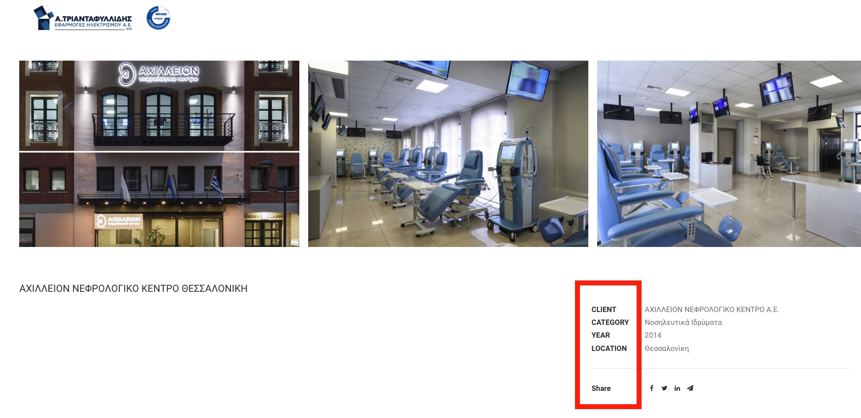

I've checked your Website and may I know why are you translating the "Custom Field" names? When I checked your translated portfolio here hidden link , it looks fine. Are you trying to translate these words as shown in the attached screenshot?
If not, please highlight it using a screenshot of what you're having difficulties trying to translate and I'll do my best to assist you further with this.
Thanks!

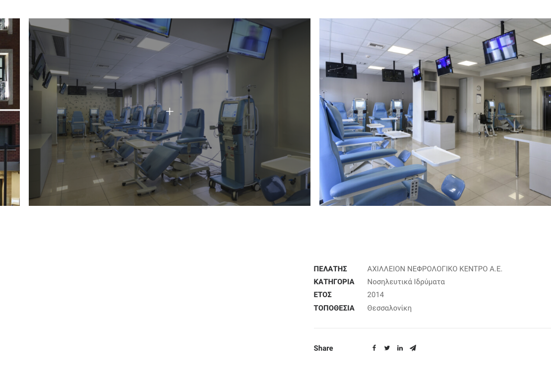

April 13, 2022 at 12:21 pm #11013109
nikosS-6
Hi Kor,
yes i want to translate the words marked in your screenshot except the word "Share".

April 14, 2022 at 2:34 pm #11022721
WPML Supporter since 08/2022
Thanks for your patience.
I've fixed the issue you had there and this is what I've done.
1. I've added the string "CLIENT, CATEGORY, YEAR, and LOCATION" in "Admin Texts Translation" here hidden link .
2. Then, I translated the string "CLIENT, CATEGORY, YEAR, and LOCATION" in "String Translation" here hidden link .
3. Once you've done that, I've added this XML configuration code below into WPML > Settings > Custom XML Configuration
