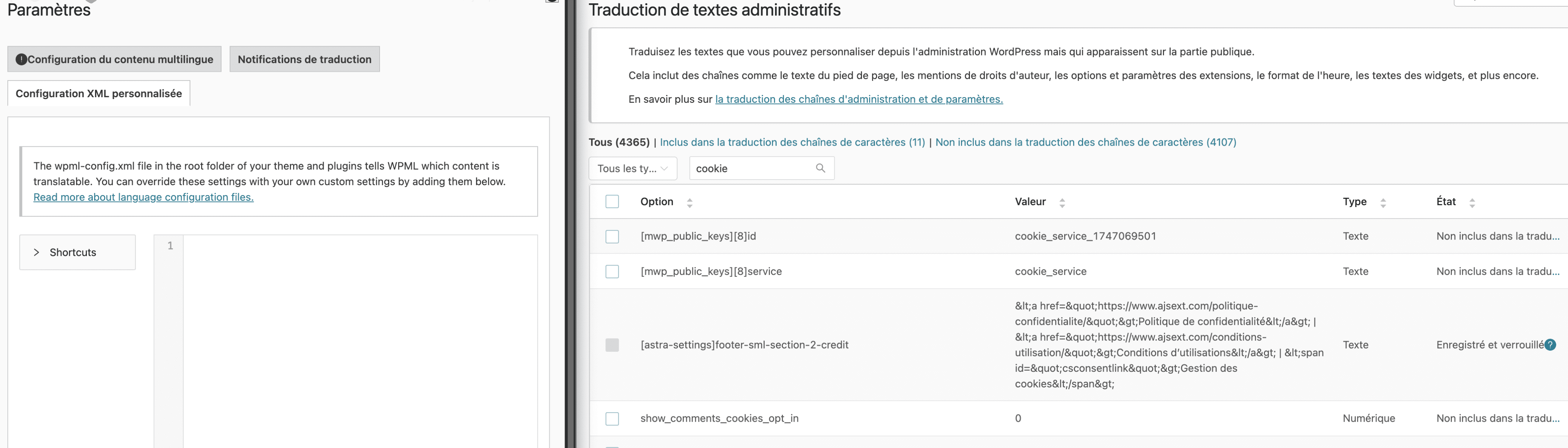

I am trying to unlock the translation of some admin text that was translated in the past. I updated the text in French but can't update the translation in English. The text is the Astra footer text. I can update the first part 'footer-sml-section' in string translation, but not the 'footer-sml-section-2-credit'.
I am unable to update the translation of the 'footer-sml-section-2-credit' in English after updating the text in French.
How can I unlock the translation of admin text that was previously translated?
Why can't I update the translation for 'footer-sml-section-2-credit'?

Hi there!
I was able to solve the issue.
The issue was due to a database corruption, possibly during a migration. Some strings in the icl_strings table had the columns string_package_id and location set to 0 instead of NULL. Changing these values to NULL made the strings translatable in the String Translation section.
So please do the following:
- access your database
- on the table icl_strings search for admin_texts_astra-settings, and you will see that some of them have string_package_id and location set to 0,
- change it to NULL
- now you will be able to translate it from WPML --> String translation
Please let me know if you have any problem.
June 11, 2025 at 5:41 pm #17127466
jonathanF-3
Yes it worked! Thank you!
