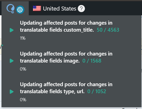

I am trying to update our plugins, specifically WPML from version 4.7.6 to 4.8.4 and String Translations from version 3.3.3 to 3.4.1. The issue can be seen at hidden link.
The process of updating affected posts for changes in translatable fields is stuck on the "custom_title" custom_field. The first batches ran fine, but this one is now stuck at 50 entries for 20 minutes. and retrys are stuck at 7.
Why is the update process stuck on the custom_title field?
How can I resolve the issue of the update process being stuck?

When it came to this one, though, it first had the "play" pictogram, but didn't progress further than 50. I noticed the retry_count was 7 in the database.
Then I ran the fixes sugggested by the bot.
And when I checked again, the retry_count had raised to 10, and the pictogram moved to pause while the count was still 50.
It didn't progress since.
Should I try to run the "optimize translation table" troubleshooting option?
What is the meaning of these pictograms?

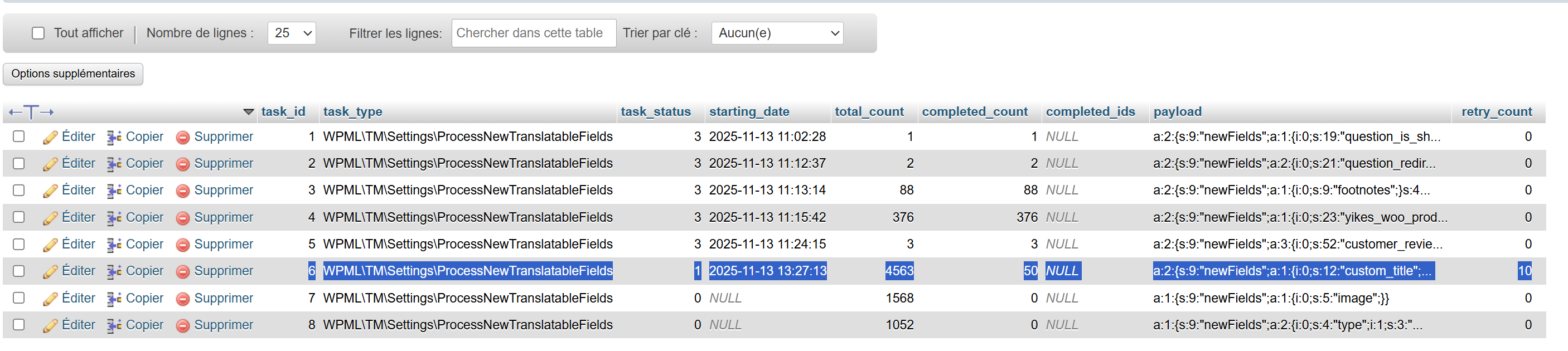

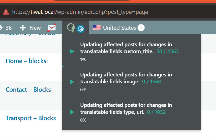

I added some php settings to my local environment, based on the setup of the stating environments, where the updates went fine. Unfortunately, it didn't help: I'm still stuck at the same state.
Since on our staging environment, and on another local development environmentn, the updates went fine, we thought the issue only occured on my local environment , so decided to go live.
Unfortunately... The updates got stuck on the live environment as well. At the exact same step.
Can you please provide us with clear explanations regarding this process:
- What is it supposed to do? "Updating affected posts for changes in translatable fields" is very generic.
- Is it required to complet these updates before working on the website again?
- Are we supposed to clear the WPML caches, or process other further troubleshooting options, before, during or after (if they finally complete) these custom fields data updates?
- What the "attempts", counted in the database, correspond to (meaning what ends an attemps, and creates another)?
- One thing we noticed is that my local environment has this step "paused" (pause pictogram), while the live is stuck at the exact same stem and is in the "active" state, (play pictogram) for over two hours now. We obviously have no action as a user, so what manages this state?
