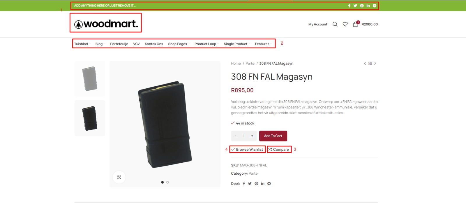

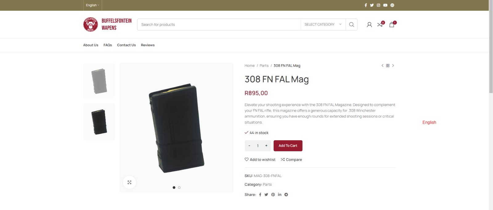

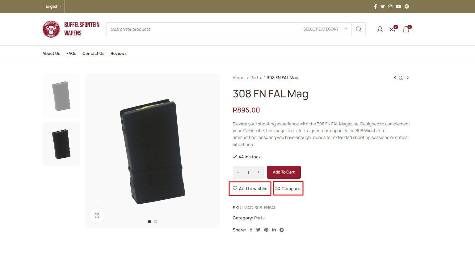

Hi We made the header using theme header builder. also we translated as mentioned as on doc. We already translated everything but many bugs are coming. Theme default header is coming. Wishlist & Compare is working fine on English one but now it is also not working. please check

Default Header in Single Product page: This issue was happening due to not updating the Header ID for the African language in String Translation. I've updated the ID under "admin_texts_xts-woodmart-options" text domain and that fixes the issue.
Compare and Wishlist not working: The pages for compare and wishlist wasn't selected in Woodmart Shop settings. For that reason, the Add to Wishlist and Compare feature wasn't working. The issue gets resolved upon selecting the pages.

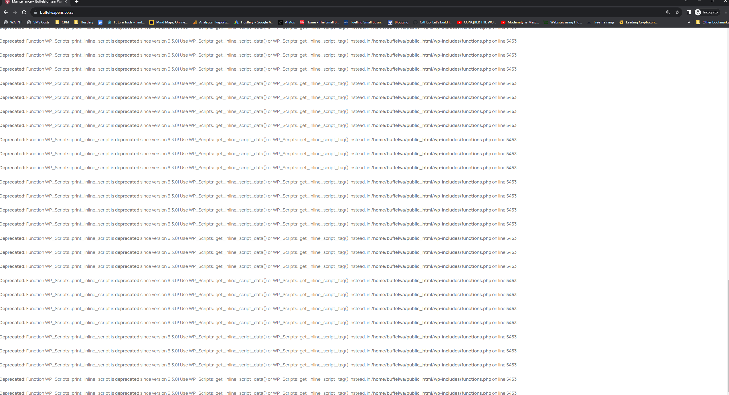

Please help me, as per the screenshot, the website now shows these messages.

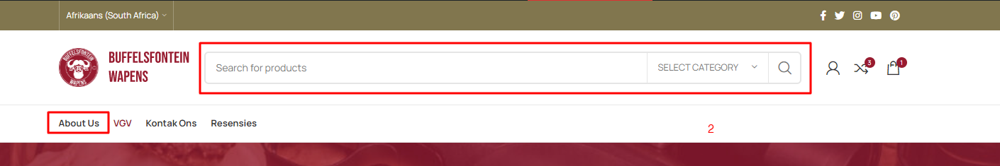

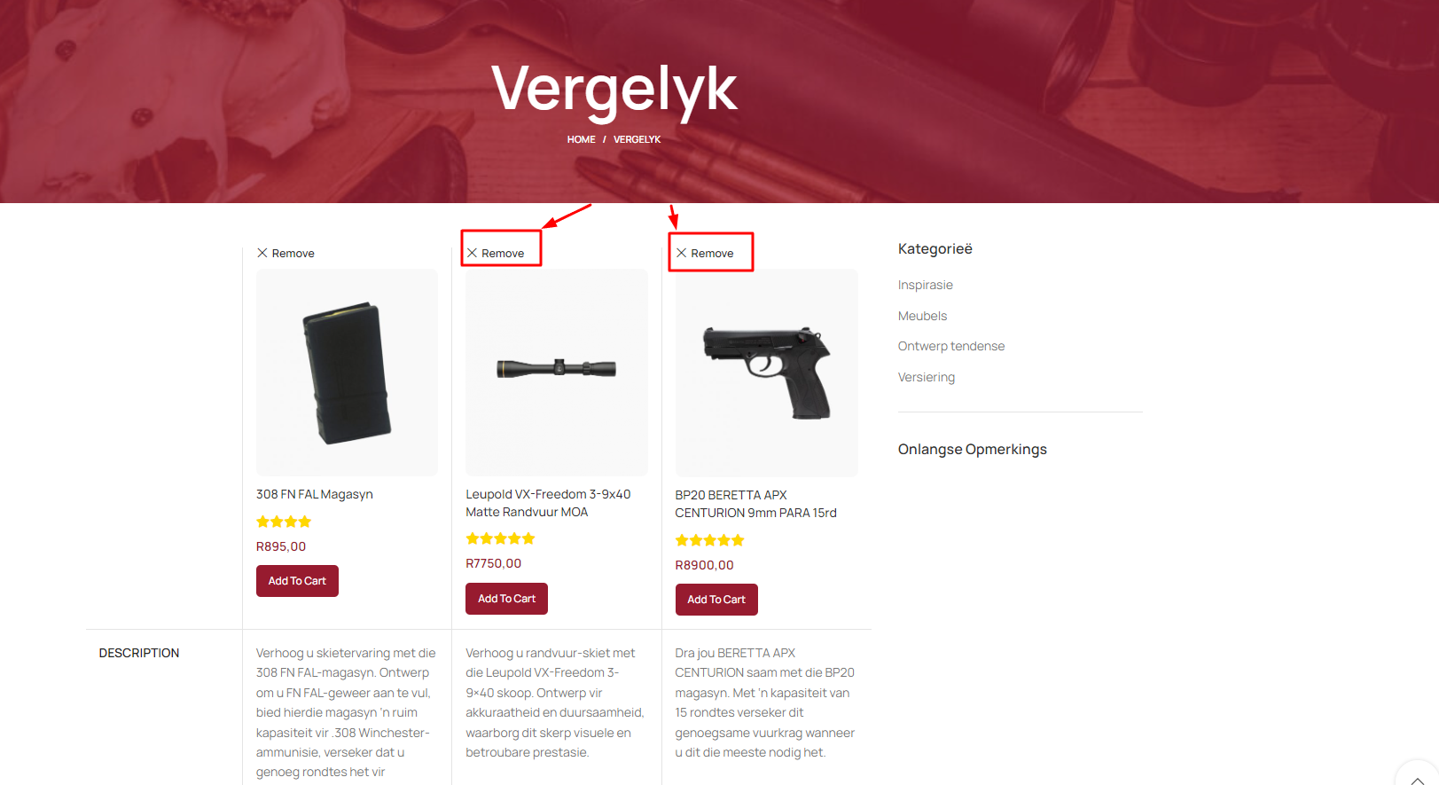

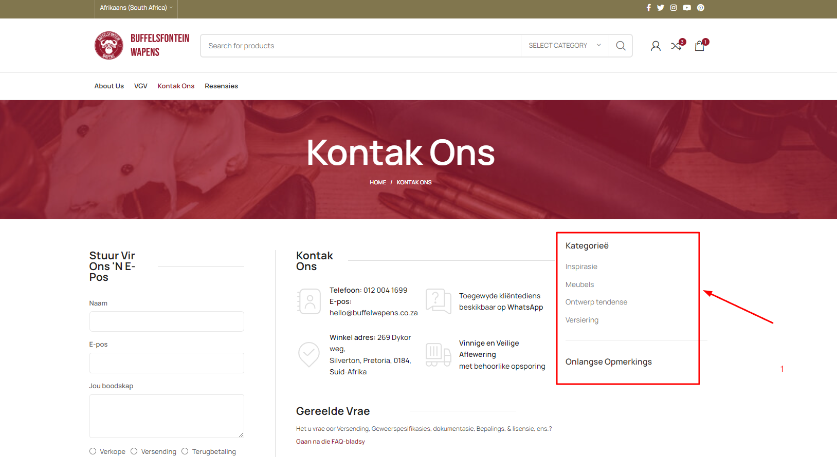

Hi there, Above message is hide. but I found some more bugs. 1. why this content coming on about us pages this is only coming on Afrikaans site. 2. How to translate this following text. 3. this button is not working

1. The sidebar that appeared on the contact page has been removed now. The settings for the sidebar applied on the default page have not been copied to the translated page somehow. I manually made the changes and that fixes the issue. Please check this screenshot(hidden link) to understand the changes that I've made.
2. The name of the "About us" page has not been translated into the African language which is why, the name appears exactly as the name defined for the English page. Please change the African version of the "About Us" page to see the correct name.
To translate the other texts that you've marked, please go to "WPML > String Translation" and search for those texts. You will be able to translate the text from there.
3. As you've mentioned that the Remove button is not working, would you please check what happens if you keep the WPML plugin deactivated? If the issue persists even after that, you should discuss this matter with the theme author or support. I hope they will guide you in solving the issue.
But, if the issue gets resolved after deactivating the WPML plugin, please let me know. I will take a closer look and try my best to solve the issue.

Translating the menu "About us": To see the About us menu translated, Please follow these steps.
- Switch to the African language from the language switcher appears on the top bar of the Admin panel
- Go to Pages > All Pages section.
- Find the "About Us" page
- Click on the "Quick edit" button and add the African translation of "About us"
- Save the changes.
`Search Bar` and the `Shopping Cart` translation: If you're unable to locate a particular string in String Translation, you should conduct a scan within the theme or plugin to which that specific word belongs or search in the Admin screen section. I kindly request you to follow the instructions mentioned in the guide below.
