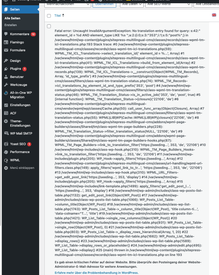

I'm encountering a fatal error on my website related to the WPML plugin. The error message is as follows:
Fatal error: Uncaught InvalidArgumentException: No translation entry found for query: s:42:" element_id = %d AND element_type LIKE %s ";a:2:{i:0;s:3:"353";i:1;s:5:"post%";} in /var/www/html/wp-content/plugins/sitepress-multilingual-cms/classes/records/class-wpml-tm-icl-translations.php:193

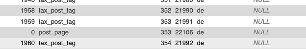

This kind of fatal error most of the time happens due to a corrupted database or a migration that wasn't completed properly. Based on one of your screenshots, I noticed that the `translation_id` for the "post_page" element[Element_id: 353] in the "_icl_translations" table is set to '0' [ Screenshot: hidden link ]. This appears to be the primary source of the problem.

SELECT * FROM `wp_icl_translations` WHERE `element_id`= 353 AND `element_type` LIKE 'post%'
- Check the records. If any record displays a "translation_id" of '0', please delete that specific record.
