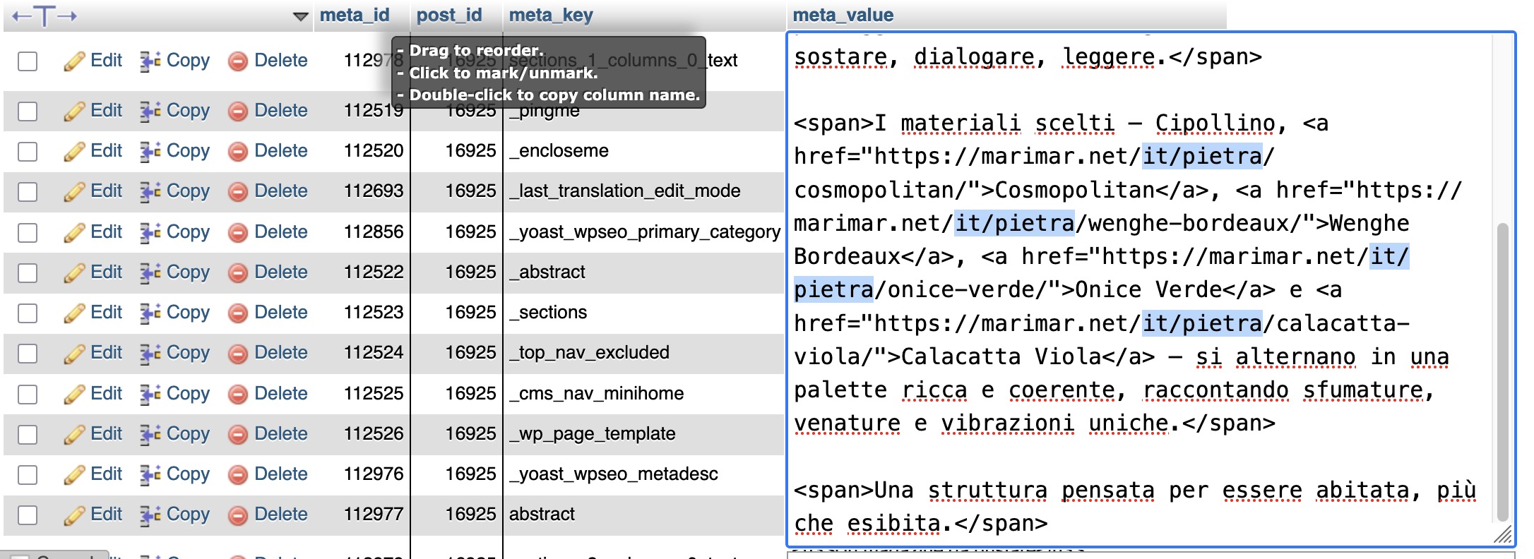

I set up the default WP post to use WYSIWYG fields within a flexible content container to display custom text, which may eventually contain some inner URLs. I want to handle all URLs in all languages by myself. The issue can be seen on this page: hidden link

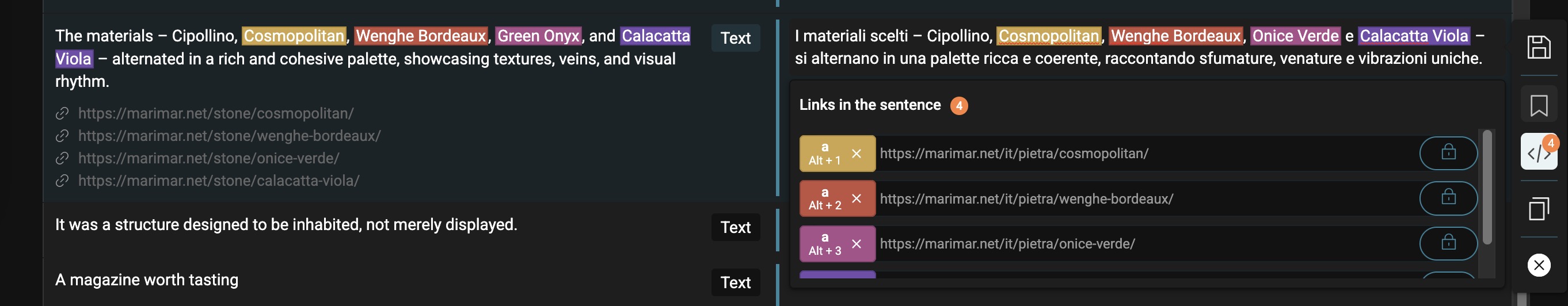

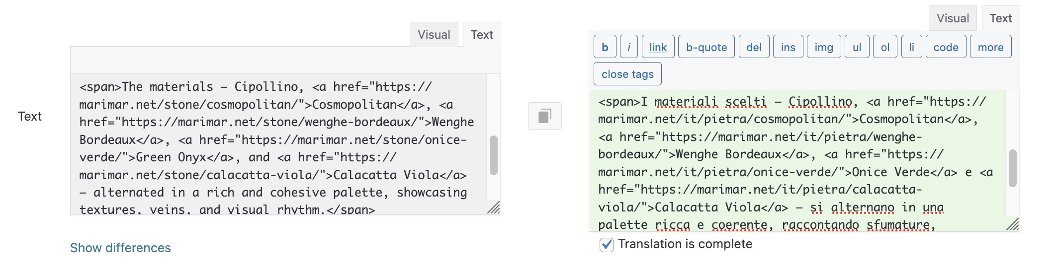

I tried editing the translantion in the actual translation editor, in the old translation editor and even in the wordpress editor.

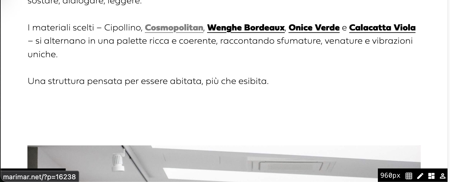

The hrefs are not the same as I insert and are overwritten by the ?p=ID query referring to the main language post.
How can I ensure that the hrefs reflect what I insert in the translation?
Why are the hrefs being overwritten by the ?p=ID query?

The "?p=ID" at the end of the URL in WordPress usually means that the content you are linking to is not yet published and still saved as a draft.
Could this be the reason?
If you publish the pages, you can use WPML > Settings > Translate Link Targets to adjust any internal links.
As an alternative, publish the pages and update the translation of the page with the WPML Translation Editor.

As stressed in provided screenshots I'm able to insert correct values and they are correctly stored in the DB (new attach here...).
Then, when the ACF value is fetched via get_field() the expected string is not there.
I'm able to put an outer link in there (say google...) but if i leave it untouched (which I expect should result in the automatic translation....) or i force it myself to use the correct translation URL then the link breaks.
