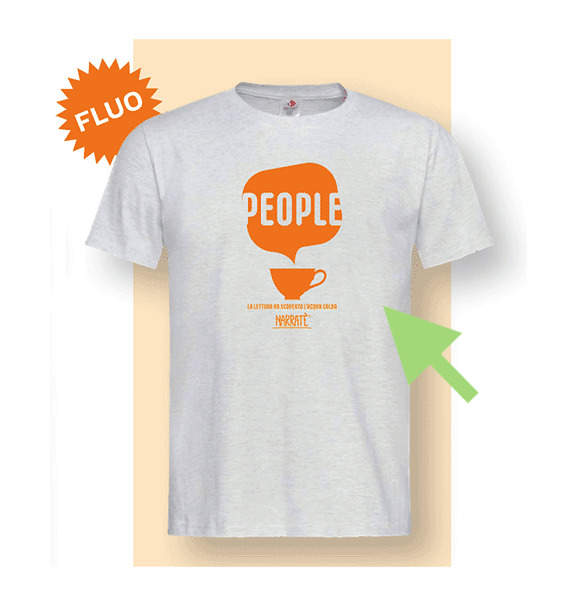

A standard product have one Main Product image (that in the screenshot you can distinguish because of a small green arrow) and also gallery images (a yellow t-shirt and a red card).

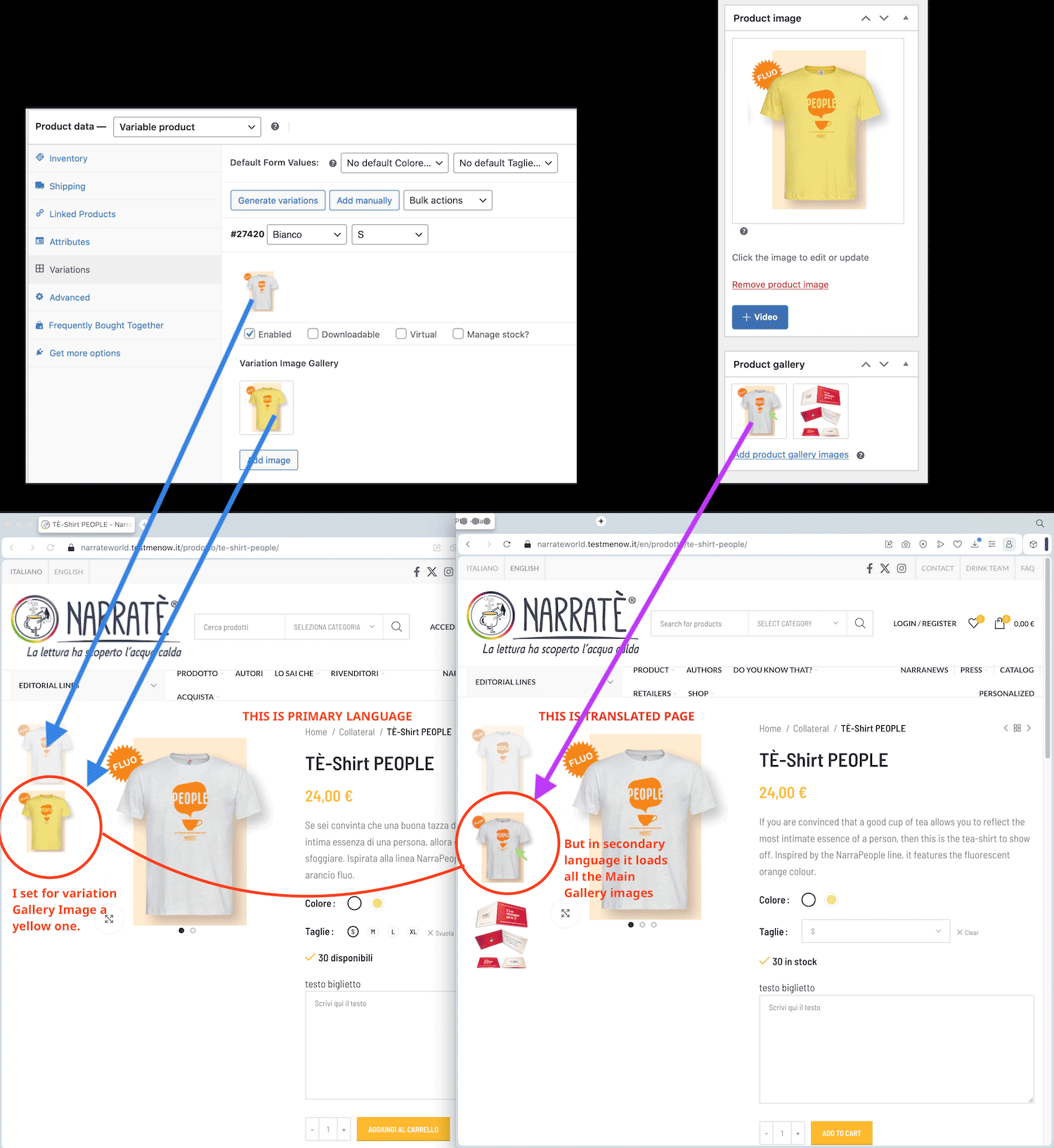

When you create a variable product you can also set an image for every Variation and one or moregallery images (please have a look to screenshot - bue arrows).
Now after creating a product in primary language, I translate them with Woocommerce->Woocomemrce multilingual. I get a good translation, BUT the 'variation gallery images' (blue arrows in the screenshot) are missing, so the Main gallery images (purple arrows) are provided instead of the Variation gallery image in the translated product
So it seems that WPML for some reasons doesn't replicate in the translated product the variation gallery images. So Woocommerce replace it with the Product Main gallery images (as it usually do if you don't set any Variation Gallery Images)
I know that my explanation is difficult and complex, but the issue is quite simple: the Gallery images of the Variation items are lost.

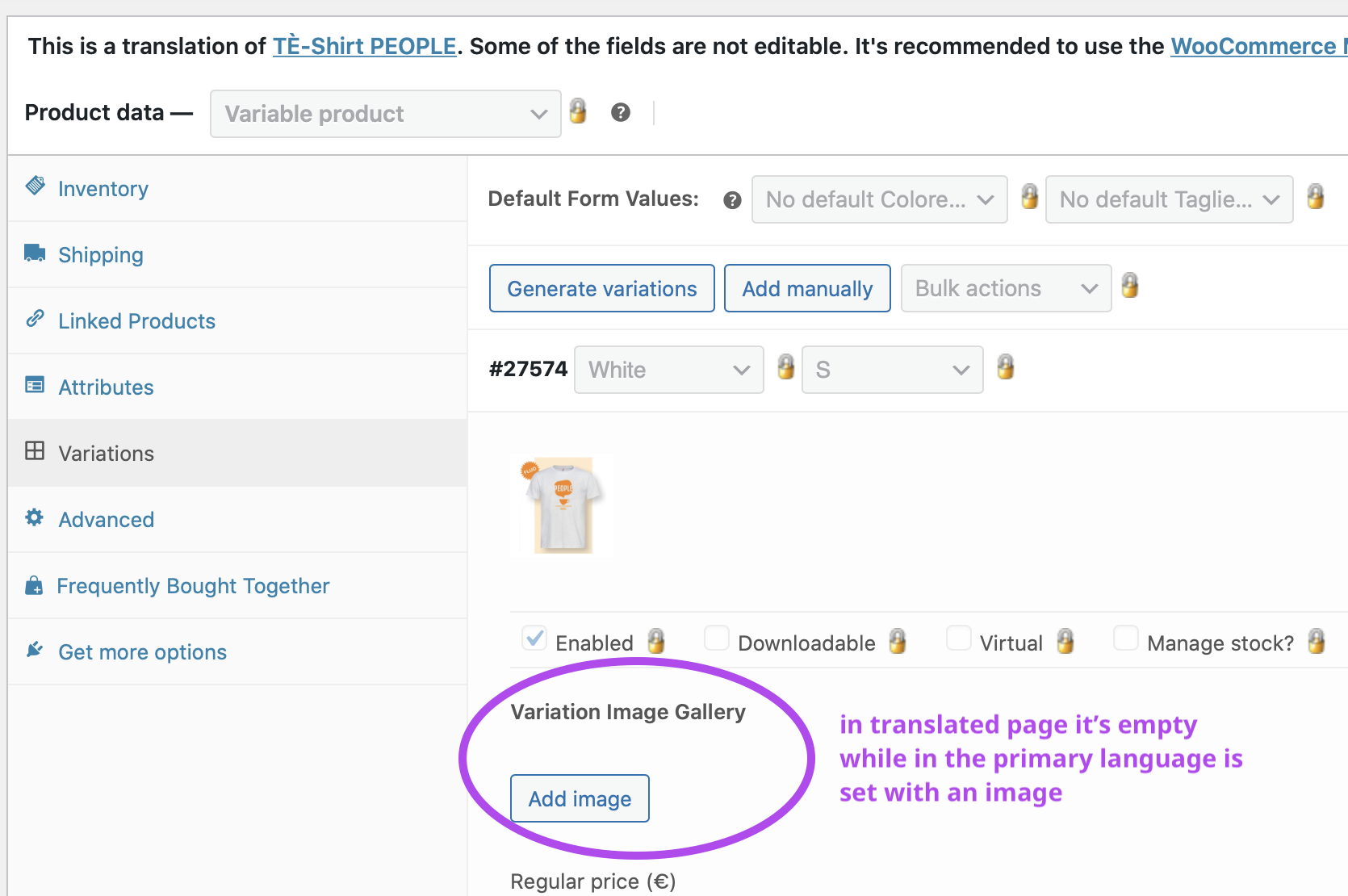

Looking better in Secondary language Product page editor, I can see in fact that Variation Image Gallery is empty (while in the primary product an image was selected). But all the fields are locked, so I can't add images from here.
It is possible that I have to set something in WPML setting to add Variation Image Gallery to the translatable fields?

thanks for you last indication: I do what you suggested. With Copy it doesn't work because when it opens the translation panel the Variation images don't appear, but if I set to Translate, they appear. Great solution.

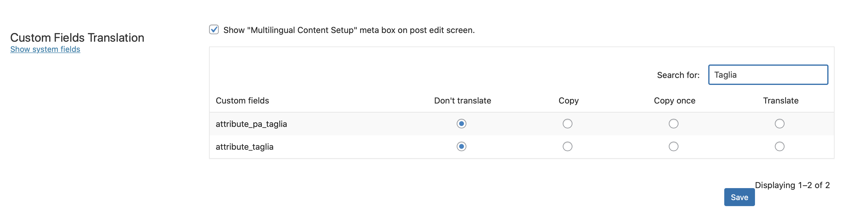

But by searching for pa_taglia it doesn't find nothing. I can find, searching for 'Taglia', (but in Custom Field Translation, not in Terms): 'attribute_pa_taglia'. (attached image)
Before doing something wrong, could you please tell me if it can be the right path to a solution and if so, how to proceed (copped, translate...and so on).
Many thanks!
We want to copy the Variation swatch settings to the translated attribute term, therefore, we will be updating the translation preference for the Terms only, not the custom field.

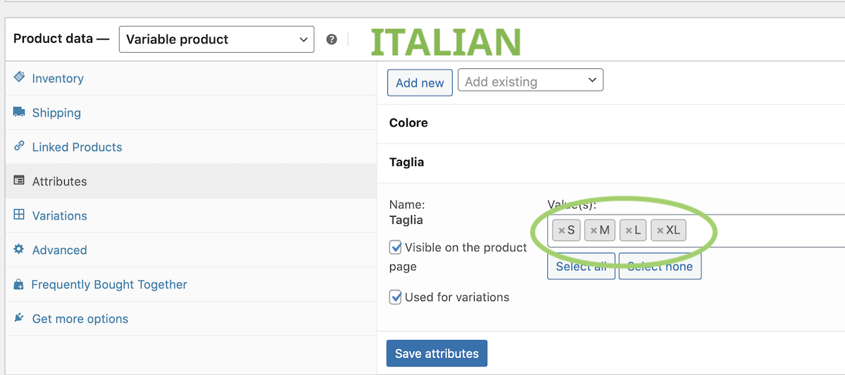

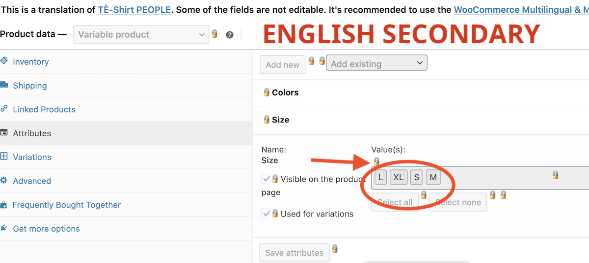

Really great. I've just to ask another minor thing If you look at size selector in main language (italian) you can see that sizes order: S-M-L-XL is not the same in secondary language (english) where is L-XL-S-M.
So I went to Product->english version of the product->attributes to put in order, but I found everything locked. So the first question is: is it the right way to change the order in the english product? Second question is: is it possible to unlock those attribute to put them in right order.
You can adjust the order of the Attribute terms by dragging them from the "Products > Attributes" section. To understand the process, please check this video: hidden link
I hope it will help. Please feel free to let me know if you need additional assistance in this matter. I will be happy to help.
