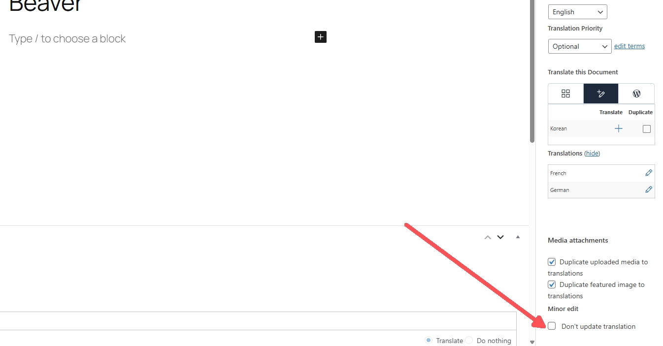

Following the review from our Tier 2 team, I’d like to confirm our understanding of the situation and make sure we are aligned.
If we understand correctly, the goal is not to prevent translations from consistently being marked as “needs update,” but rather to avoid having content retranslated even when the underlying logic and structure of the post have changed significantly.
For example, the post we reviewed was using the old (pre-Gutenberg) editor and was opening in the native editor. In this scenario, the original and translated posts appear to have simply been linked together, meaning they were never stored in the WPML String Translation memory, the Advanced Translation Editor memory, or the WPML translation job records.
Given this, to avoid being charged for automatic translation, the recommended approach would be to use the “minor edit” checkbox, then edit the translation directly using the native editor, and continue managing updates this way moving forward.
Could you please confirm whether this matches your understanding and expectations, or let us know if there is anything else we should be aware of or investigate further on our end?
