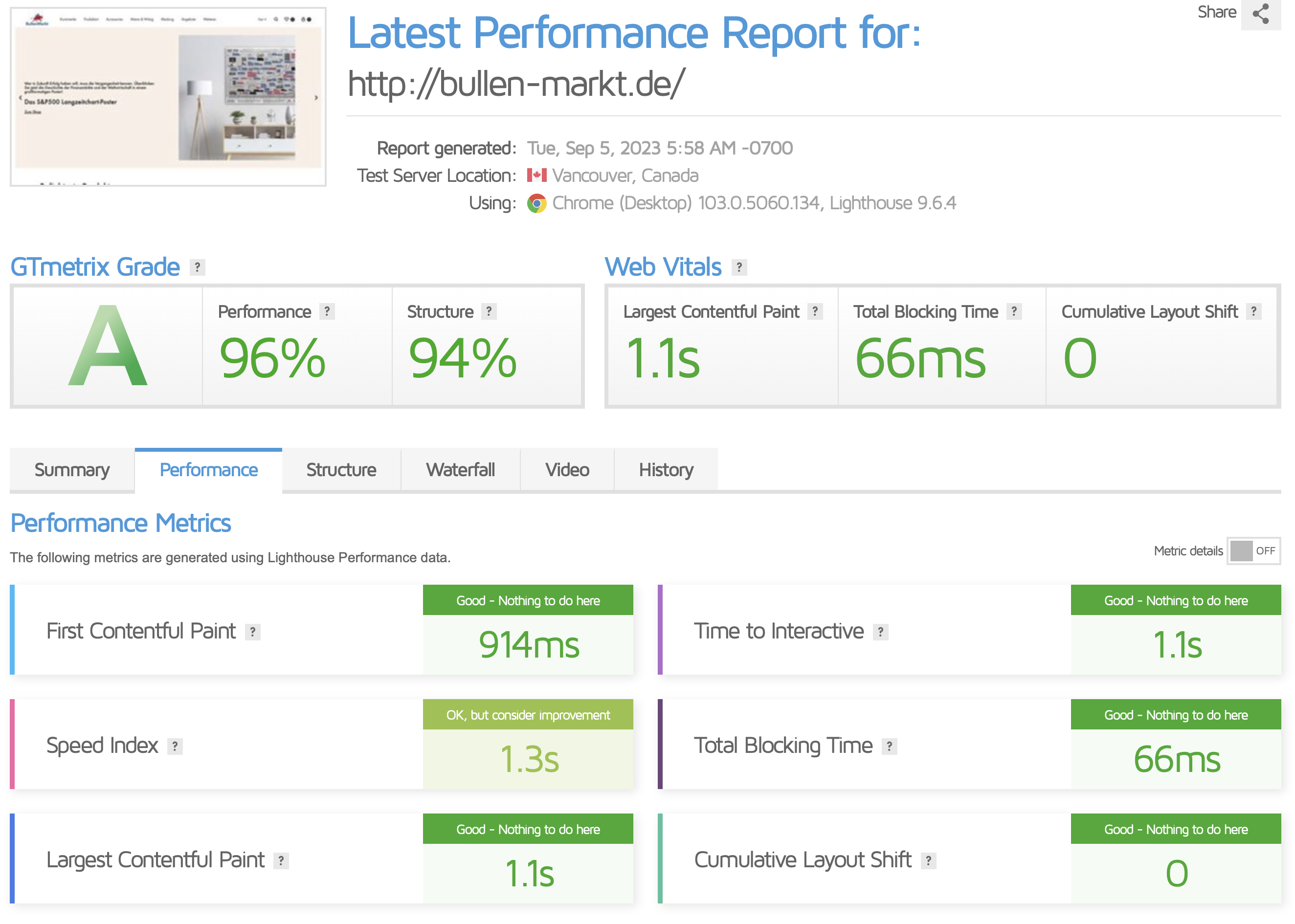

Since I installed WPML the site has suddenly become extremely slow.
This results in an extremely long “waiting time” in the “root document” of the individual pages. Which usually indicates bad code or incorrect PHP code.
The WPML plugins are all up to date.
The GT Metrix score fell from A to F. The screenshots were from the live site when I made the staging site live. The live site is now running again without WPML.
But the bad score still exists on staging.bullen-markt.de
Something is causing a conflict here.

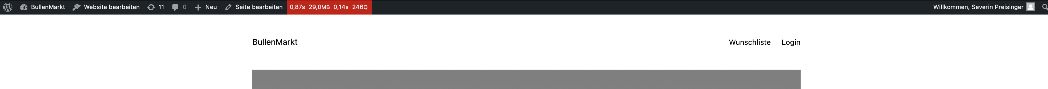

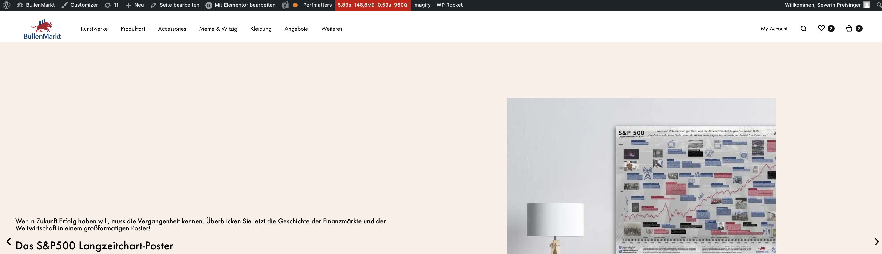

September 11, 2023 at 10:40 am #14375047
severinP-4
Hello Drazen,
thank you very much for the reply.
I don't think it's due to caching either.
Attached is the screenshot for your questions.
Seems like WPML is sending a large amount of additional requests.
Best Regards
Severin

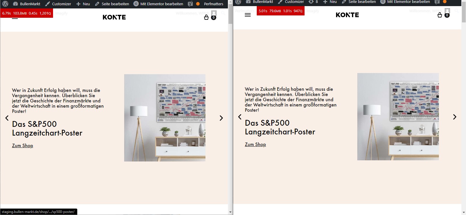

September 13, 2023 at 2:22 pm #14390783
severinP-4
Thank you very much for the adjustments!
If you simply access the frontend of the live page "bullen-markt.de" uncached and click through, you will see that this page usually only takes 1-2 seconds to load per page (every page). Does WPML really make the site that much slower?
The perceived loading time on the customer site in an uncached private window is suddenly much longer. Is WPML blocking the cache or not loading into it?
I made some comparison and the problem still remains:
Home page
Product page
There are also many more requests. Is it possible for example to delay or batch the requests of the different flags for the languages? But that's just a drop in the ocean and probably won't do much.
In particular, the uncompressed size of the website has increased significantly.
A conflict arises somewhere here, so that the waiting time increases so much. It is visible in GTmetrix data and if you visit the two websites directly uncached, the difference in performance is also clearly noticeable as human.
So how do we fix this?
And also my next question would be, if I'm not allowed to use code snippets and a child theme, how should I implement the customization?
