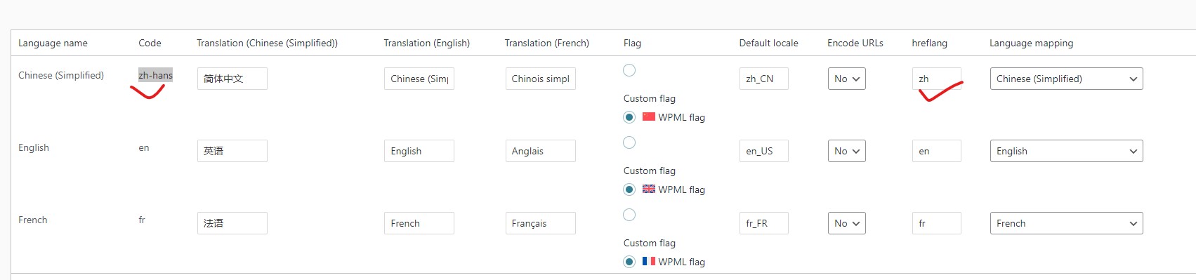

I followed your instructions exactly. When adding Chinese language I stated hreflang = "zn" and Code = "zh-hans" intentionally making them different as at my website.

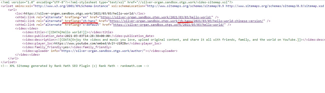

And after adding video post at Chinese I can see that there is the same error. At video sitemap hreflang is taken not form language hreflang but from Code.

Thanks for replicating the issue. It seems the Video Sitemap is using the language code instead of the hreflang value across all languages. I tried updating the hreflang for English and French, but the sitemap still uses the code.
