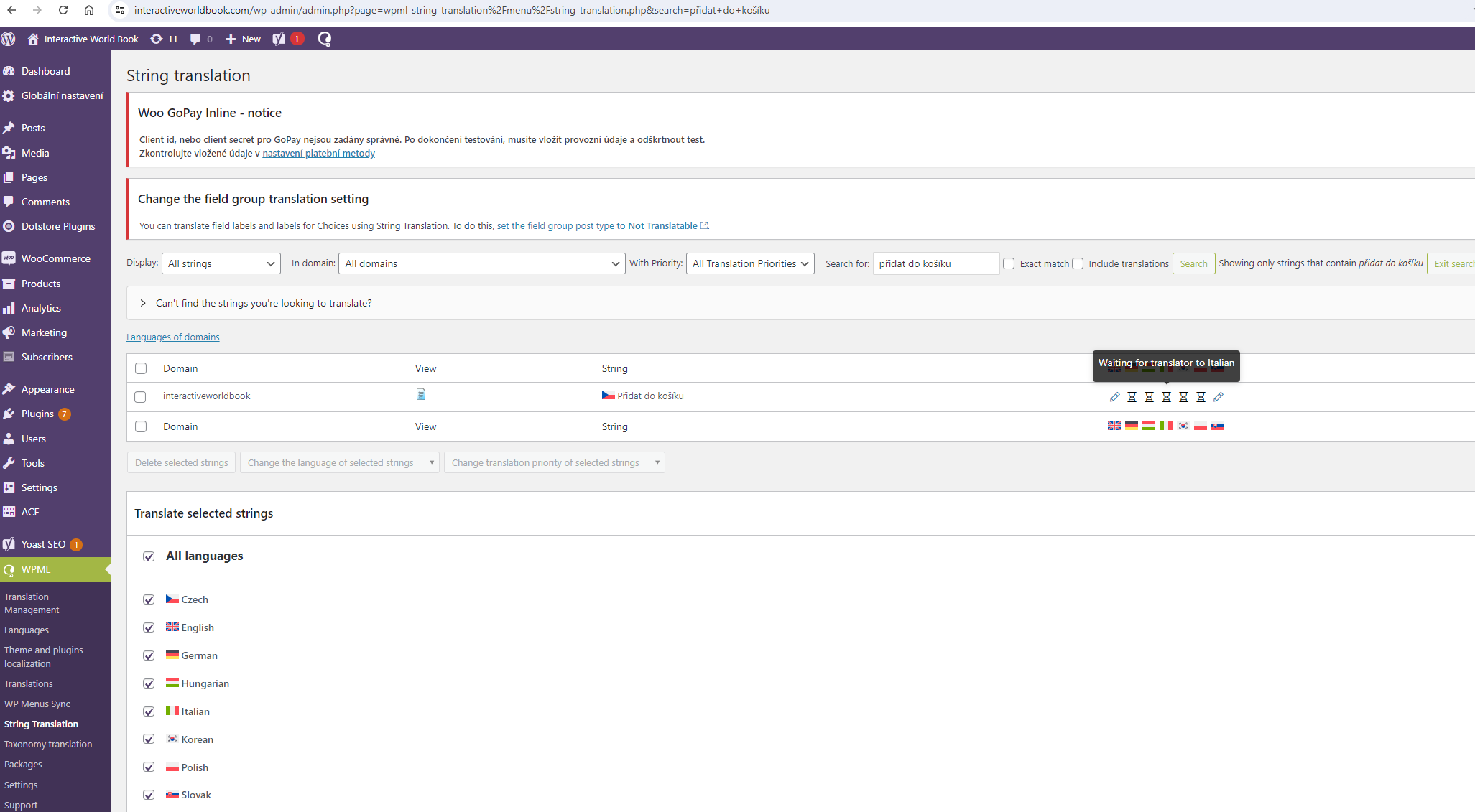

I need to translate individual strings on my site hidden link using WPML. I don't need a translator; I just want to manually edit the strings by clicking on the pencil icon and writing the word that should be there. I tried to solve this issue by following a problem I found on https://wpml.org/forums/topic/i-keep-getting-waiting-for-translator-message-all-the-time/. I don't have these strings selected for translation in 'Jobs', so I can't cancel the 'waiting for translator'. I don't see the 'translation basket' tab, which indicates that nothing is selected for translation, but the strings are still in the 'waiting for translator' state. I have spent a lot of time on this and need to solve this problem so that all strings on the site can be translated manually.
All the strings I need to translate are stuck on 'Waiting for translator'.
How can I manually translate strings that are stuck on 'Waiting for translator'?
How can I cancel the 'waiting for translator' status if the strings are not selected in 'Jobs' or "Basket"?

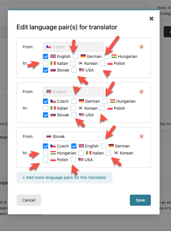

I think the main issue here is that you don't have the other languages assigned to your current user:
Go on that link and click the pencil round blue button and make sure that you add the other languages to your user, too.
After you assign all the languages, please go here (hidden link) > filter by "strings" and then see if you can see the other translation jobs.
At the moment, you can't see them or change anything because those other languages are not added to your user. You have only Czech - English and English - Czech
