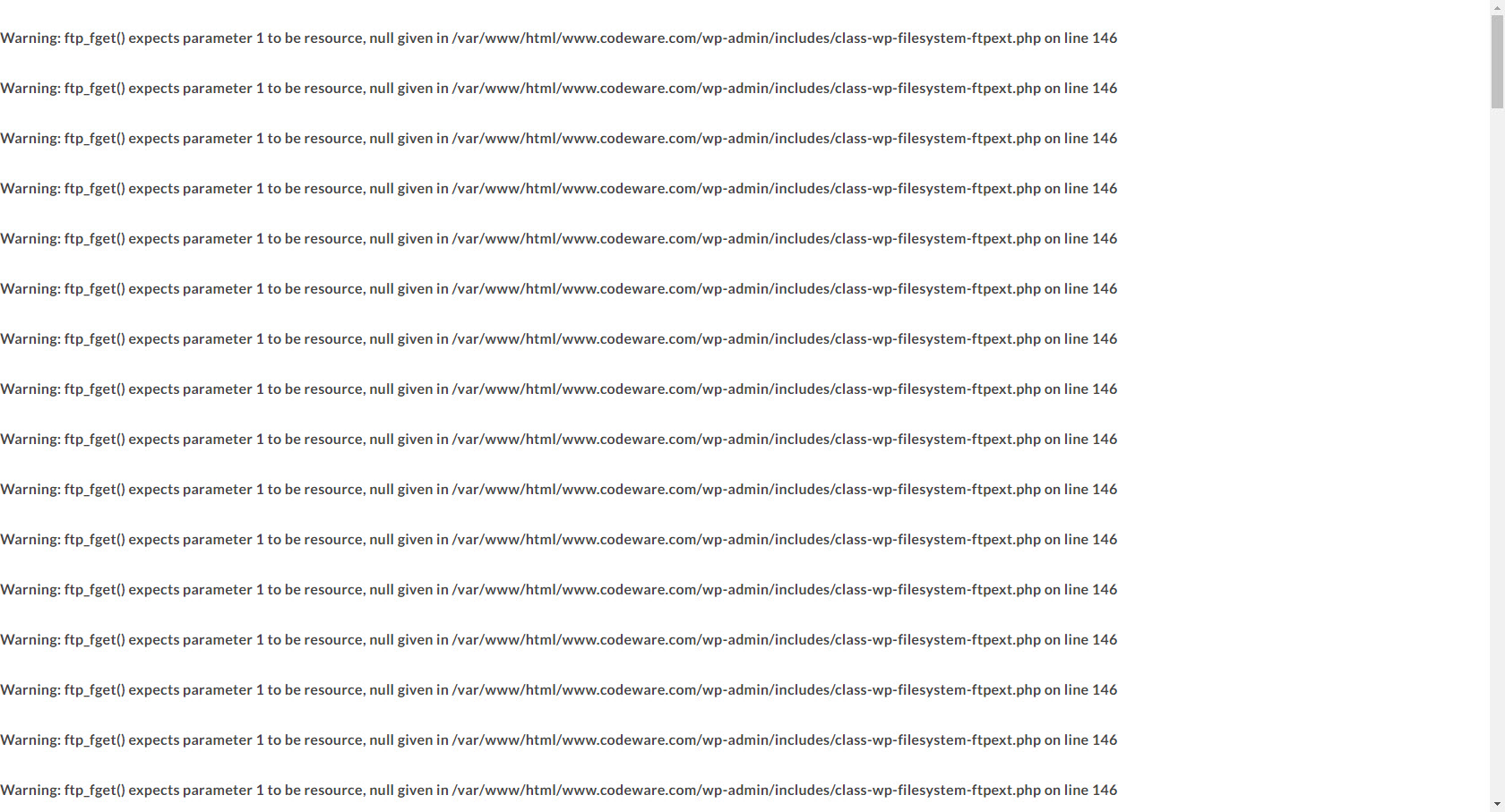

I just purchased WPML and I get the following error only when the 'WPML String Translation' plugin is activated.
Warning: ftp_fget() expects parameter 1 to be resource, null given in /wp-admin/includes/class-wp-filesystem-ftpext.php on line 146
Warning: ftp_mkdir() expects parameter 1 to be resource, null given in /wp-admin/includes/class-wp-filesystem-ftpext.php on line 560
When I deactivate the 'WPML String Translation' plugin the error goes away.
This error will occur on the published website and also when I edit a webpage within WordPress. Any ideas what is causing this? I literally just installed WPML and I'm using the Avada WordPress theme which is said to be 100% compatible.
**EDIT**
I resolved the first error by increasing the Memory Limit to 256M. I am still getting the second error:
I found the solution to the issue. The owner of the core wordpress files was set to my personal user. I changed this permission to be apache and everything seems to be working.

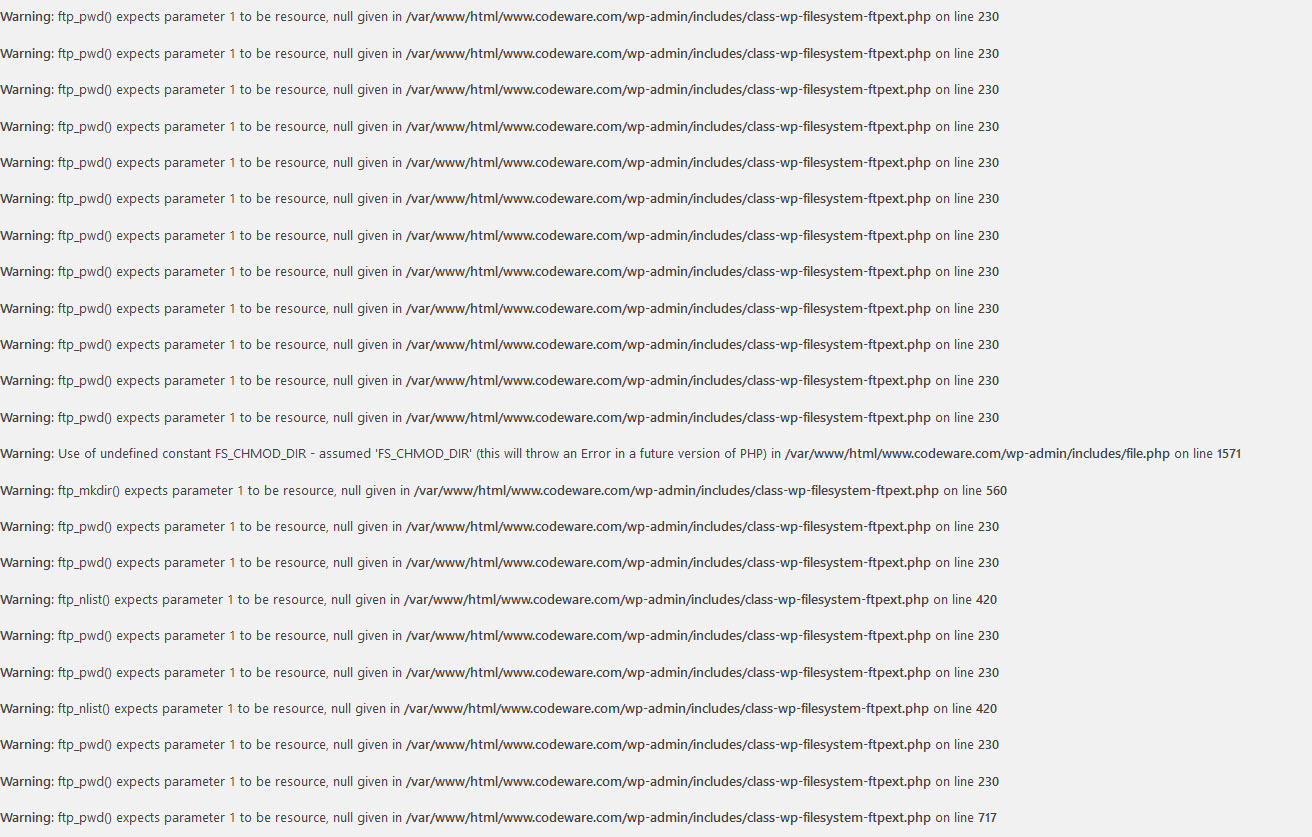

February 5, 2021 at 5:25 pm #8019099
paulD-46
Mateus,
Thank you for the reply. I already had all other plugins disabled, with the exception of Avada Core and Avada Builder. Avada theme says it is 100% compatible with WPML.
I tried switching to the 2021 theme and I am not receiving any errors when WPML is active.
When disabling all WPML plugins, my Avada theme is working perfectly fine, but the moment I enable it I get several errors on back-end of website and also on front-end.
It almost seems like Avada isn't 100% compatible. I am using Avada v7.2.1, which is the newest version available. Maybe it's an issue with Avada?
Attached is a new image of the errors I receive when editing a page from within WordPress. This is with the Avada theme active and only the WPML plugins active (along with Avada Core and Builder).
Please let me know if there is anything I can do to resolve, otherwise I'm gonna have to scrap this plugin and give Polylang a try.

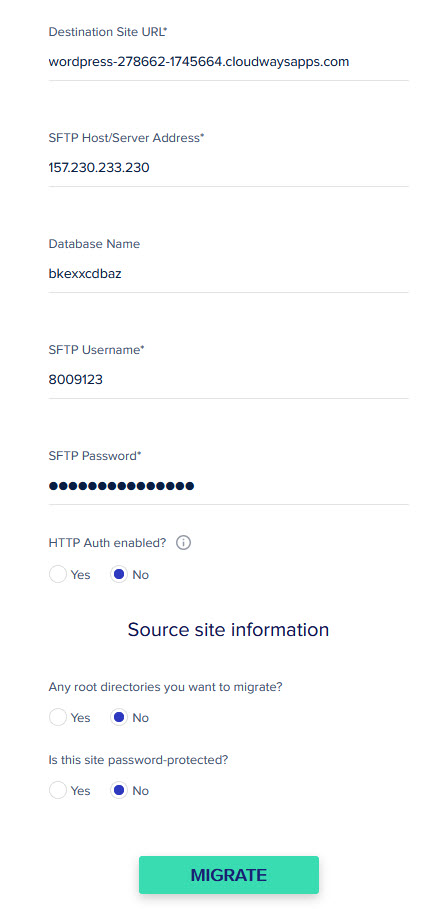

February 5, 2021 at 6:54 pm #8019423
paulD-46
Hi Mateus,
Thank you for the quick reply. I followed the steps to migrate the site to Cloudways be get the following message: "We are unable to contact the source site. Due to this the migration cannot be completed."
I tried 3 different times and double-checked the authentication.
