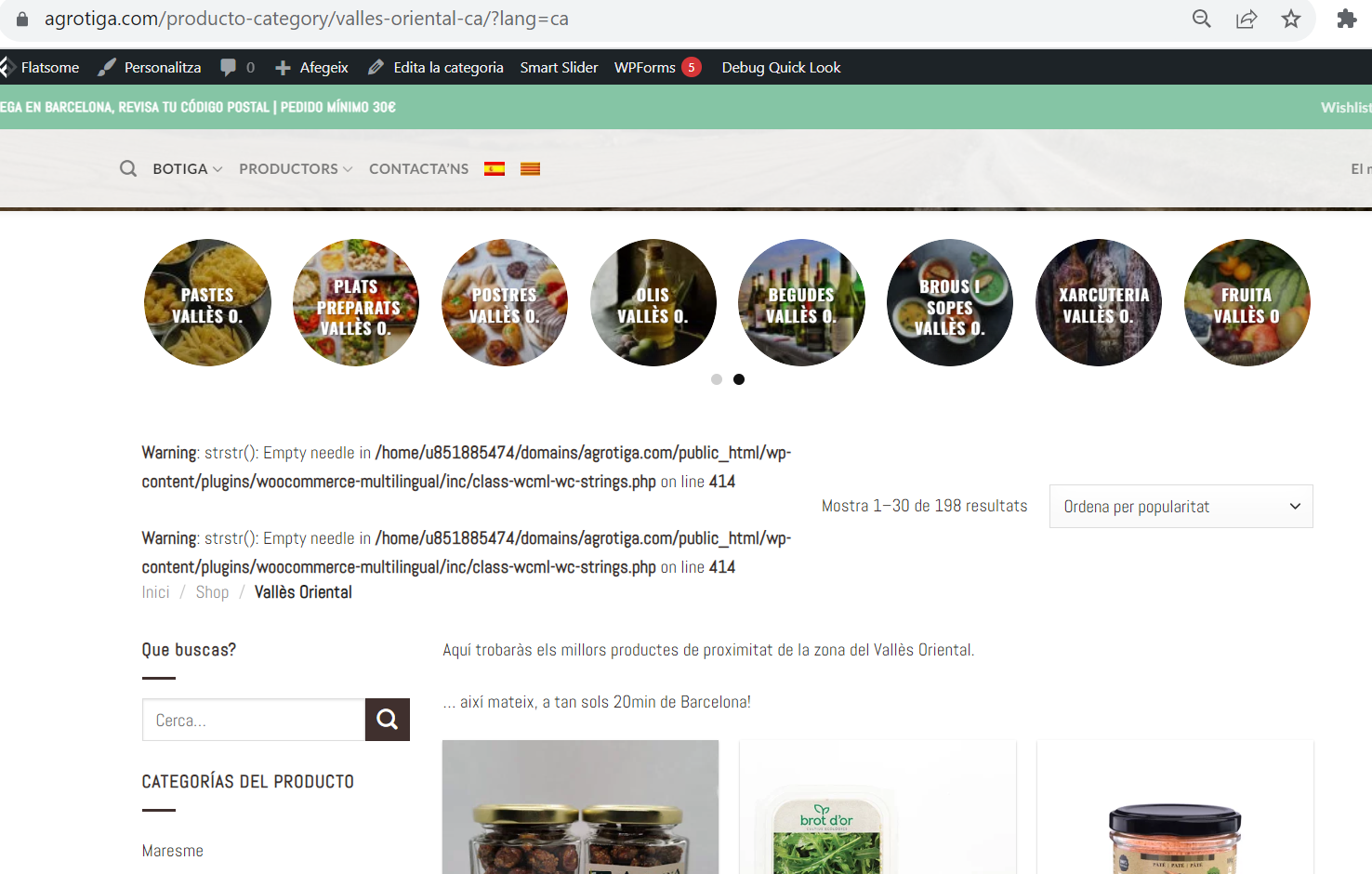

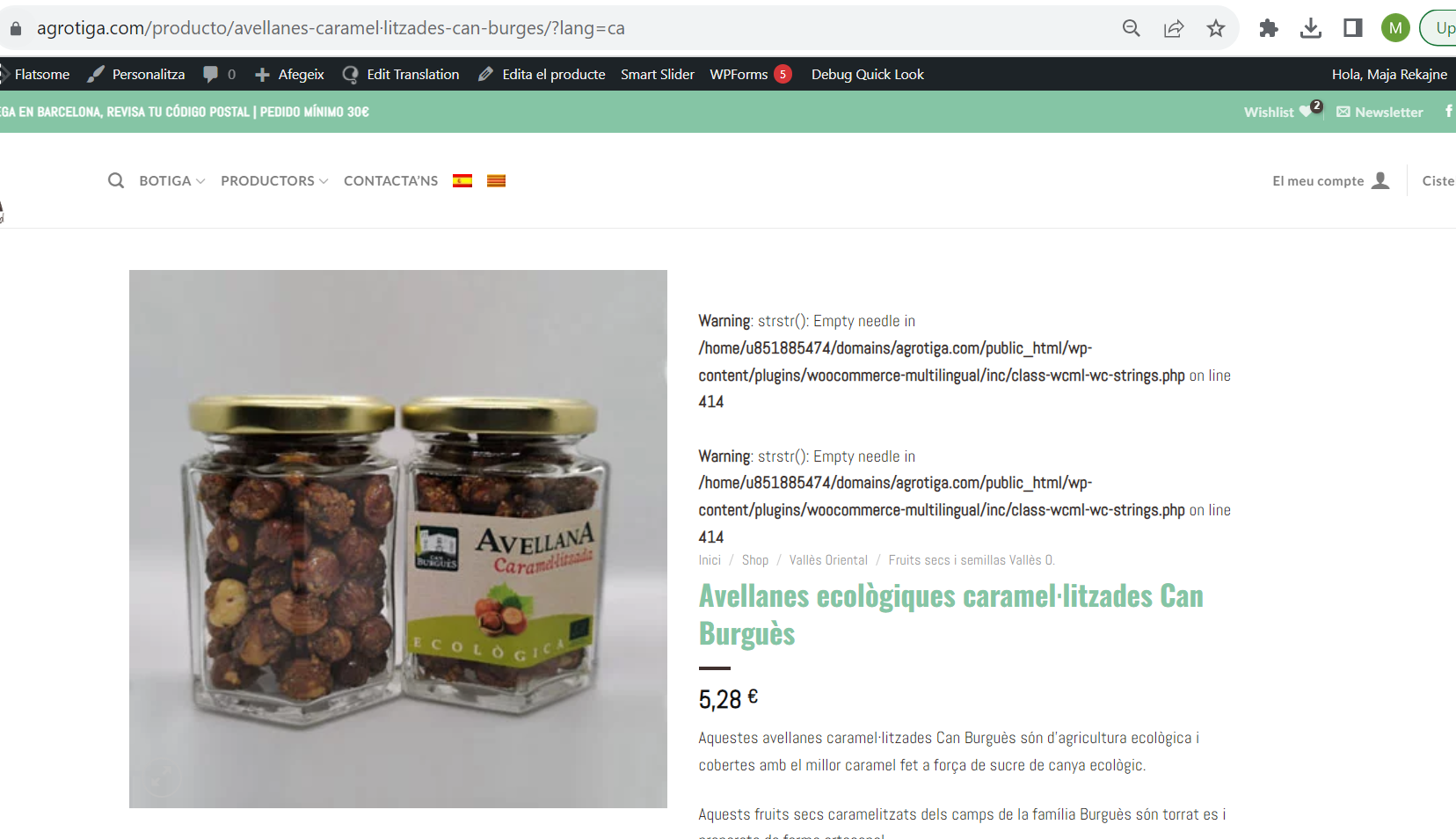

Hello, can you please help us solve the bellow issue.
Warning: strstr(): Empty needle in /home/u851885474/domains/agrotiga.com/public_html/wp-content/plugins/woocommerce-multilingual/inc/class-wcml-wc-strings.php on line 414
We are translating our spanish site to catalan with WPML and on each product as well as other pages like categories, this error appears.

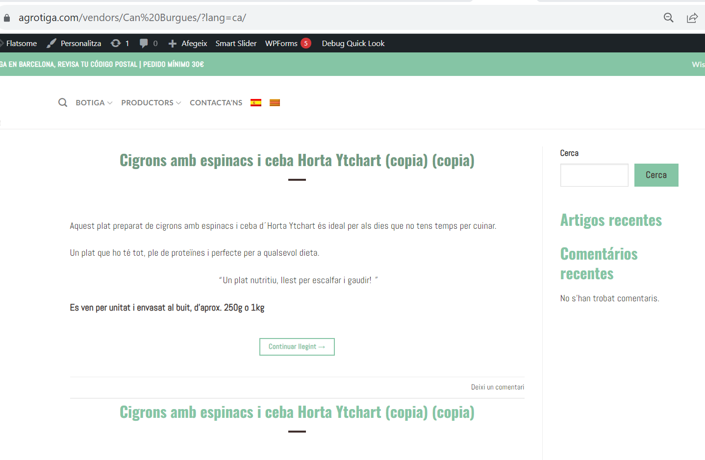

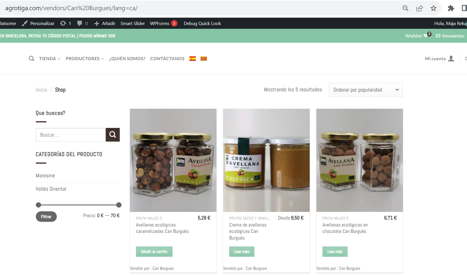

Quick question, as I was just thinking, as there is another issue, which might be related...as it is on the same error example and it might be releted to this vendor string
This is the product in Spanish, with the click on the wendors link - it leads perfectly to its selection
Spanish: example product: hidden link
Spanish: Correct link to catalogue: hidden link
Catalan: same product translated (automatically) and all good
Catalan: But the link to catalogue leads to wrong catalogue page:
The issue seems to be in the ? mark (as it is the only difference)
Correct catalogue page would be: hidden link
Wrong: hidden link
Maybe if we fix that we remove the error?
Where are we able to translate - change those links? We are using WP vendors to create Sold by (vendido por) and have a marketplace website
That's an example, but it is happening with all the translations on all products and all wendors.
Thanks a lot in advance for support.

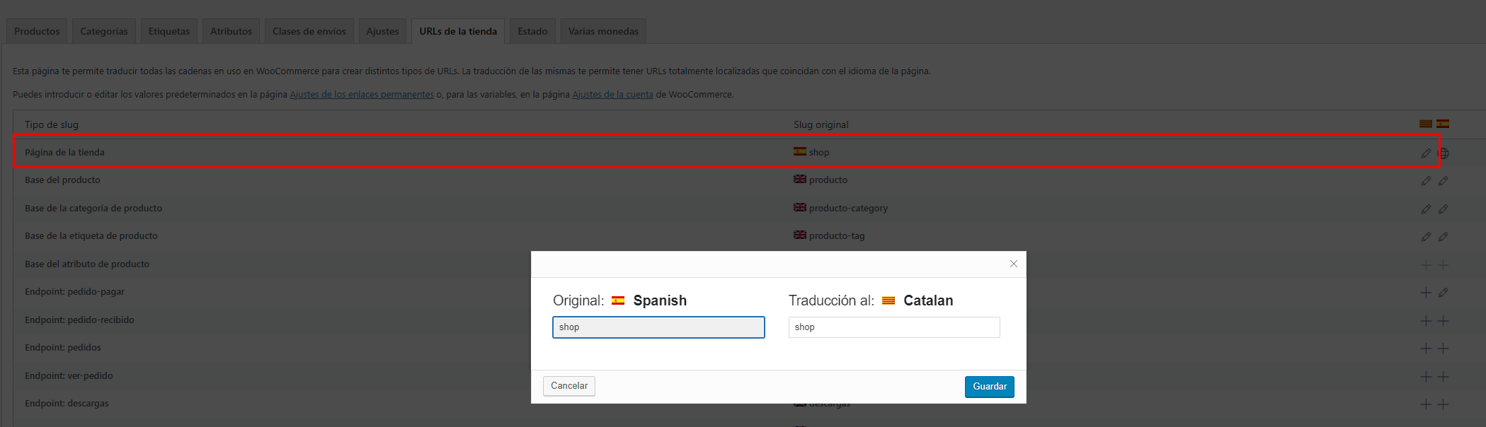

The translation of the shop page slug was missing in the secondary language.
After adding the slug translation in WooCommerce > WooCommerce Multilingual > Store URLs tab, the warning disappeared from the translated products.
Please check and confirm if the issue is resolved.
