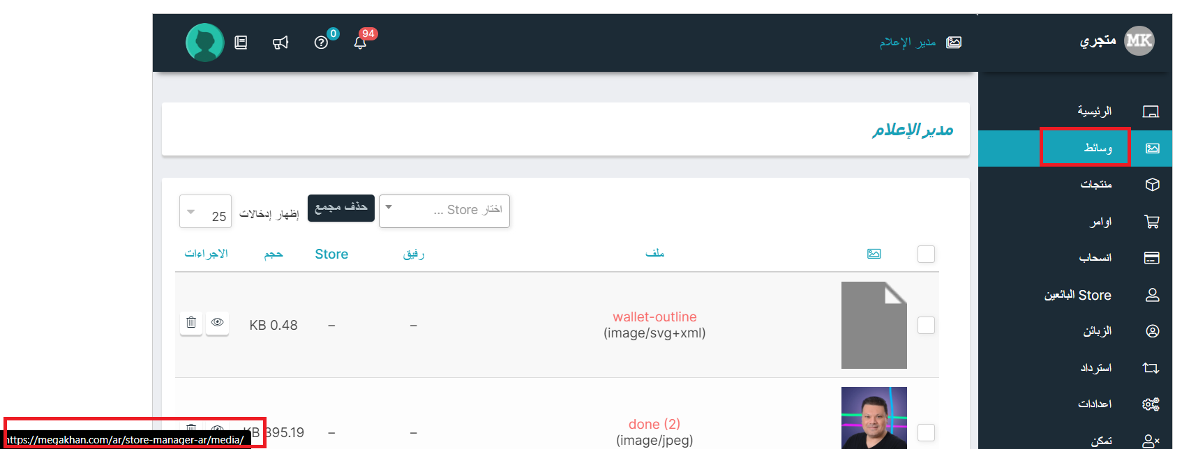

WCFM Internal Links in the front manager linked only to the default language (English) although I changed the Links to the Arabic Language.

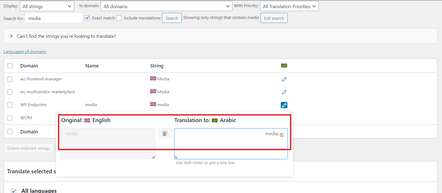

such as "media" in English and I changed it to "media-ar" as shown in the second attached screenshot, when I accessed it, it display page was not found, and if I changed it in the URL to media-ar it worked
URL: megakhan.com
Thanks,
Bassem

before your ticket is assigned to one of my colleagues, please allow me to walk you through some initial debugging steps. This will help speed up the support process.
I understood that the string translation to "media-ar", & is not reflected on the Frontend. But it works if you use the URL with "media-ar" manually. Is this correct?
It seems the actual string in the menu could not be registered yet. Can you please try to activate this option https://wpml.org/documentation/getting-started-guide/string-translation/finding-strings-that-dont-appear-on-the-string-translation-page/#enable-auto-register-strings and open the Arabic Frontend? Check then if the system detects another string to translate. It will automatically try to register all viewable getText() calls on the Frontend.
I suspect there might be another string from another text domain that is used on the Frontend.
