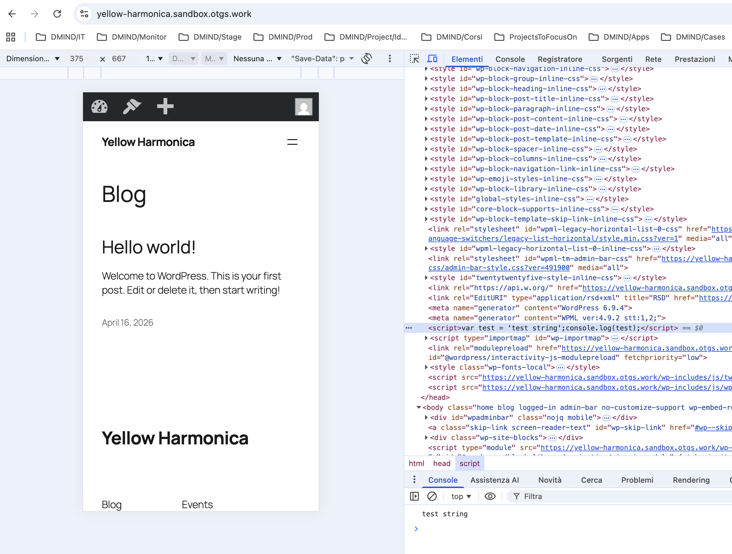

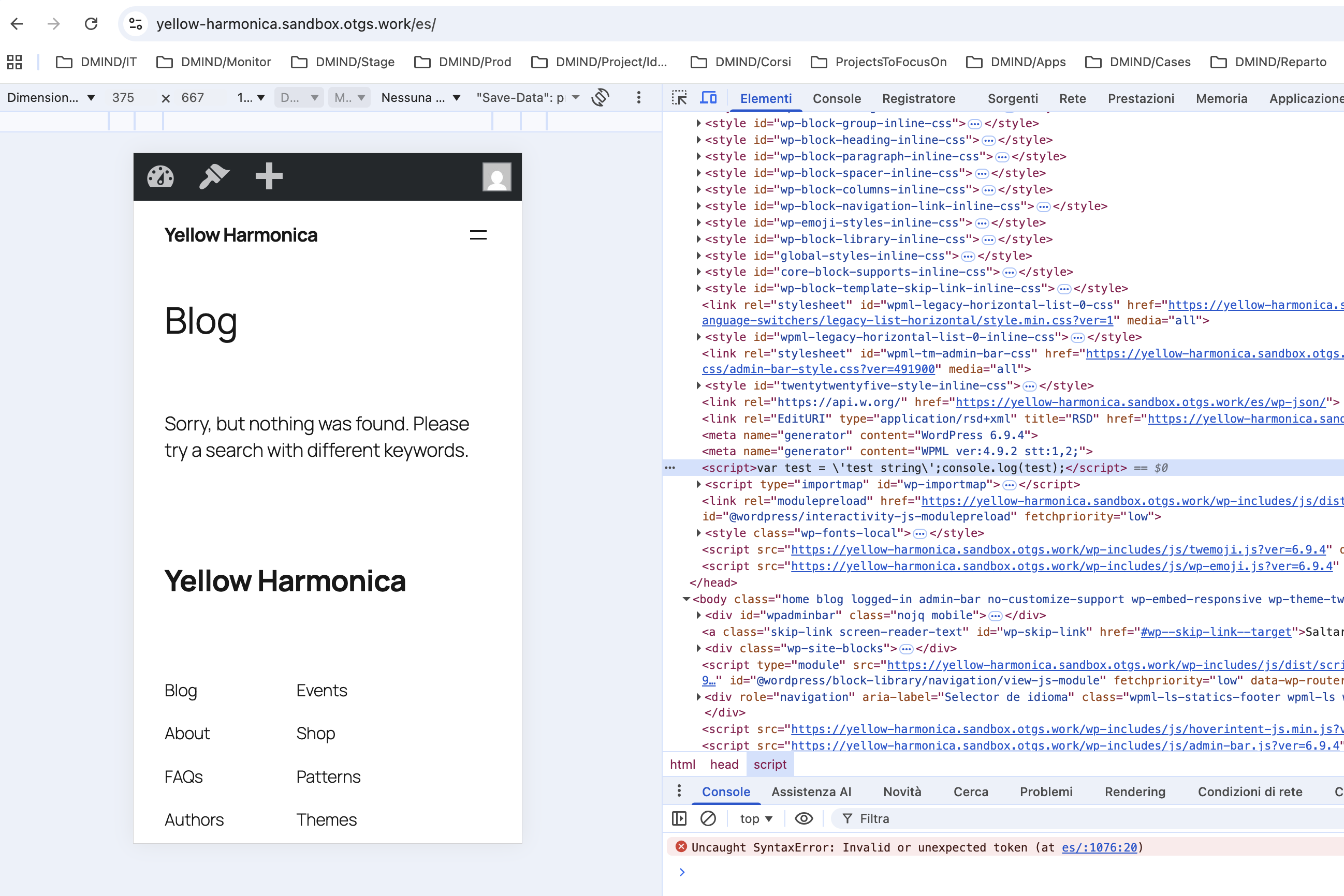

I created the Option Page with a simple textarea and use the get_field in the frontend to write the content in the head. In the screenshots attached you can find the EN page (default locale) that works and the Espanol page that is broken.
The filed is saved only once in the main localization and in others locales is saved wrongly escaped into the DB.
