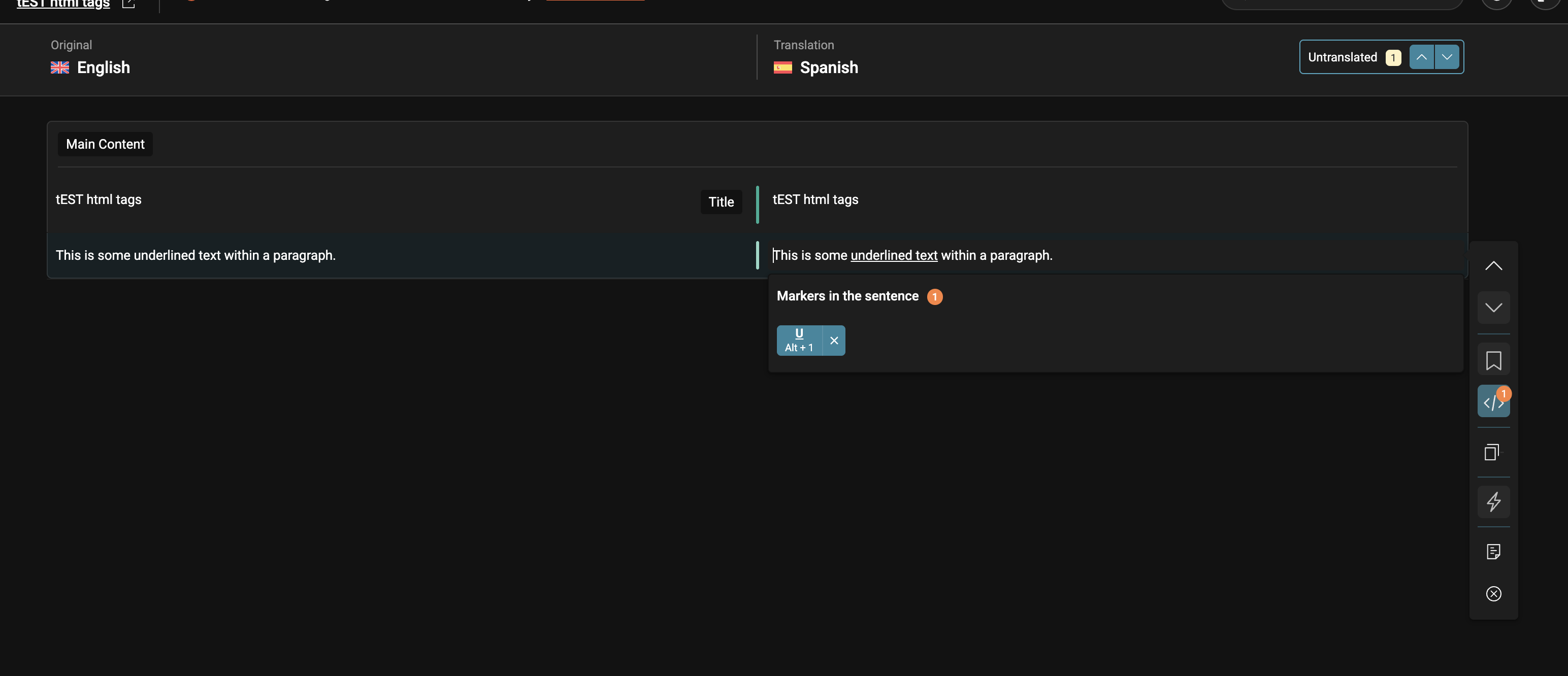

Yes I want to know about the u tag that adds underline decoration. The article you shared is generic. Is there a list where I can see what is supported and how do I have to write things in the original language in order to work?

Unfortunately I dont have a documentation that lists them, from my understanding all of them should be supported.
Please feel free to test using the following sandbox
The underline HTML tag was recognized without any issues, the ATE editor should support all of them.
