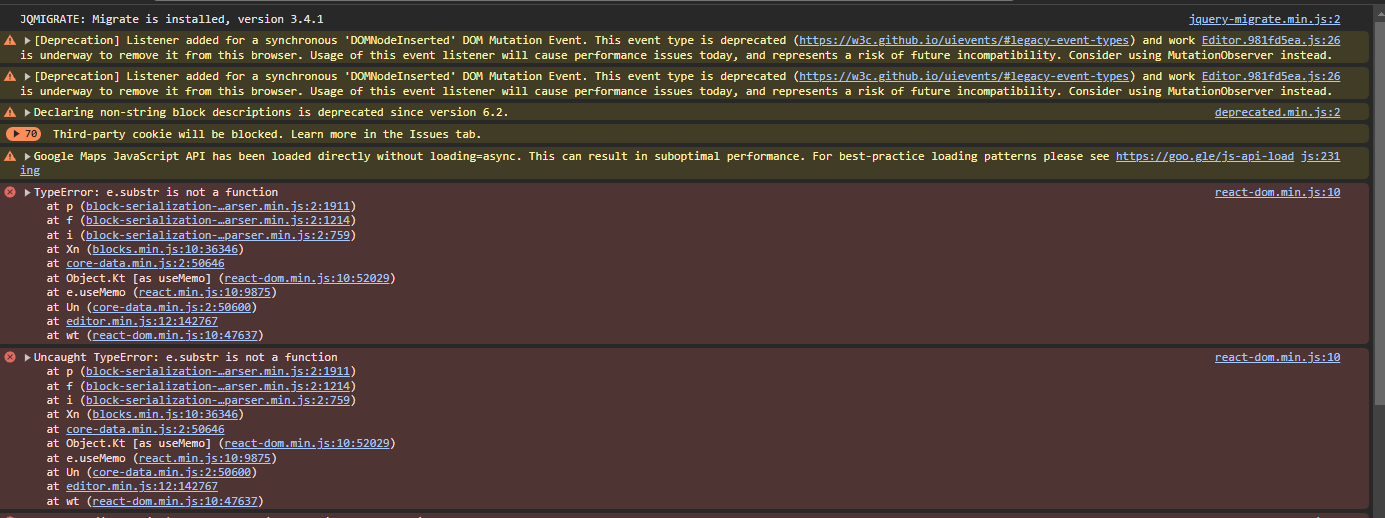

Previously, I consulted about an issue where the editing screen turned blank due to a react-dom.min.js error.
At that time, I tried removing and then re-adding the plugin, but the error was not resolved.

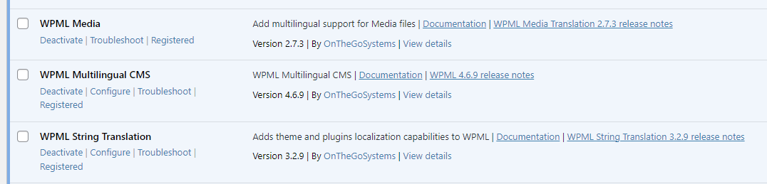

1) I notice from the debug info that you are using WPML v4.6.7, I would suggest you update to the latest version v4.6.9 (also all the WPML addon plugins that might need update).
2) Also, I noticed that you are using Advanced Custom Fields, please install the Advanced Custom Fields Multilingual plugin.

I have implemented the solution you mentioned.
However, the error has not been resolved at all.

I got the same error even though I changed to the default theme and deactivated all plugins.
There is one more thing that I am concerned about.
This error only occurs on pages. It does not occur on posts or custom posts.
In that case, does that mean the plugin has nothing to do with it?

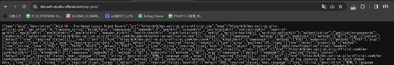

Last time and this time, I was able to get the data correctly with /wp-json/.
I think REST API is valid.

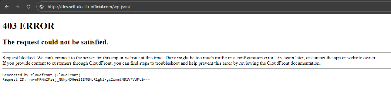

I checked the website link that is in the debug info and I see that the REST API seems to get blocked by CloudFront (please check attached image).
Could you please check if the same error (react js) shows up on the console when you disable the WPML plugins?

I think this is because it is only accessible from specific IPs for security reasons.
If you access from here, it will return correctly.

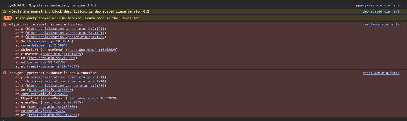

I also wrote a feature, but I disabled all plugins including WPML, but the same react js error occurred.

- What I can suggest you try next is to disable all plugins and custom features, switch to WP default theme "Twenty Twenty-One" and check if the error still shows up (It would be better if you check in an incognito browser page).
As I wrote last time, I changed to the default theme and disabled all plugins.
Even in that case, the error did not go away.
WP itself has also just been updated to the latest version.
There seems to be a problem with the server settings, so I'll ask.
