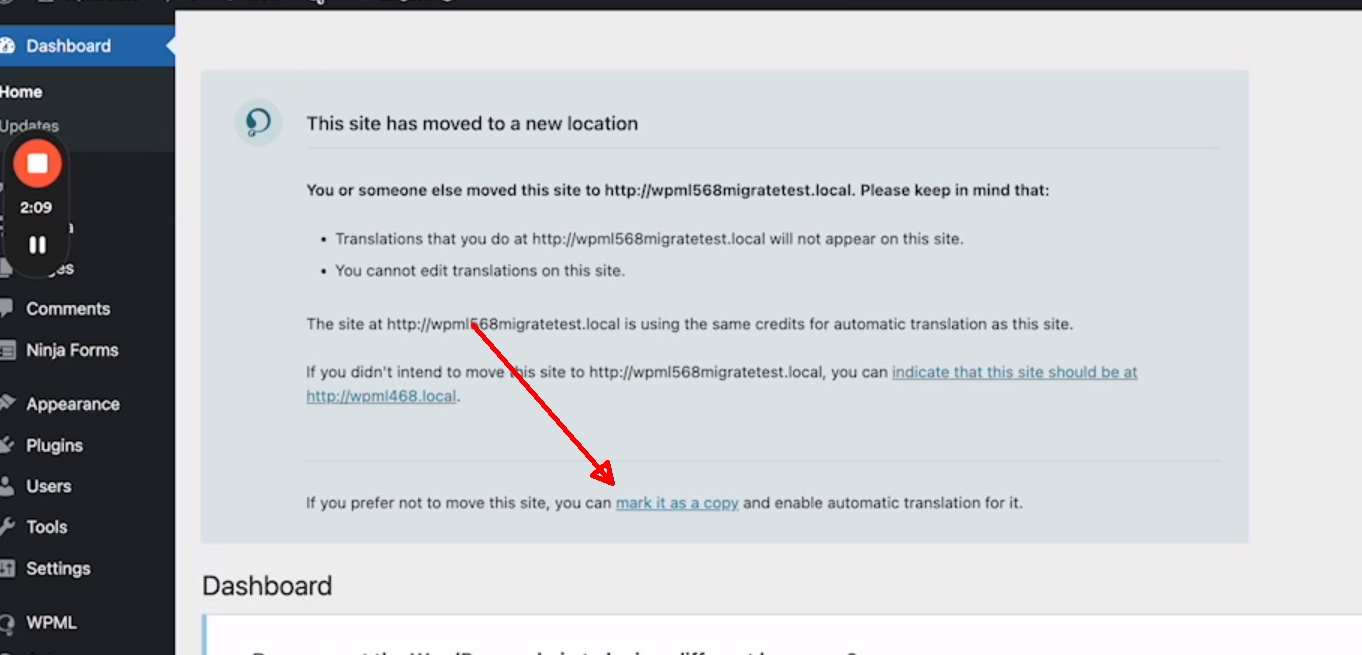

functionhealthtourism.com site is working but gives the following warning on the dashboard.
This site has moved to a new location
You or someone else moved this site to hidden link. Please keep in mind that:
Translations that you do at hidden link will not appear on this site.
You cannot edit translations on this site.
The site at hidden link is using the same credits for automatic translation as this site.
If you didn't intend to move this site to hidden link, you can indicate that this site should be at hidden link.

Please ignore my previous answer for now - can you update to 4.6.8? We just released it.
https://wpml.org/download/wpml-multilingual-cms/?section=changelog
And we introduced this "mark it as copy" option for such cases, can you check?

I am now using both sites with different keys. Thank you for your help and update.
