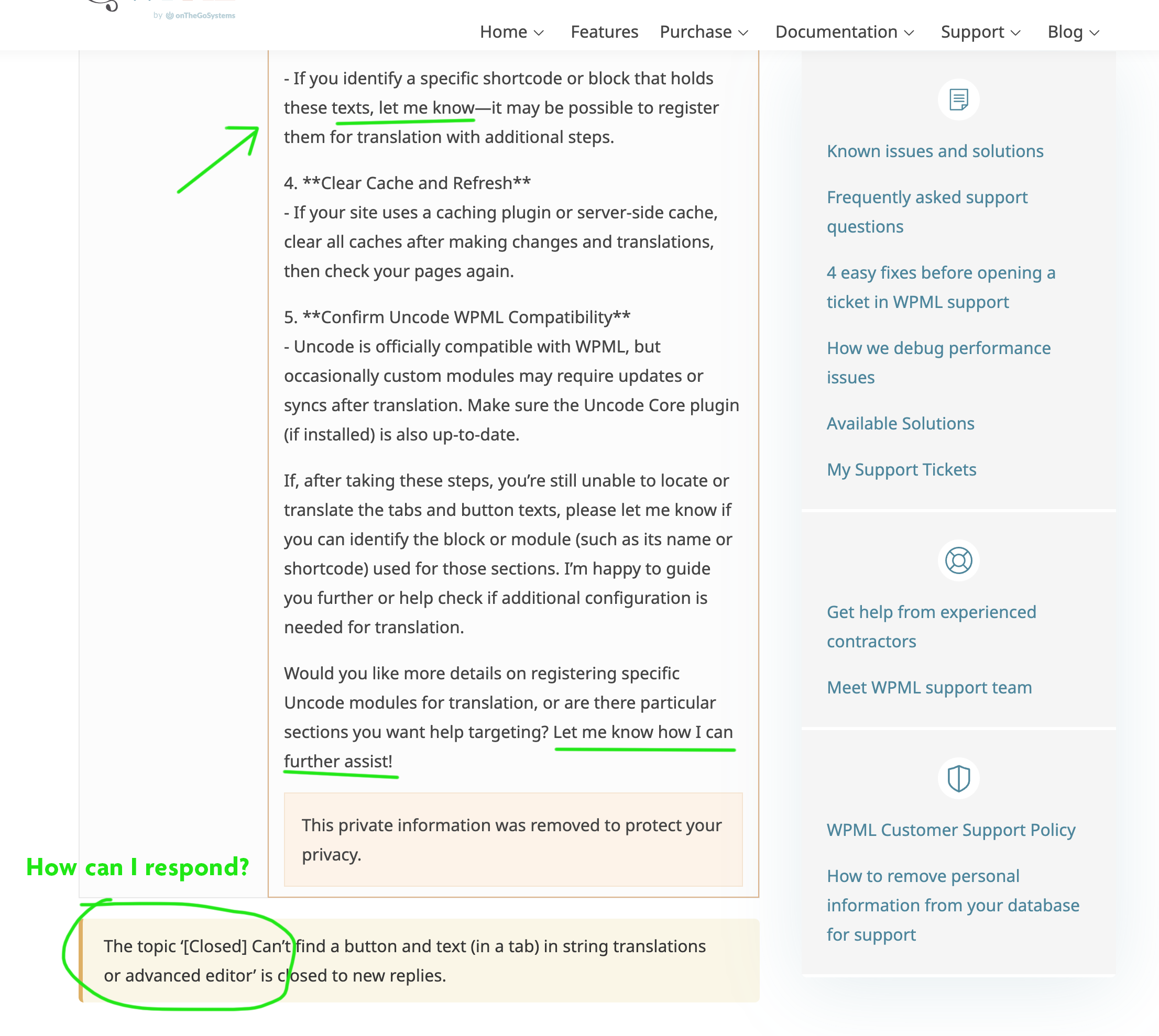

July 16, 2025 at 8:55 am #17240755
catherineB-13
I am trying to get help with my site hidden link using WPML, but the support thread gets closed automatically when I receive a response.
The support request #17240442 gets closed automatically, preventing me from responding to the bot-generated questions.
Why does my support request #17240442 get closed automatically?
How can I respond to the bot-generated questions if the thread is closed?

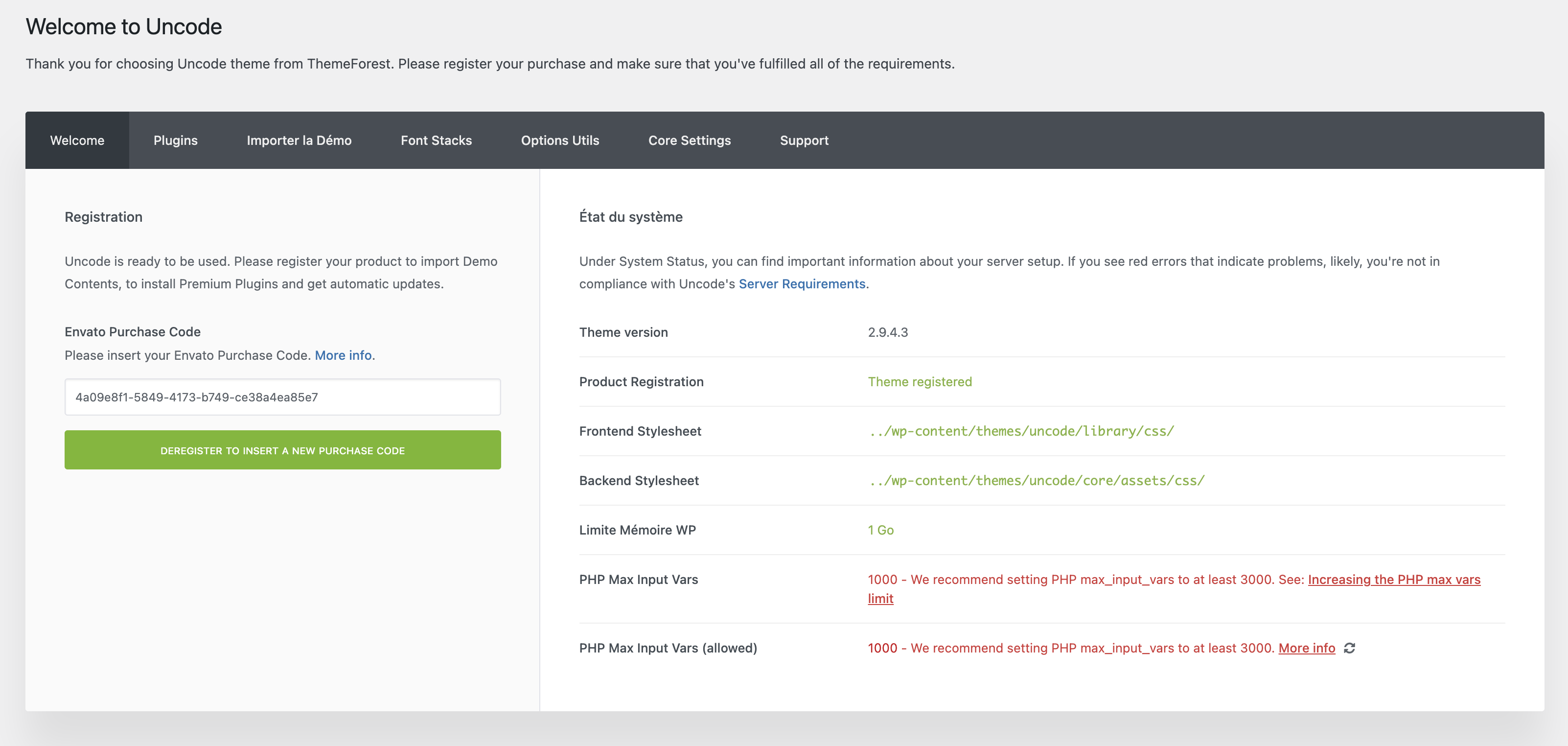

July 22, 2025 at 4:07 pm #17260324
catherineB-13
I installed the Uncode theme, Visual Composer plugin and imported the demo site, but there is an issue with the system status, notably
PHP Max Input Vars
PHP Max Input Vars (allowed)
You can see on this page in the Uncode tab:
I get an error message that the input should be increased before I can create pages.
Can this be adjusted?
Thank you in advance,
Catherine

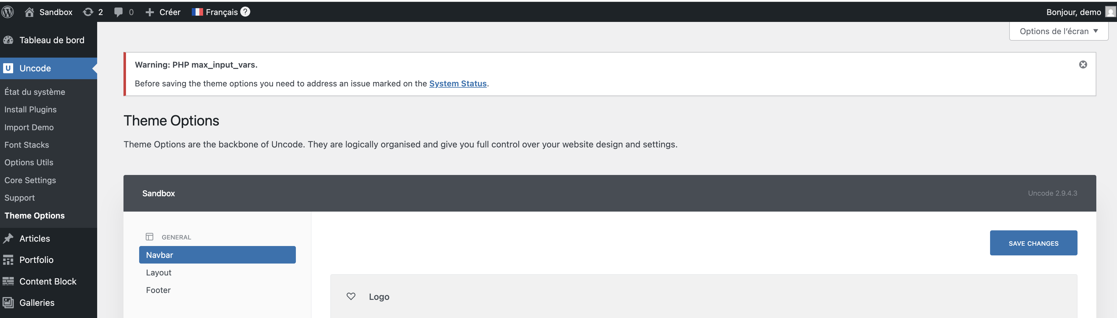

July 22, 2025 at 7:15 pm #17261027
catherineB-13
I'm trying to advance in the meantime, but I still get the error message :
(see capture below)

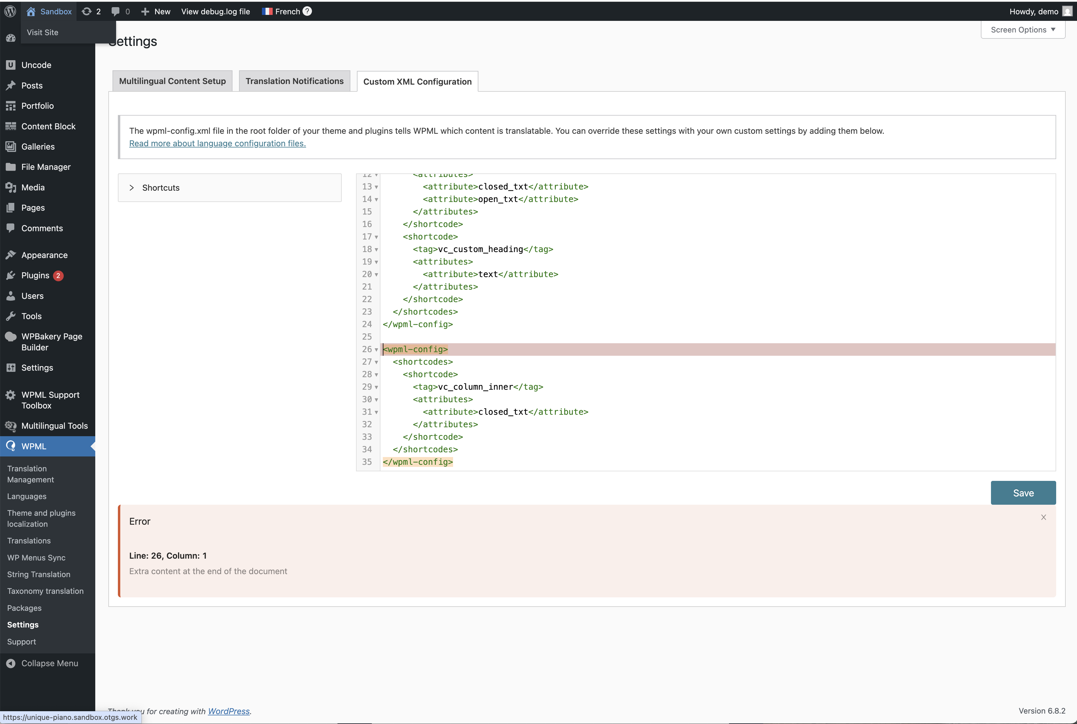

Because you explained to me how to add the the code to WPML > Settings > Custom XML Configuration, and I did it myself, it helped me understand an earlier assistance I received for a similar problem.
It was also a "READ MORE" link in a similar shortcode, but because your colleague Andrey did the manipulation himself, so I didn't really understand what was being done.
He created a config to correct the problem, which is similar, so I tried to add his config to the Custom XML Configuration but I got an error message. And it also wouldn't stop spiraling, so I refreshed the page and this erased all the code, your code as well!
Anyway, can you take a look his solution and see if the problem is similar? It is the same type of shortcode, but the config he created doesn't seem to work for ARTLINES site:

July 28, 2025 at 8:09 am #17274025
catherineB-13
So I tried to add Andrey's code to the Sandbox example, and I get the same error message :
see the capture below
July 28, 2025 at 2:46 pm #17275838
Christopher Amirian
WPML Supporter since 07/2020
I combined my code and Andrey's code on your website. Now please do a small change on the page and you should see all the text for translation.
