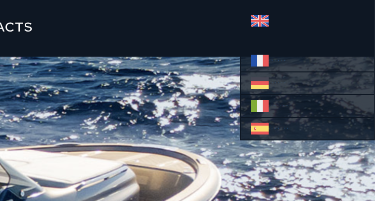

The switcher is set as dropdown flag only, but the width of the dropdown is much larger than the flag (see the attached screenshot).
I tried to fix the css as described here but with no luck:
https://wpml.org/documentation/getting-started-guide/language-setup/language-switcher-options/how-to-fix-styling-and-css-issues-for-the-language-switchers/

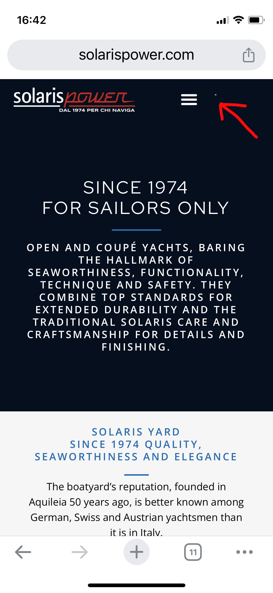

your css is now online, the width of the dropdown is correct but, on hover, the first language flag becomes very, very small and in the mobile is always very very small almost invisible.

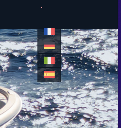

Hello Mihai,
now it almost works in desktop mode, but on mobile not yet, here in the dropdown there are all the language texts in addition to the flags...
I understand your point about custom CSS but the WPML extension is advertised as fully compatible with Elementor but it doesn't seems to me. I think my Elementor menu is nothing so special and the flag switched does't work as expected.
