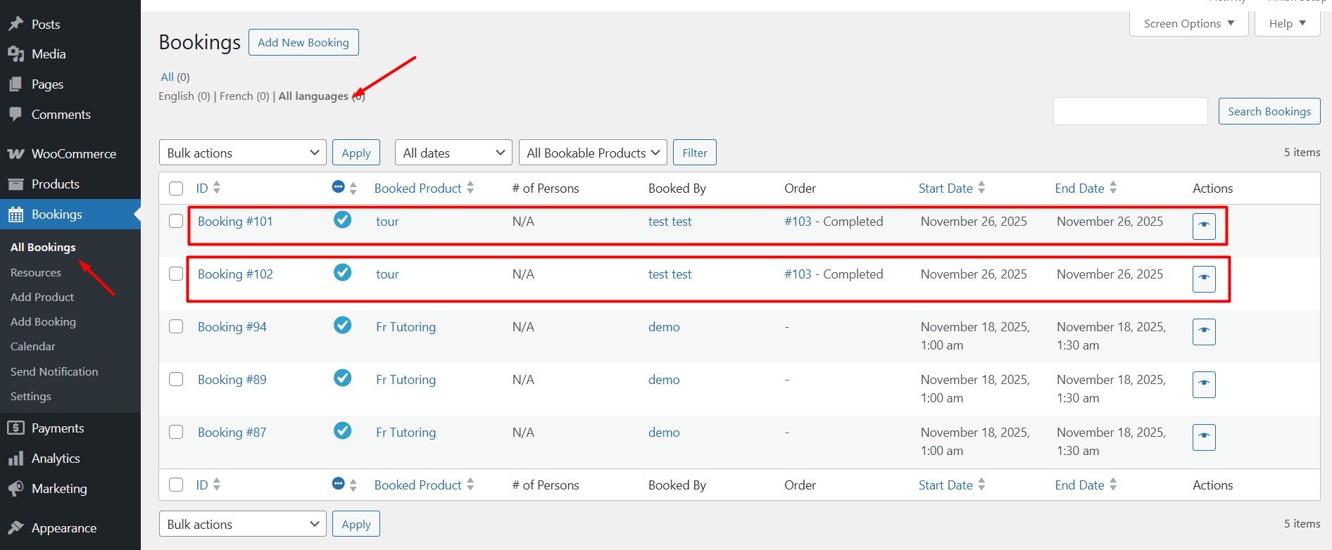

From what I see, the slot seems to be counted twice, once per language as you can see in the attached screenshot. Just to confirm, did you only make one booking in the default language, and the second one appeared automatically in the translated version?
Thanks for your cooperation and patience

I said from the beginning what the issue is, and I showed it to you on your test environment.
PLEASE do some extensive checking on your side and I'm sure you'll confirm what I mean.
YES I only made one booking.
