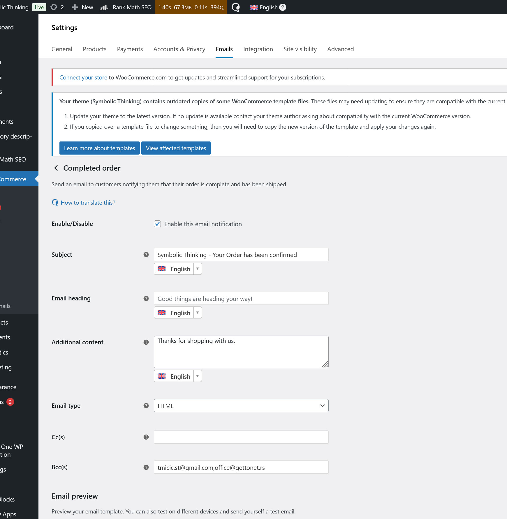

Hi, I found out what triggers 404 behavior.
See screenshot as reference.
Basically, go to Woocommerce settings anywhere where strings are present and save (in the screenshot it's a Completed email notification setting screen) - this will result in endpoints show 404 until permalinks are flushed in English language.

Thank you for sharing. I was able to reproduce the issue on a local copy, this time around. I've escalated this ticket to our development team, which will look for a permanent solution to this issue. This usually takes a few days, I'll keep you up to date.
