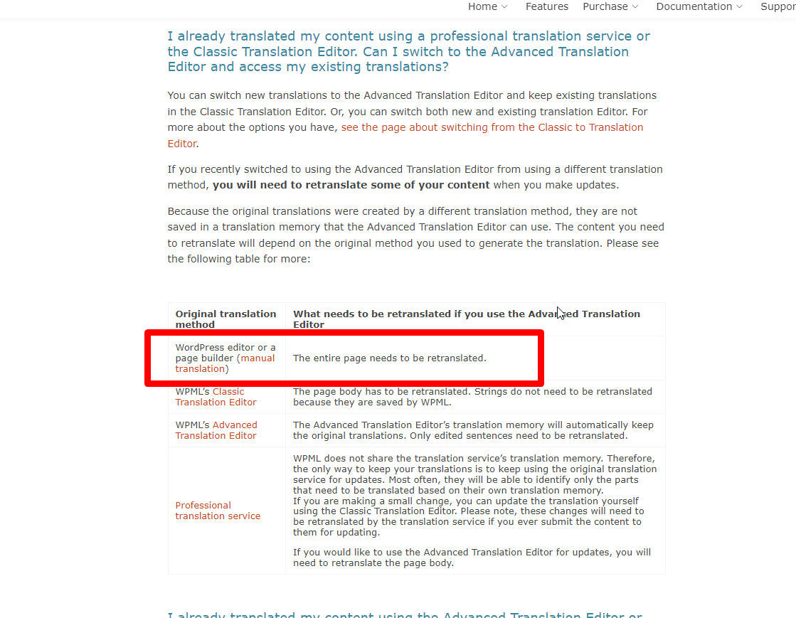

Switching from manual translation to the "Advanced Translation Editor" necessitates retranslating the content to ensure it's saved in the translation memory. This process is outlined in detail here: https://wpml.org/faq/why-arent-my-translations-showing/#switching-to-advanced-translation-editor
