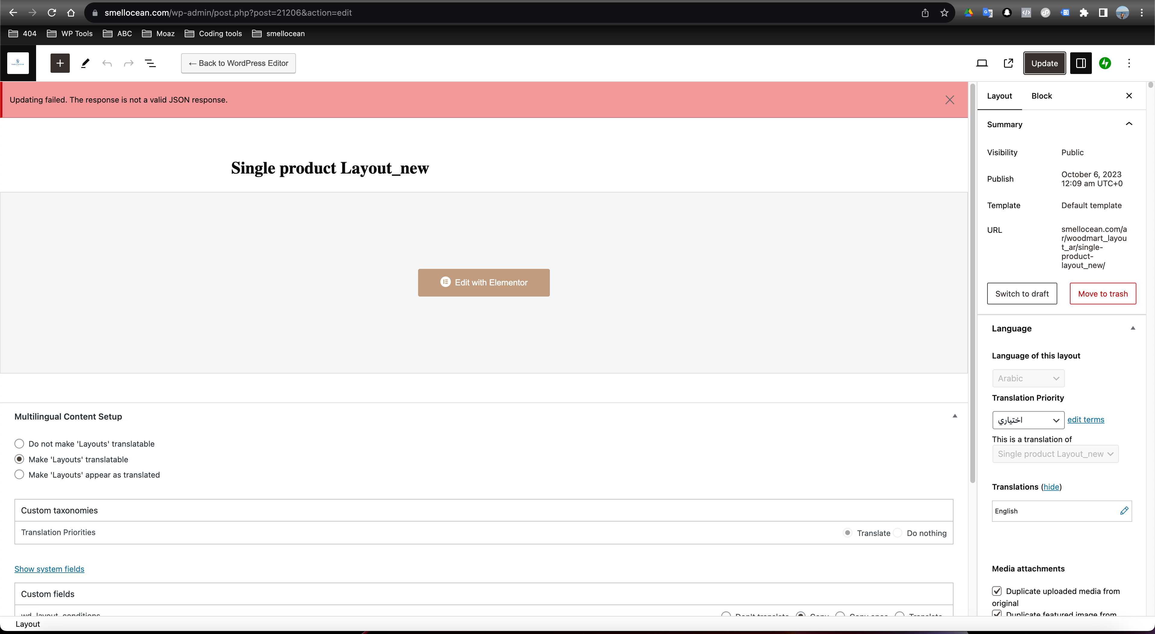

I also keep getting this error message once trying to edit the layout using the wordpress editor
October 7, 2023 at 5:19 pm #14533181
Take note, that this issue disappears once I disabled WPML String Translation.
This means, the issue actually could be related to a specific string that is registered or translated on WPML String Translation.
I am still investigating this on the local copy which I do have from your website and would like to ask you for some more patience.
Best regards
Andreas
