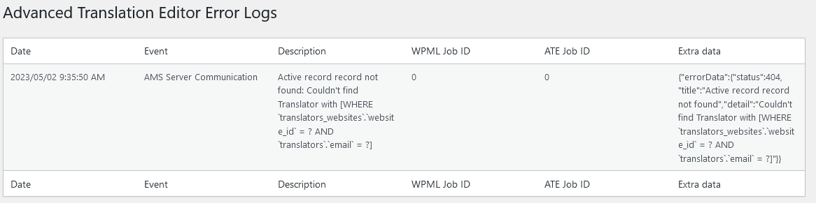

Please go to WPML->Support->Troubleshooting->ATE Error logs and share with me the top 5 errors logged there.
February 9, 2024 at 7:17 am #15284157
Nohemi
There is just an error.
It seems to no log capabilities errors.

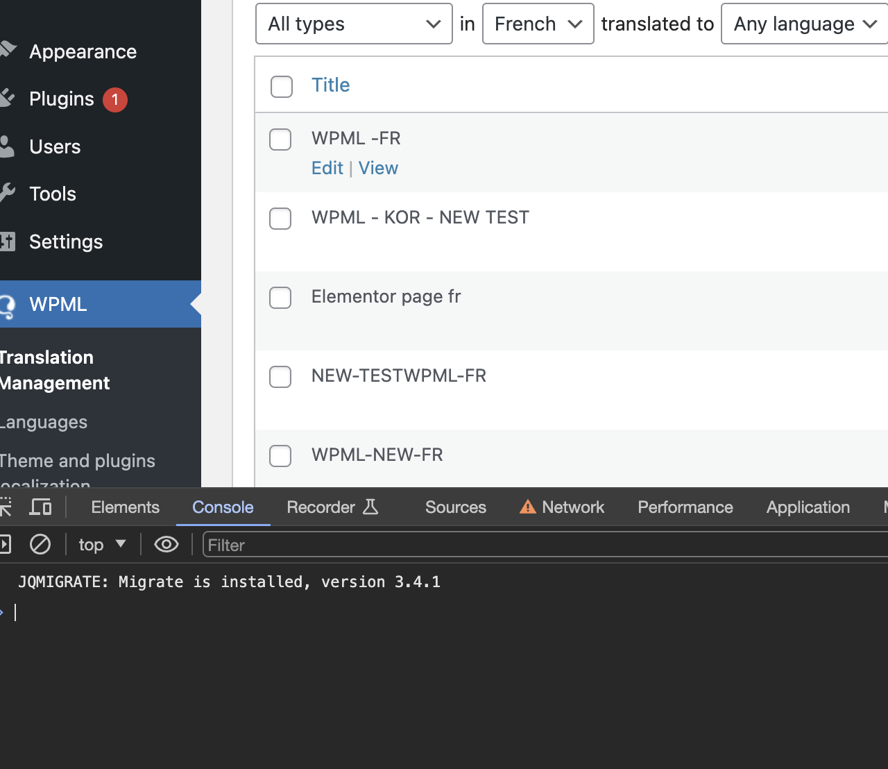

Thank you for the access details!
I have accessed the backend and navigated it, however, I cannot get a 403 error at the moment. Am I possibly missing a step?
February 14, 2024 at 8:57 am #15300585
Nohemi
You are not connected as author. You can create another author account or install a plugin like "User Switching" to use the existing one.
February 15, 2024 at 7:18 pm #15309214
Bobby
WPML Supporter since 04/2015
I've replicated the issue in a clean sandbox environment, and we're currently examining this behavior. I'll keep you updated with any new information.
For now, you can keep using WPML as usual. The 403 error appears in the console only for non-admin users who haven't been added as translators.
To remove this error from the console, you can add the user as a translator by navigating to WPML->Translation Management->Translators.
