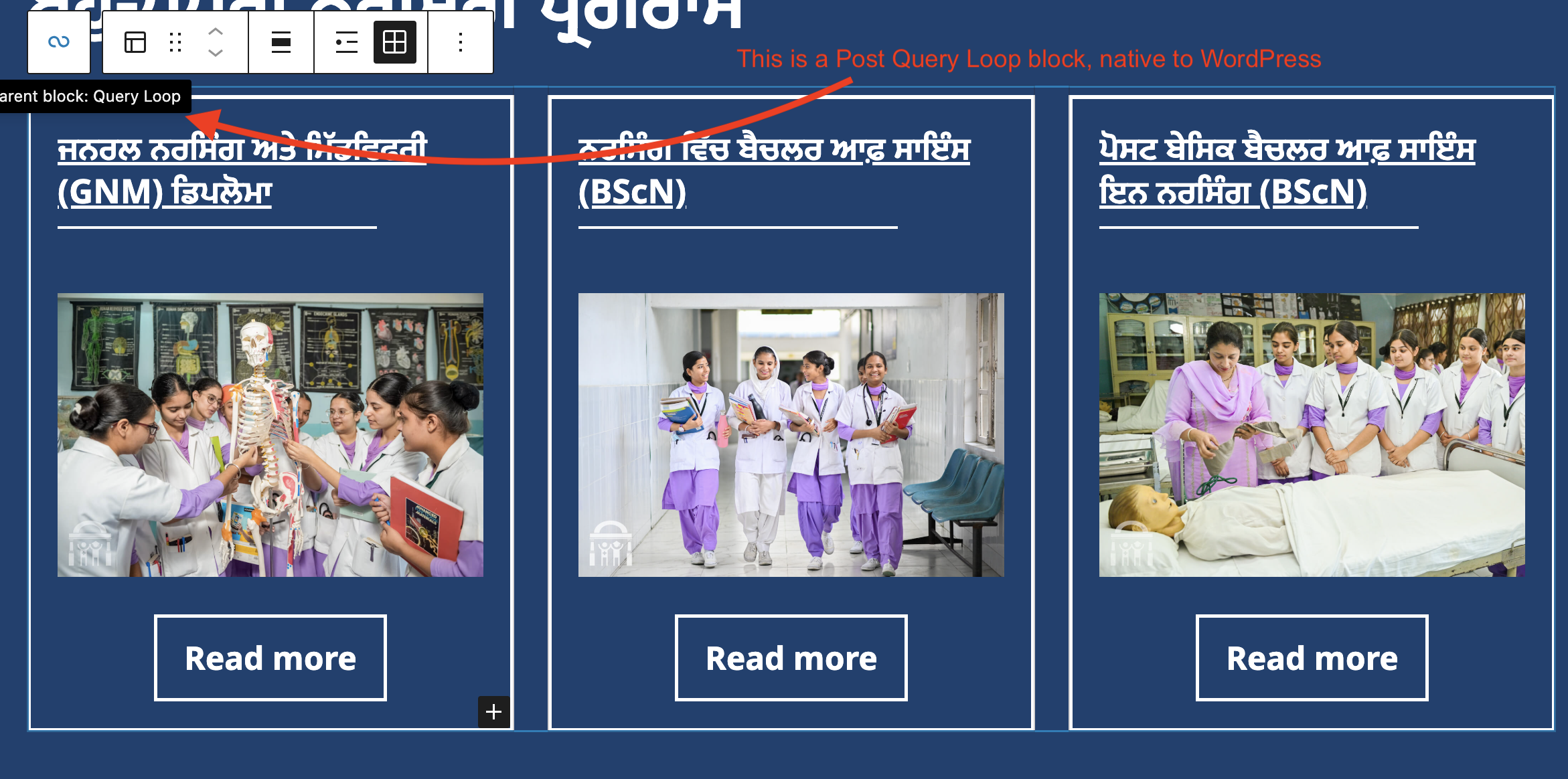

barjD-2

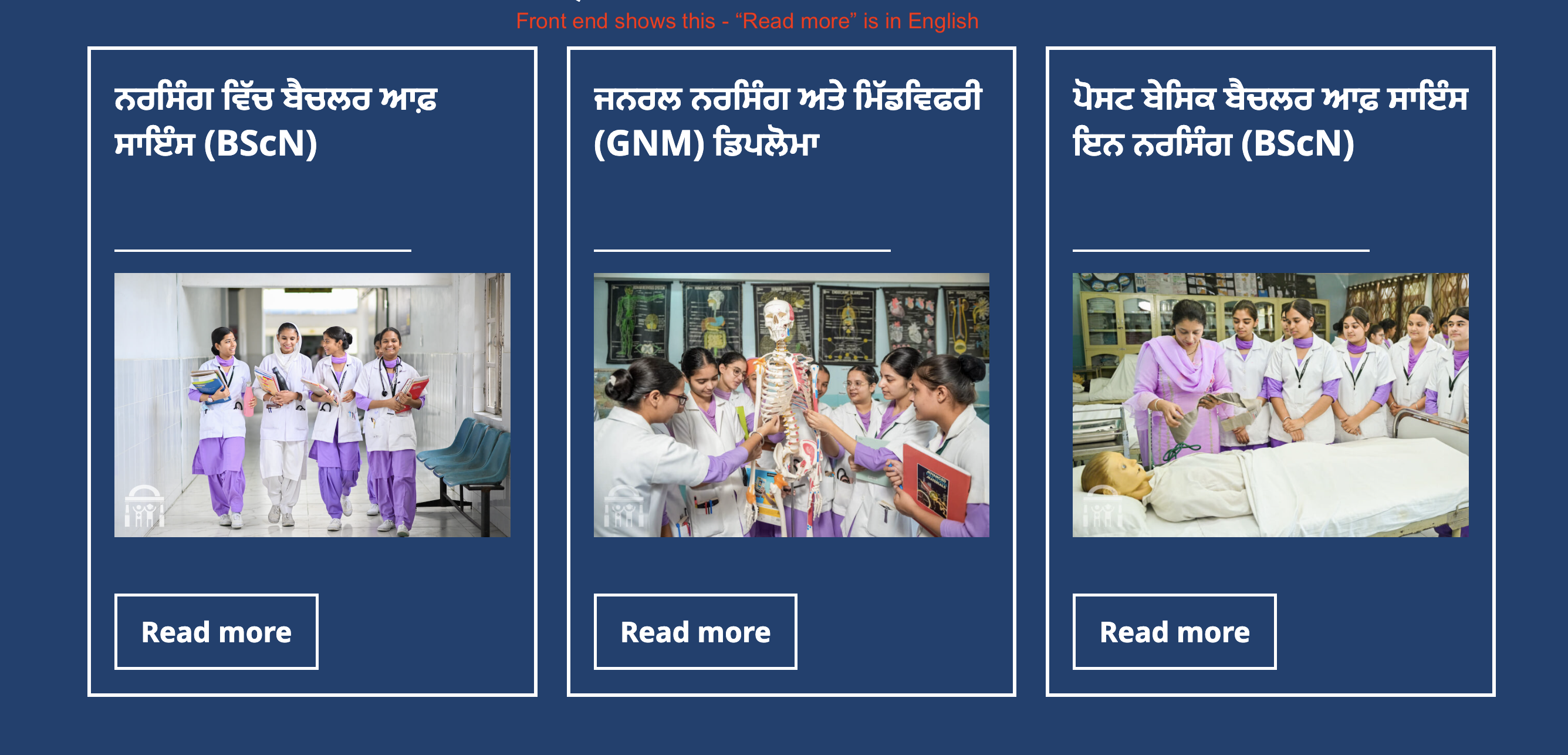

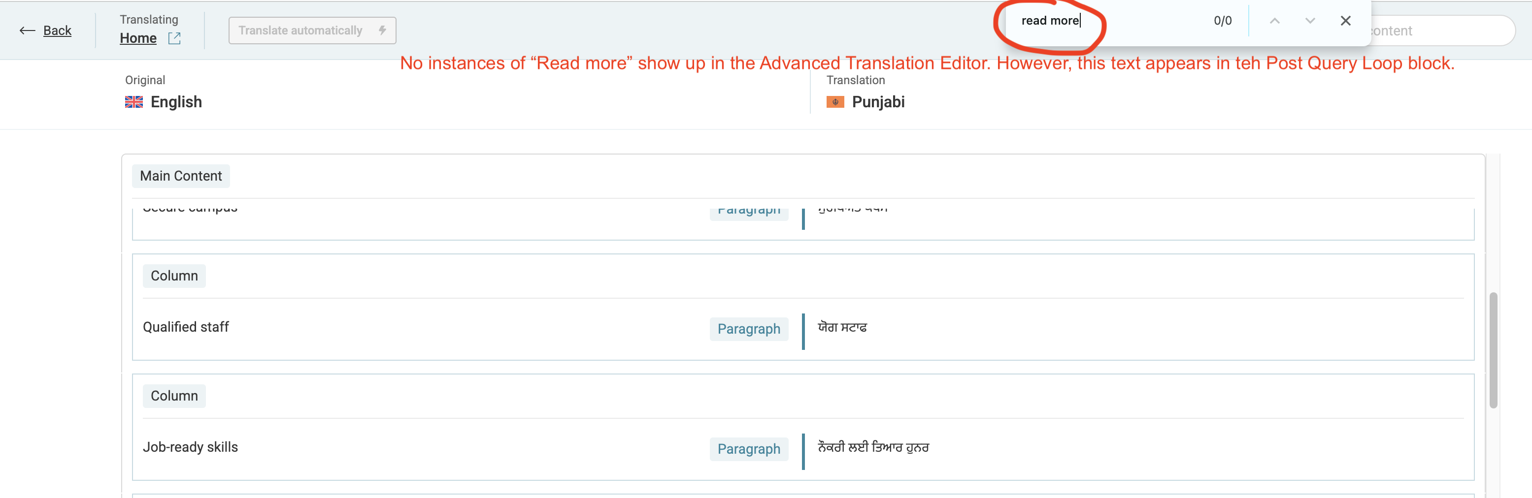

I am trying to:
Translate the "Read more" text on the button that goes inside a WP Post Query Block.
I expected to see:
The "Read more" text as a field that I can translate either:
1) In the Advanced Translation Editor
2) As a string or WP admin text that I can add to strings
3) In the classic page editor on the translated page, and have that translation 'save' until I change it
Instead I got:

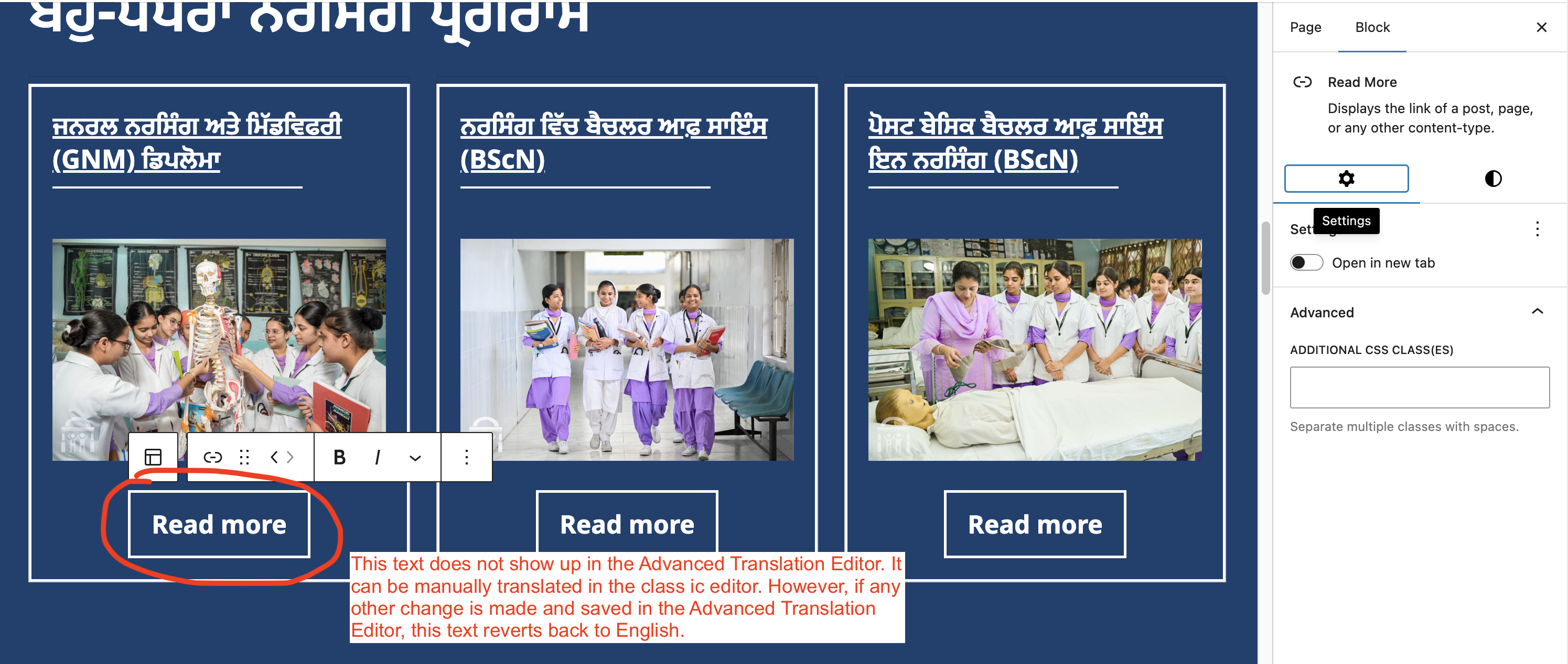

1) The "Read more" text is not available to translate in the Advanced Translation Editor.

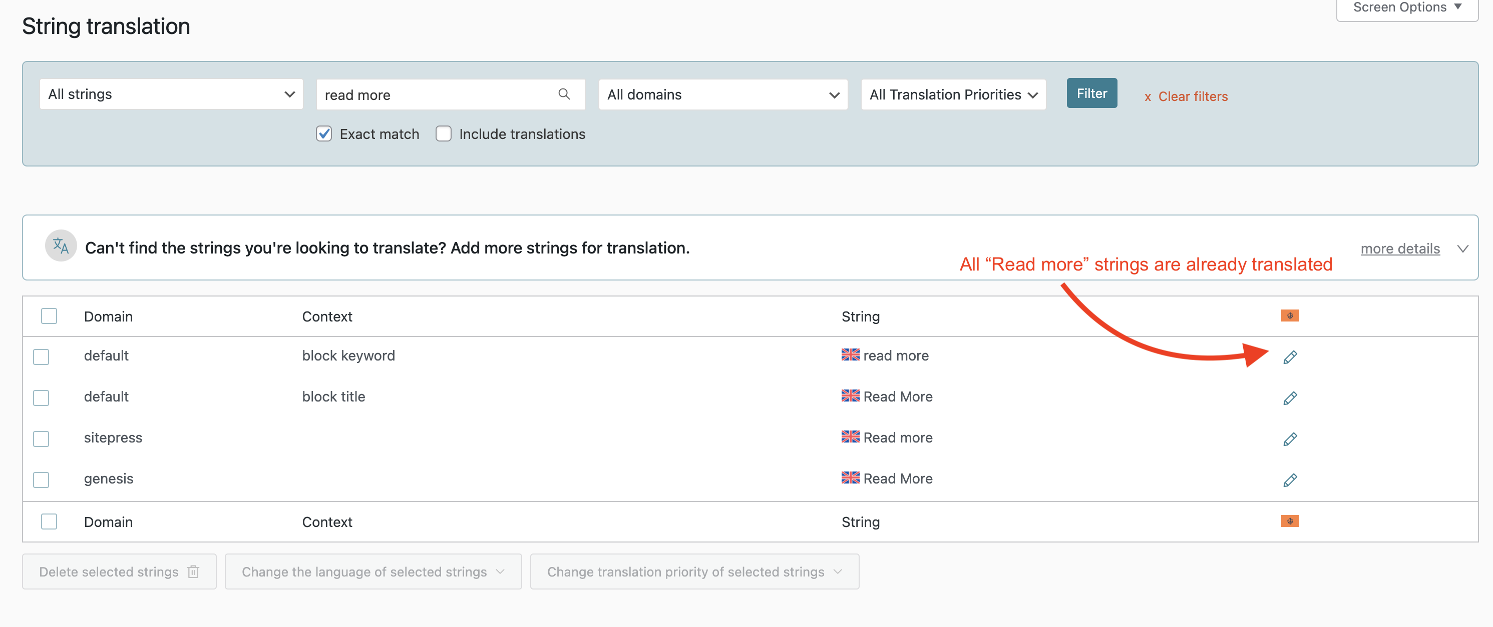

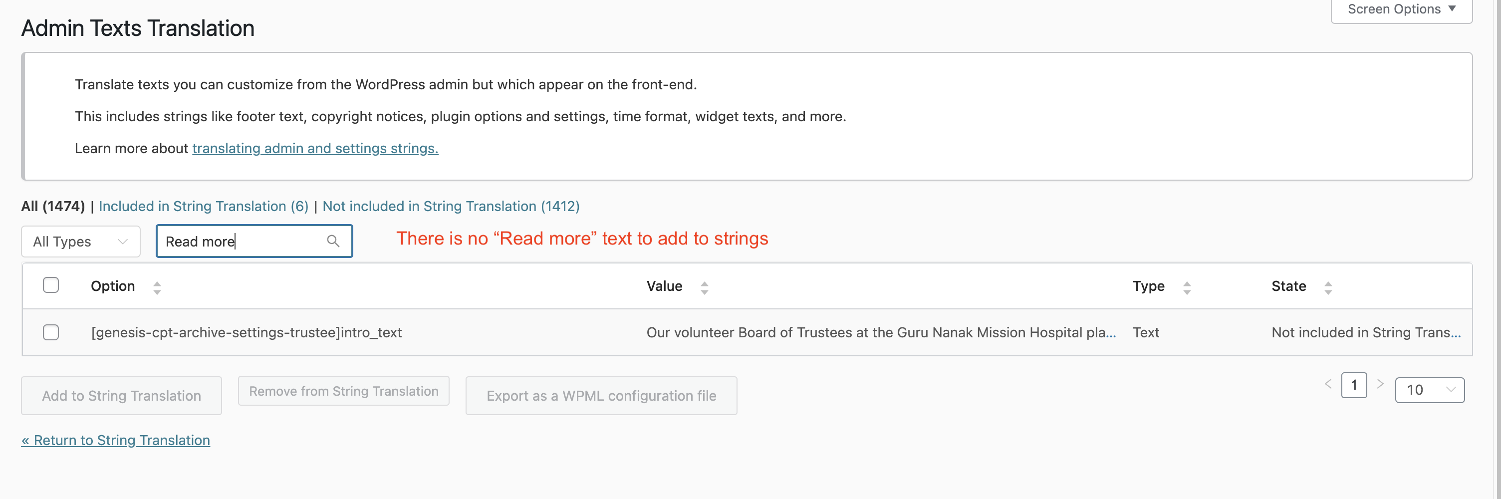

2) No strings or admin texts relating to the WP Post Query Block that I could translate, particularly for the "Read More" text. I have searched string translation, as well as the "admin texts" screen, and all instances of "Read more" are translated. None of these translations seem to apply to the WP Post Query Block.
3) In the classic page editor on the translated page, I am able to change the text to the translated language. If I click to save the page, it saves. However, if I go back to use the Advanced Translation Editor to check something, or to modify any text, and then click on "Complete Translation," then the "Read more" text goes back to the previous (original) language.
I tried switching to the old Advanced Translation Editor and this did not fix the issue.
You can see a screencast of the issue here hidden link
I am also attaching screenshots with annotations.
Why is the 'Read more' text not available for translation in the Advanced Translation Editor?
How can I ensure the 'Read more' text translation is saved and not reverted?

Hello, I have completed all the steps noted, and the "Read more" was not in the ATE for translation.
I did this on the same development site which you have access to.
I took out the character in the title of "Home" so now it reads "Hom" and I clicked on save. Then I went back to WordPress > Pages and I clicked on the cog icon to open the ATE.

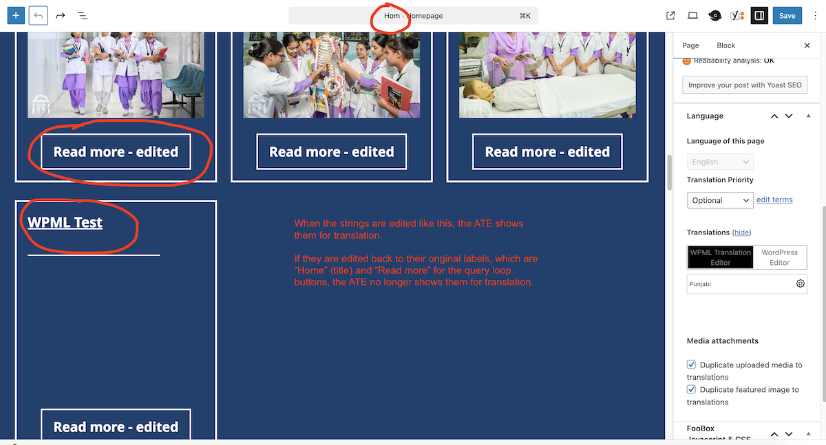

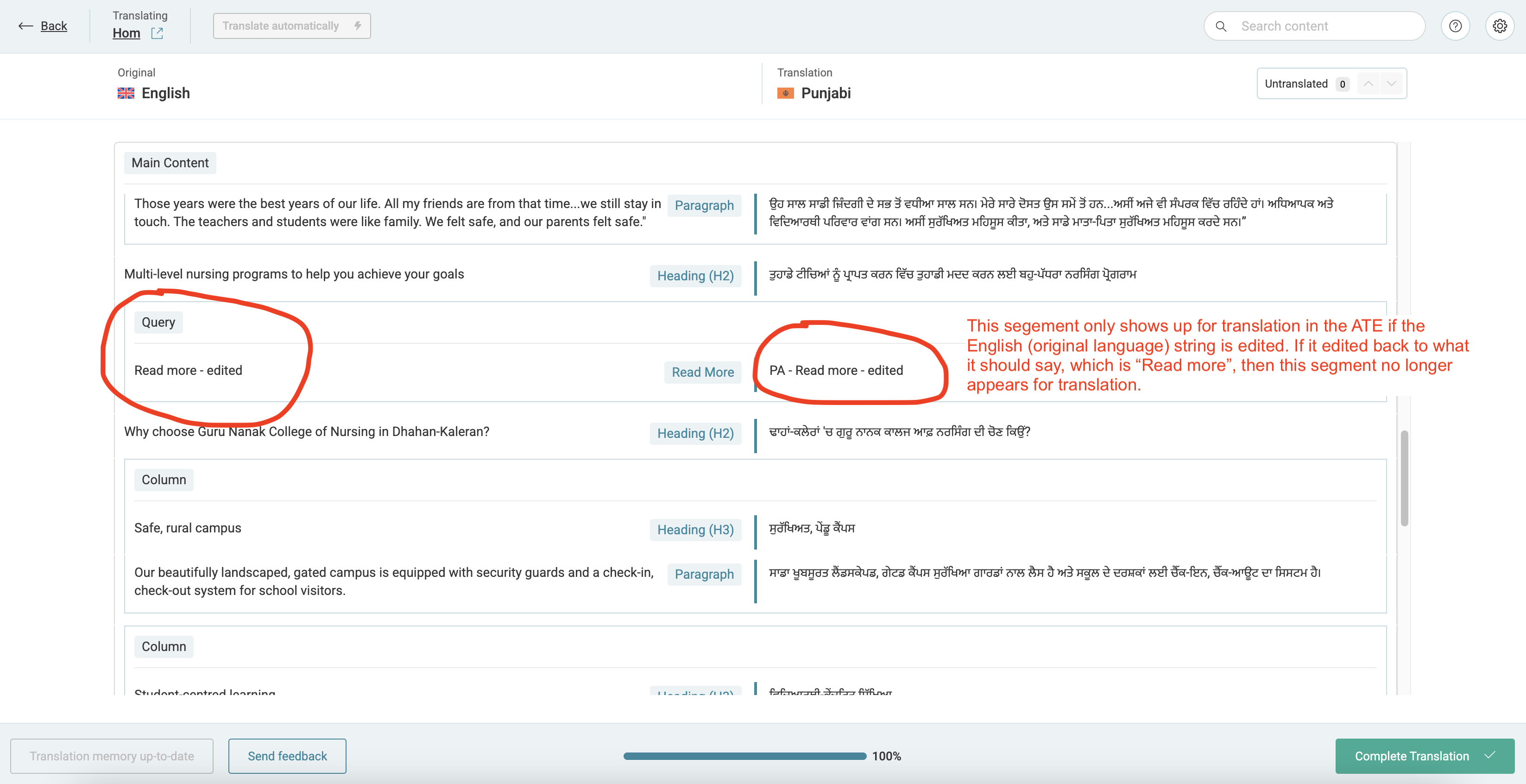

May 9, 2025 at 8:22 pm #17017865
barjD-2
Hello, thank you for your help.
However, it looks like there is something about the word "Read more" or the title of "Home" that somehow prevents the ATE from showing the string "Read more."
I see that in English (original language), you changed "Read more" to "Read more - edited."
This was in addition to me changing the title of the page from "Home" to "Hom".
With the home page having these edits, I was able to open the ATE and I could see that "Read more - edited" was a translatable string. In Punjabi, you put "PA more - edited."
However, when I went to try to set this up with a proper translation (to ensure it would work with Punjabi characters and the right words), I ran into the same issue.
When I changed the title of the English page back to "Home" and reverted "Read more - edited" back to just, "Read more," the string no longer appears in the ATE for translation.
