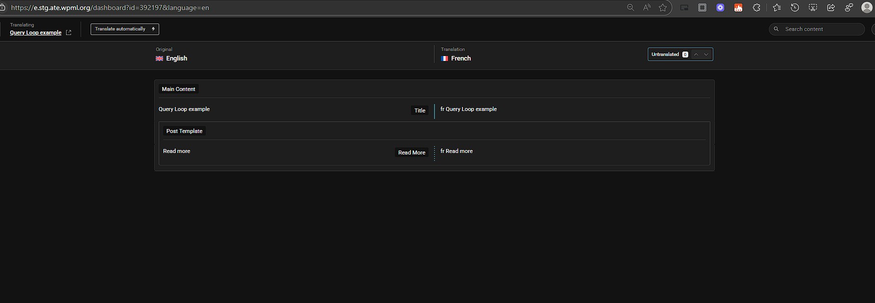

I see we already have a test site for this purpose:
As you can see on the screenshot, the "Read more" text is translatable inside the Advanced Translation Editor.
The reason for that is the following custom XML config, which is saved at WPML > Settings > Custom XML Configuration:
<wpml-config>
  <gutenberg-blocks>
    <gutenberg-block type="core/read-more" translate="1">
      <key name="content" />
    </gutenberg-block>
  </gutenberg-blocks>
</wpml-config>
After adding the config to your site, you need to edit the original text inside the block on the original page, then save the page and translate it.
Can you please confirm if this solves the issue for you?
Best regards
Andreas
