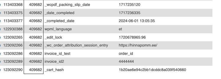

I have a custom script which triggers with the hook woocommerce_order_status_processing in theme function file, when the order status is changed to processing. I noticed that order meta data is not saved to the database. A deeper investigation showed that the meta is stored but something deletes it, as add_post_meta returns the meta ID and if I look into the database, there is no such ID. I added die() right after add meta, then everything is okay. Even if I read the meta by ID with get_metadata_by_mid(), it returns the meta. But some other process interrupts and deletes my meta. Then I deactivated plugin by plugin and tested them. After disabling 'WPML Multilingual CMS', the meta is stored and stays in the DB. Site credentials are added into ticket #15899109.

I did now manually. see my video hidden link
1. checked is meta available - no
2. changed order to pending (ootab maksmist)
3. checked meta - no
4. changed order to processing (Töötluses) - now the hook should add meta to order, but no
5. turned off plugin "WPML Multilingual CMS"
6. changed order status to pending
7. checked meta -no (everything ok, so far there should not be them)
8. changed order to processing, now the hook should trigger and add meta, and it did
in debug.log is visible that system added two meta entries on both points 4 and 8, but somehow the meta created on point 4 disappear
[11-Jul-2024 06:07:13 UTC] WP order ID: 409682, invoice ID: 4444444
[11-Jul-2024 06:07:13 UTC] 123092275
[11-Jul-2024 06:07:13 UTC] 123092276
[11-Jul-2024 06:08:18 UTC] WP order ID: 409682, invoice ID: 4444444
[11-Jul-2024 06:08:18 UTC] 123092286
[11-Jul-2024 06:08:18 UTC] 123092287
