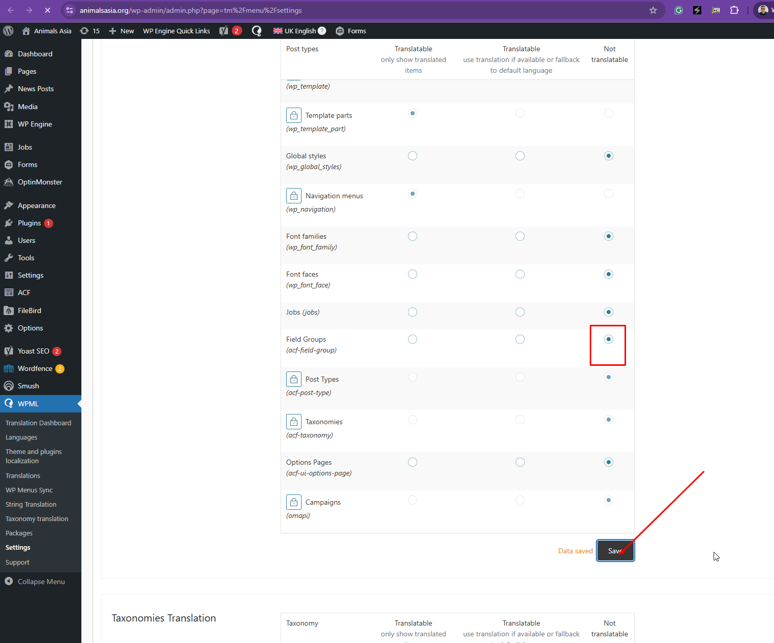

On the dev site, I see the same as you – 'ACF Field Groups' is set to 'Not translatable' and the Save button in the 'Post Types Translation' section is visible. This is good and as it should be.
It's on the production site – which you don't have access to – where there's no Save button in the 'Post Types Translation' section and I can't save it when I change 'ACF Field Groups' to 'Not translatable'. Could you please help us solve what's happening here?

Thanks for your reply. The save works fine as shown in the attached screenshot in WPML > Settings > Post Types Translation as shown in the attached screenshot and the field group option looks correct when I checked.
Since you're using custom code to configure the ACF field options, please ask your devs to refer to the correct settings here https://wpml.org/documentation/related-projects/translate-sites-built-with-acf/setting-the-translation-preferences-for-acf-fields-created-using-php-code/ to enable translation for the custom fields.
