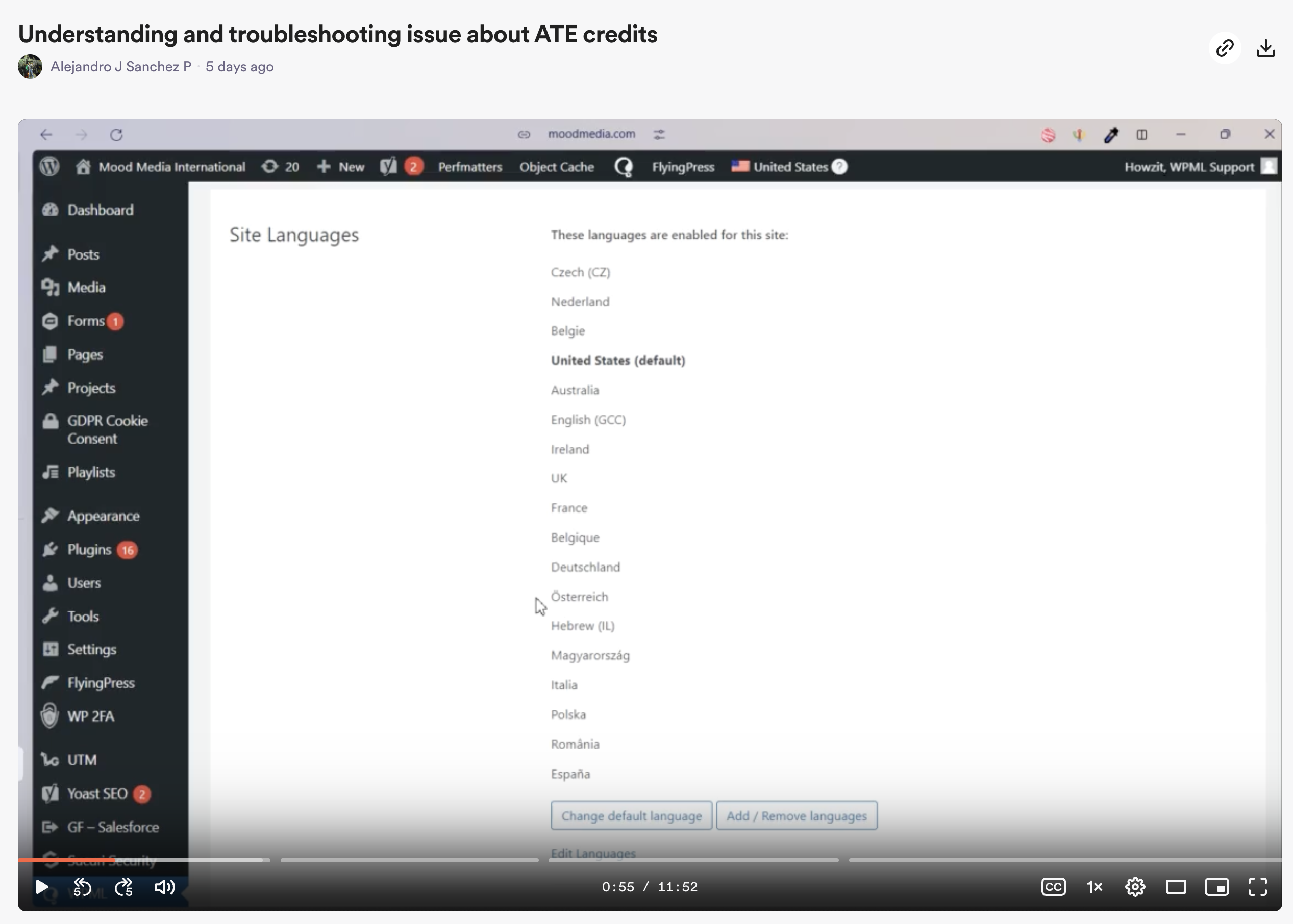

My investigation is here: hidden link
From what i see the languages were not disabled but hidden when the credits were used which is expected (hidden means something like "this language is not ready yet, so i don't want it to be public" so it's hidden from the front-end, but it can and will be translated normally).
I can state this because of the status of some jobs in many of the dates where i see that translations occurred for these languages (some of them were early June and early to mid february, very briefly and not for ALL the languages so some were indeed disabled back then).

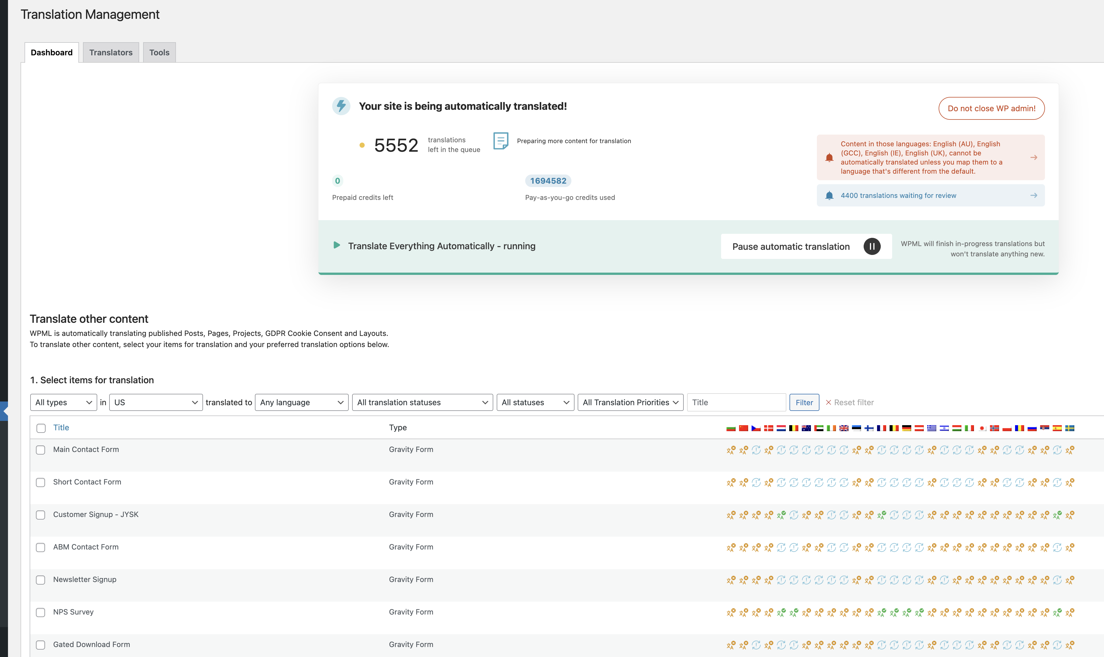

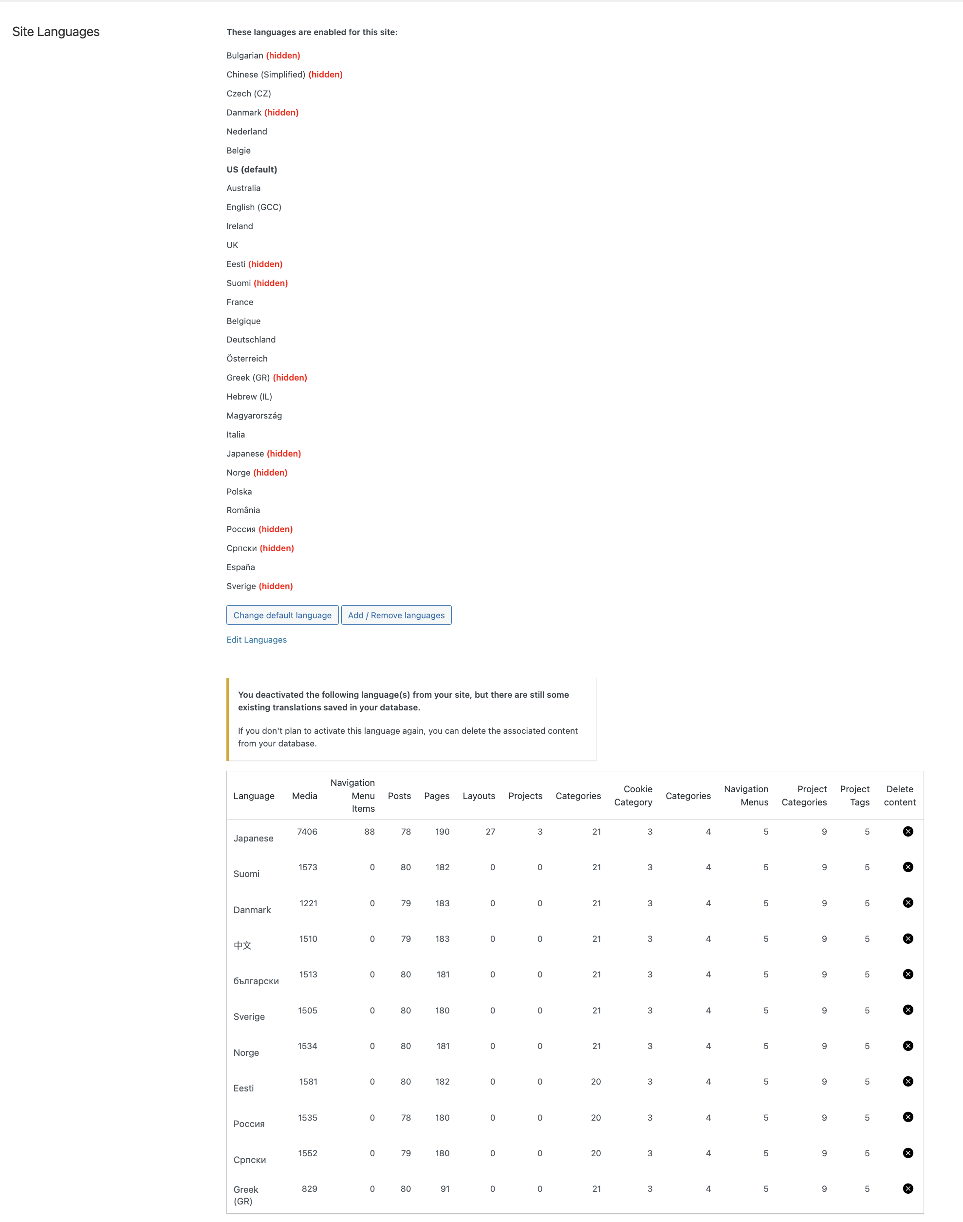

The same issue just happened again and WPML suddenly enabled all my deactivated languages again and started automatically translating remaining content for those languages. I have attached two screenshots of this and paused automatic translations again now. One of the screenshots clearly shows that all languages are listed as enabled now but some of them are simultaneously listed as disabled! That's something that shouldn't be possible and of course none of the deactivated languages should be activated in the first place.
Regarding your investigation, I've attached a screenshot from your Loom video that shows all languages that should be active. What WPML is showing in your recording is the correct list of enabled and disabled languages. The languages that are shown as deactivated were deactivated over a year ago and never enabled again. I understand the difference between hidden and disabled languages. None of the disabled languages were ever made public, they were always hidden and then about a year ago fully disabled. After that we never touched them again. I tried to remove the content in those disabled languages too, using the buttons in the table on the "Languages" page, but every time I cleared the content, at some point WPML starts showing the content of the disabled languages again on the "Languages" page.

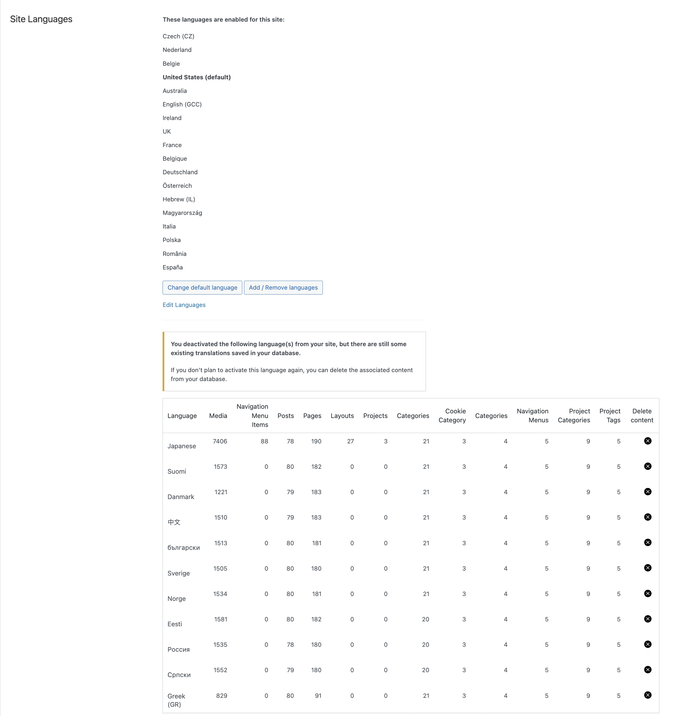

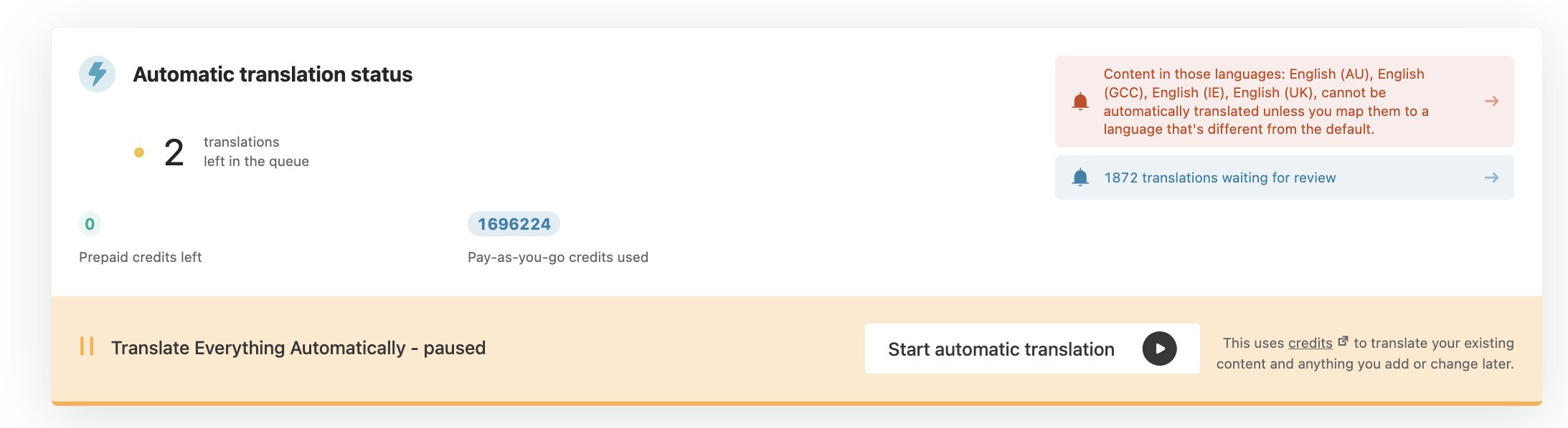

It seems to have gone back to normal now and the deactivated languages are no longer in the list of enabled languages. WPML is only showing 2 translations left in the queue, but I will keep automatic translations disabled for now until we fix this error.
Here is a list of translation pairs that should always stay disabled and never translate. I'm even happy for those to be completely removed from the site but WPML doesn't seem to allow us to do that.

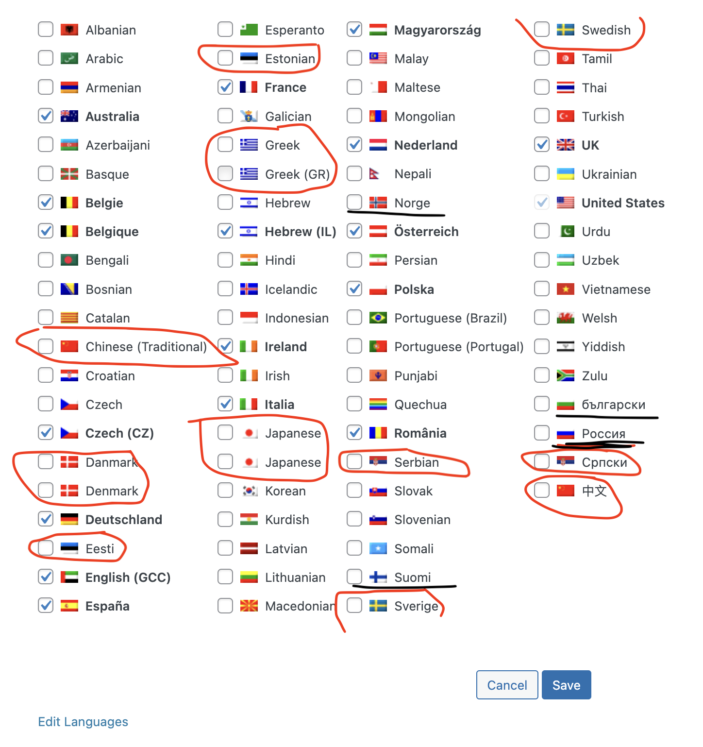

Hi, I just opened the 'edit languages' menu and noticed that several of our disabled languages appear twice in the selection. Maybe this is why some of them become active while the other version potentially stays deactivated?
Only the black underlined languages of Norwegian, Finnish, Bulgarian and Russian exist as a single language, as per the attached screenshot.
All circled deactivated languages in red exist twice.

I have now enabled the following languages again, unhidden them, and then disabled them again:
- Chinese (Traditional)
- 中文
- Danmark
- Denmark
- Greek
- Greek (GR)
- Eesti
- Estonian
- Serbian
- Српски
- Sverige
- Swedish
- Norge
- Suomi
- български
- Россия
Weirdly none of these languages showed up as "hidden" after enabling them apart from Greek (GR). They are all disabled again now.
The remaining language that I haven't done this for is Japanese.
Jan

You're right and i was looking into it because they seem to be languages that were modified and that might be why they are like that.
