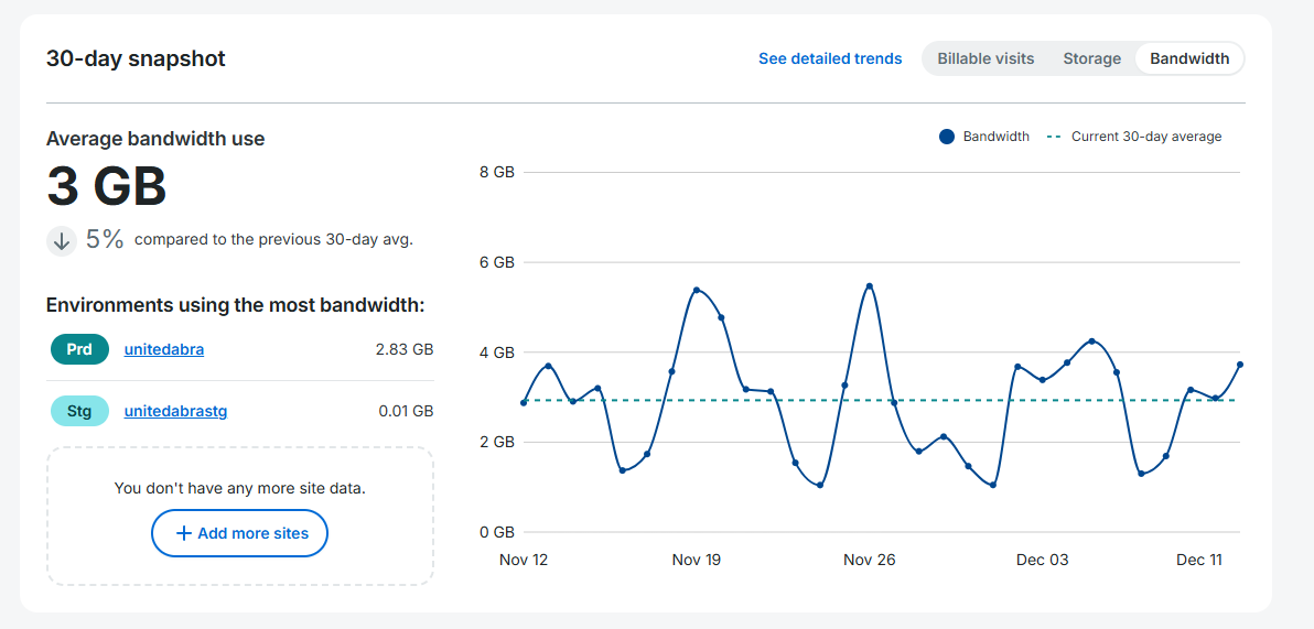

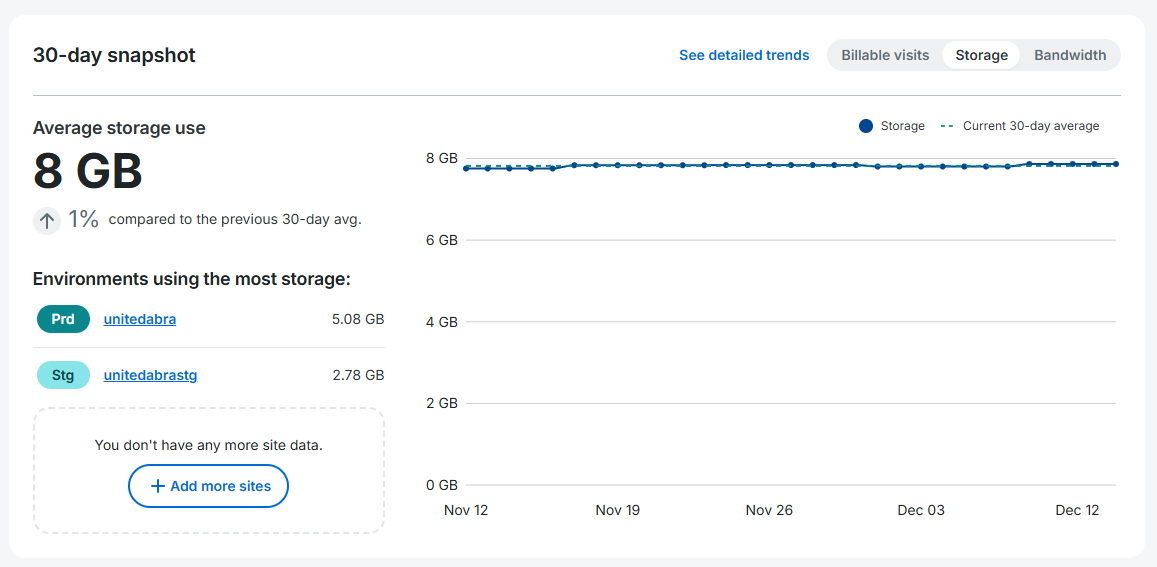

Appreciate the efforts of Technical team, I have increased the memory limit to 512M and max_input_vars limit to 30,000. Here am sharing the Screenshot for server utilization. May be that will help 🙂

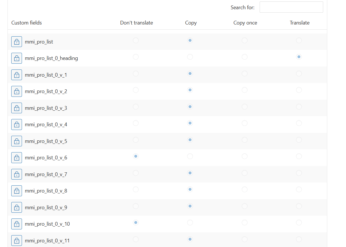

sandraF-13
Kindly, update them with one more thing i.e. I looked into the WPML settings and found that the table with data fields are already not in the count for translation purposes, so it should not likely impact the bulk translations. Plz refer screenshot.
