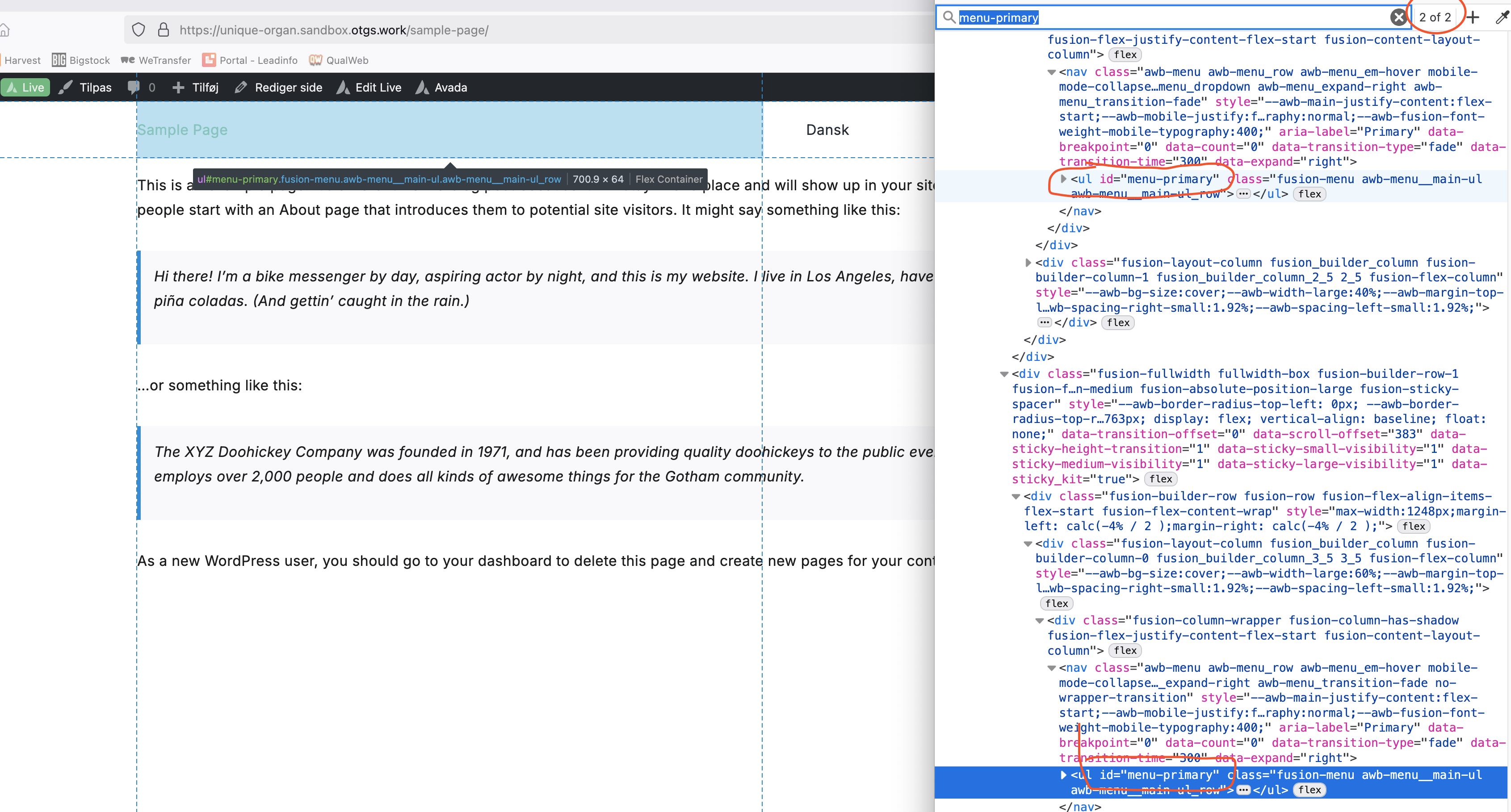

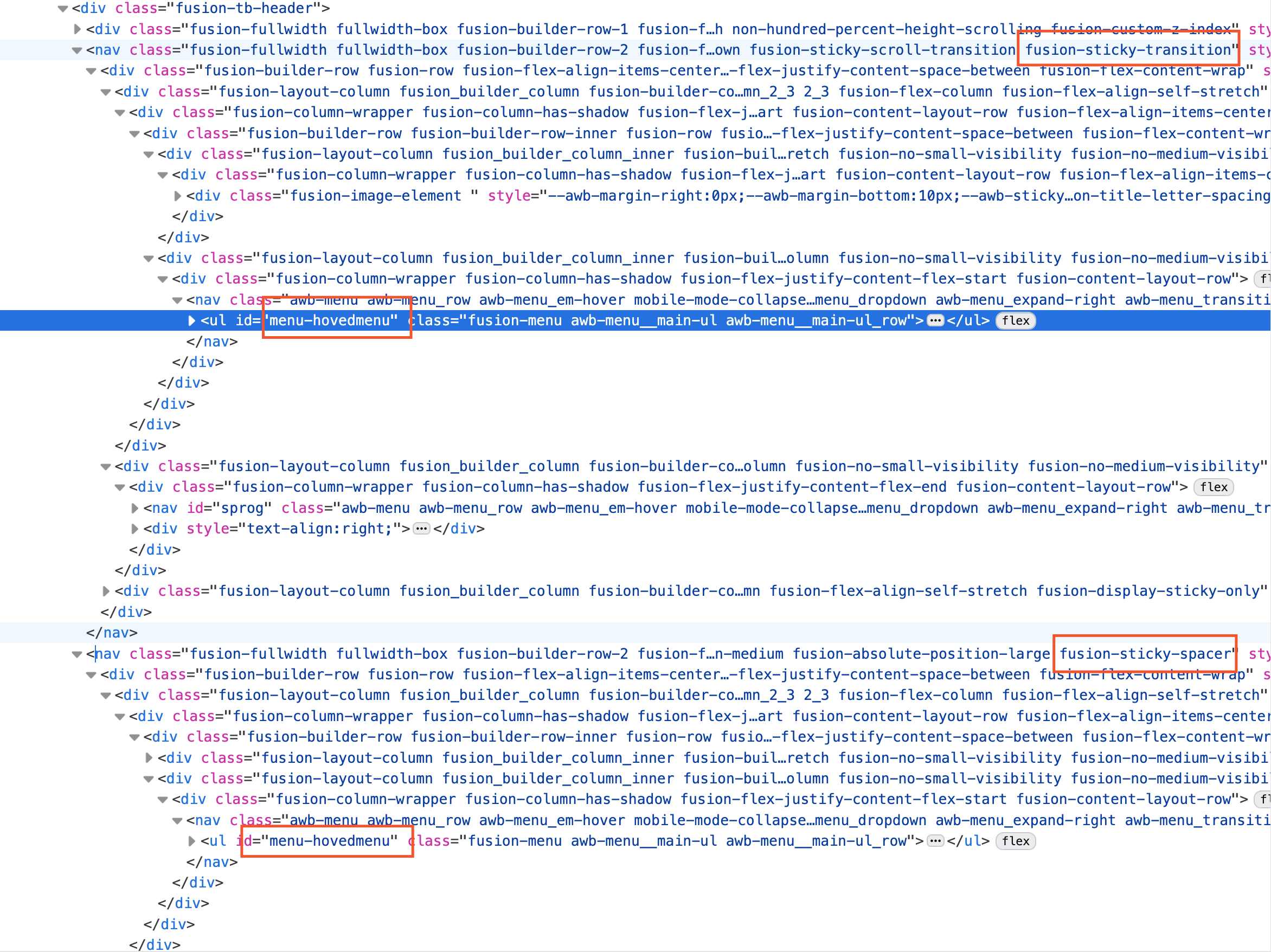

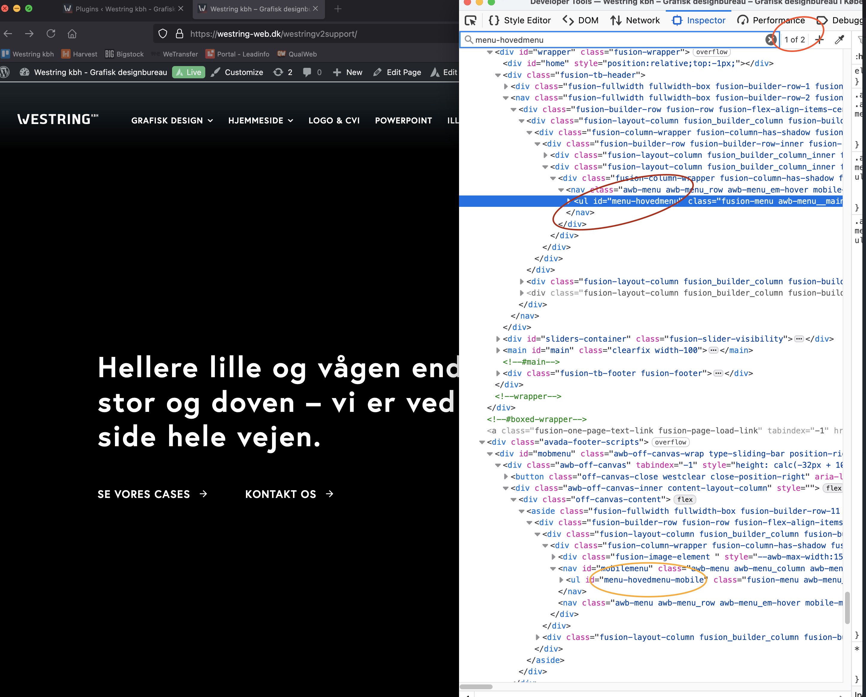

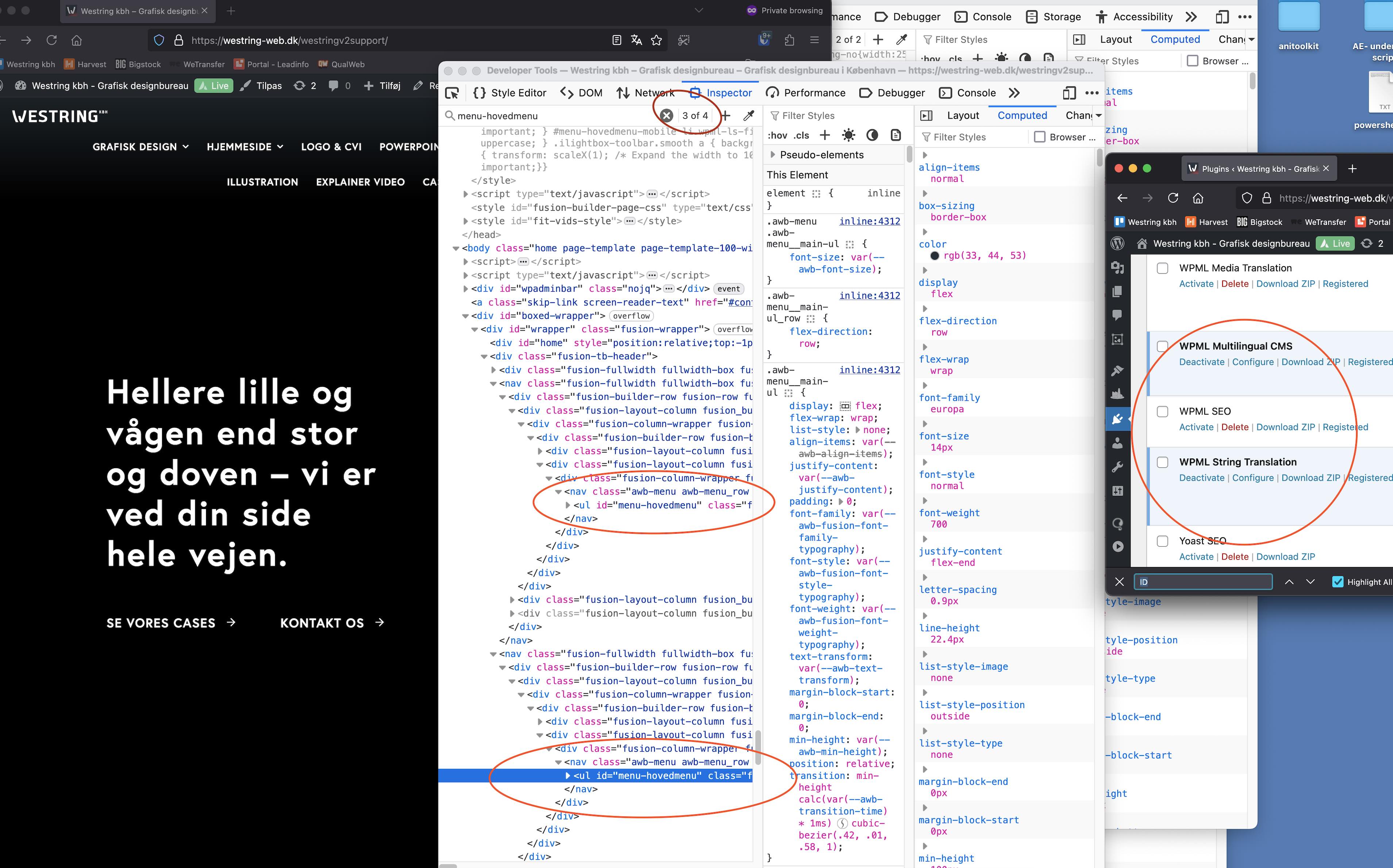

I am trying to make the website pass the European Accessibility Act using the Avada theme with a sticky menu header. This issue only happens when WPML is activated. I have reached out to Avada's support, and they suggested contacting you. Here's a short video demonstrating it: hidden link. Link to a page where the issue can be seen: hidden link
When WPML is enabled, the main menu ID appears twice in the HTML from the start, causing duplicate menu IDs. When WPML is disabled, the main menu ID is only once in the HTML when the page initially loads, and it appears twice when you scroll down.
Why does WPML cause duplicate menu IDs in the HTML?
How can I prevent WPML from duplicating menu IDs?

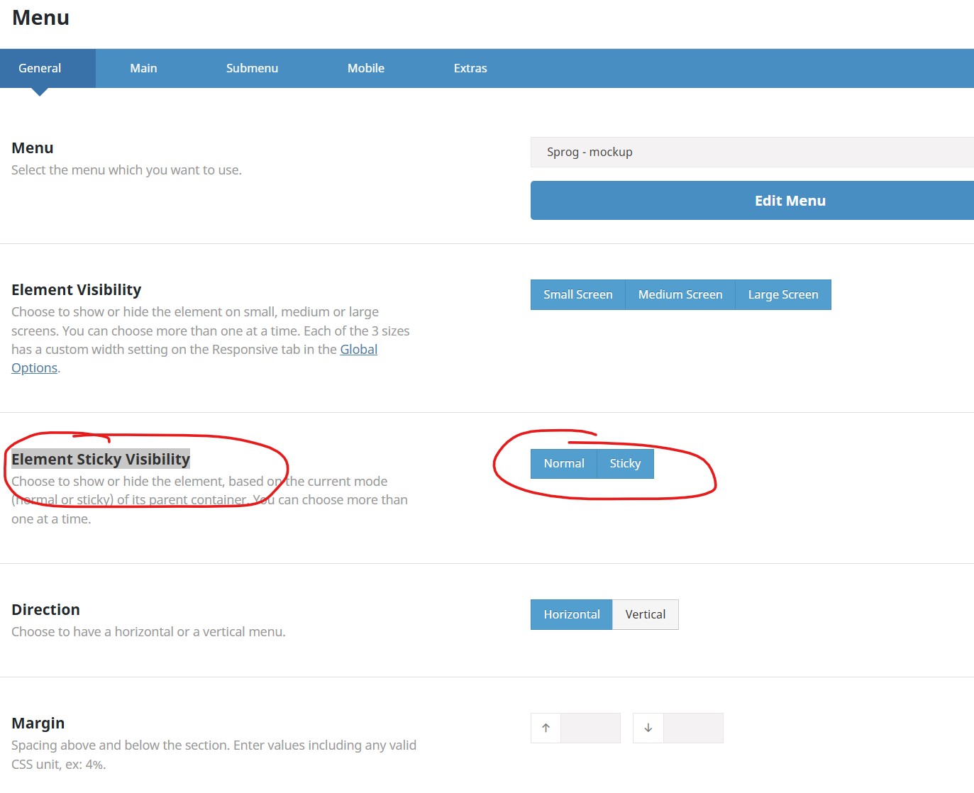

I'm trying to reproduce the issue in a fresh sandbox site at hidden link (one-click login). Here I've installed Avada theme and related plugins and am trying to add that sticky header to the global layout. But unfortunately I can't find "Element Sticky Visibility" (see attached) options in Menu element.
Perhaps I'm missing something in the setup.
Can you please take a few minutes to reproduce the issue in this sandbox site? It'd be great that either you record the screen or write the exact steps that how did you reproduce it. So I can then retry and check further.

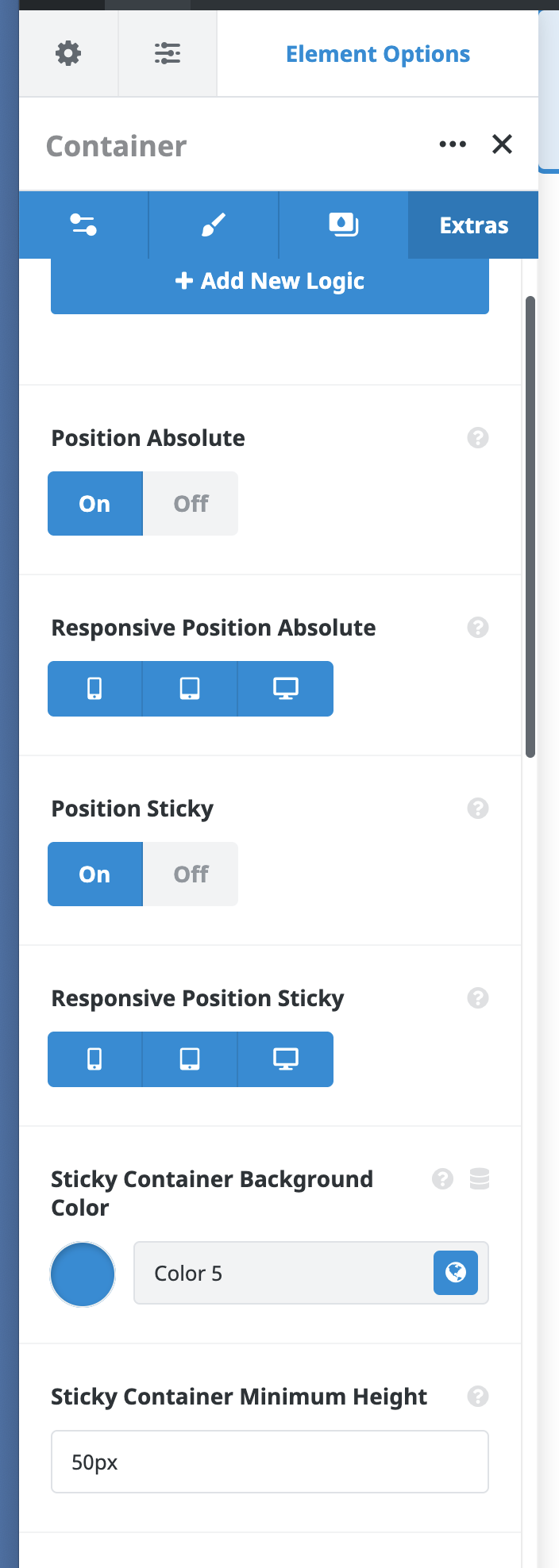

I've set it up more or less as on my own site:

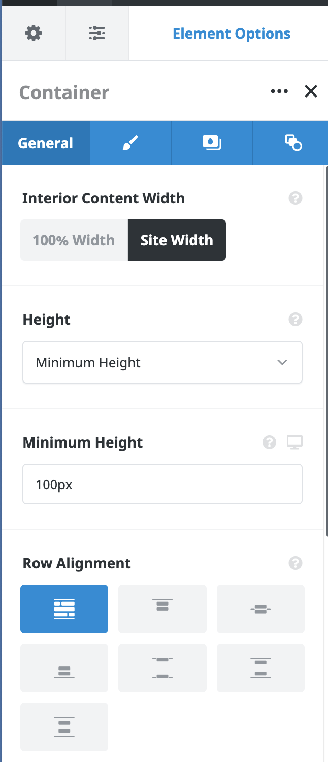

The container is set to sticky (not the menu or column) and absolute.
The container has no background color. Once sticky, it has a background color.
Container has a min-height:100px, when turning sticky it changes to 50px - This seemed to be crucial, as nothing happened until i changed this setting.
I also added a WPML language switcher to the menu, but not sure if this is necessary.

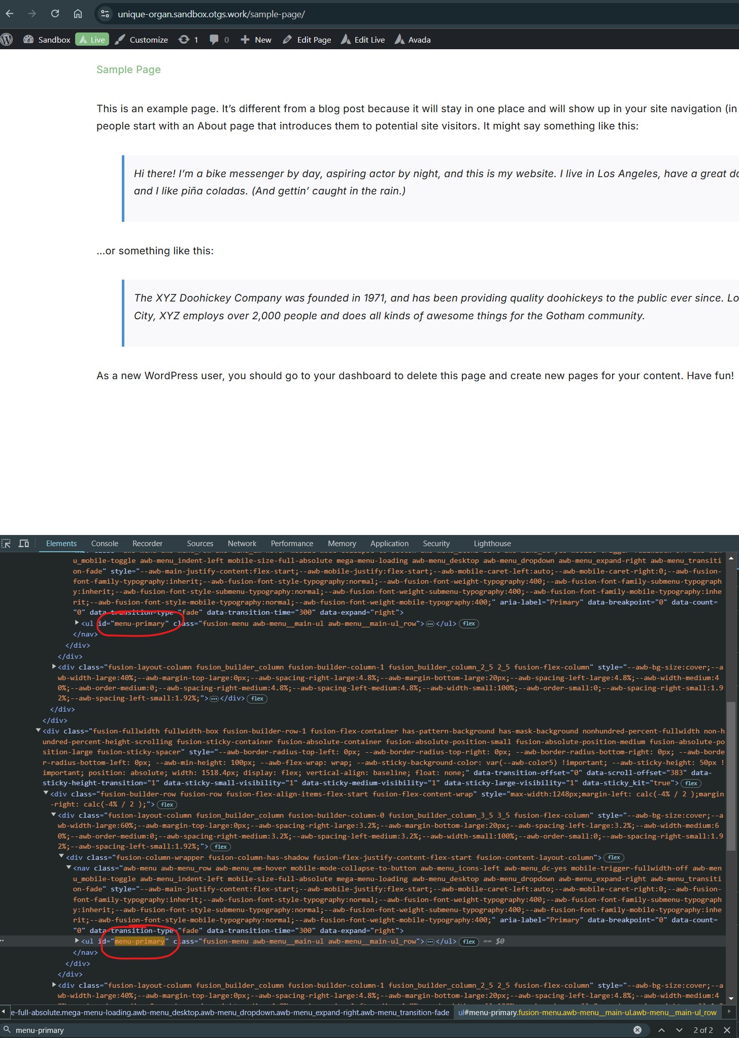

I checked again in the sandbox and noticed that the "menu-primary" ID is still duplicated even without WPML plugins active (see attached). As you can also see that there's no language switcher visible because WPML isn't active.
This is little confusing, because the result is same with our without WPML and I'm not sure if it is really caused by WPML.
Do you have any other thoughts or how we can confirm if WPML is really causing such side-effect?

yes i can see that as well.
That's very strange. On my website the problem is not there when WPML is disabled,
Honestly I've believed it was a bug from the theme from the start, and I wrote to Avada support first. I've only contacted you as well because they told me to. They're apparently still investigating it...
But it is strange that the behavior on my website is different once WPML is enabled.
However, once you start scrolling on my website, with WPML off, the ID appears twice in the html. Just not initially when loading the page, that's the big difference really.
