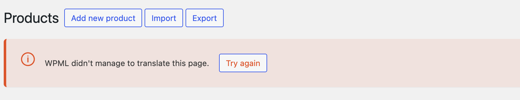

I migrated the server and restored the backup using the all-in-one WP Migration plugin, and re-registered WPML, but I encountered the "WPML didn't manage to translate this page" problem and an installer support error.

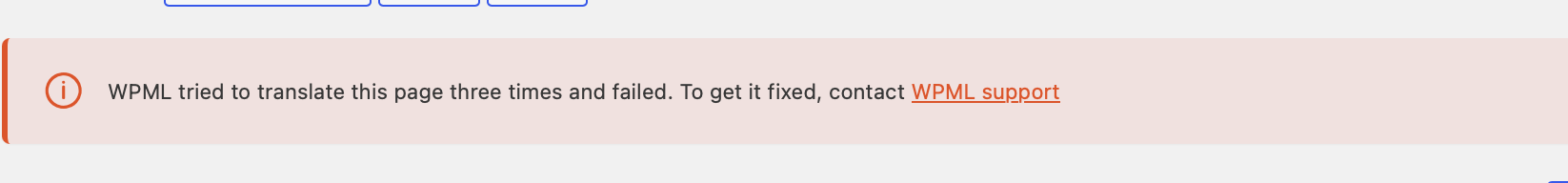

February 28, 2026 at 6:45 am #17861407
devinw-5
Sometimes the feedback results are like this

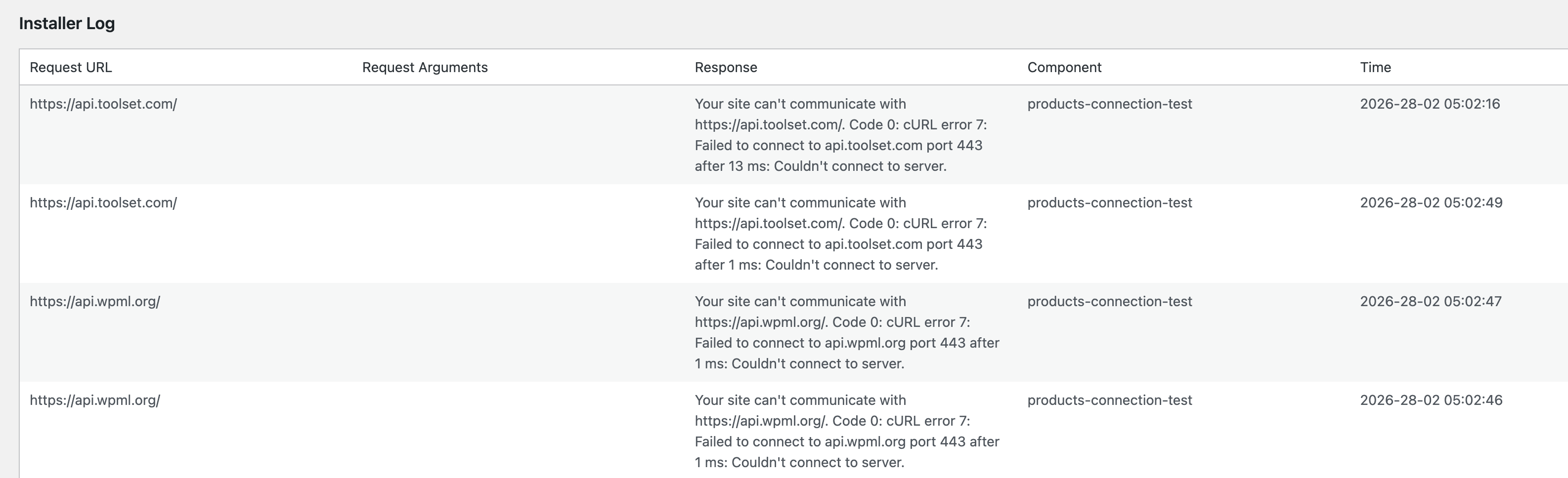

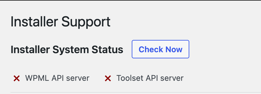

March 7, 2026 at 3:36 am #17878842
devinw-5

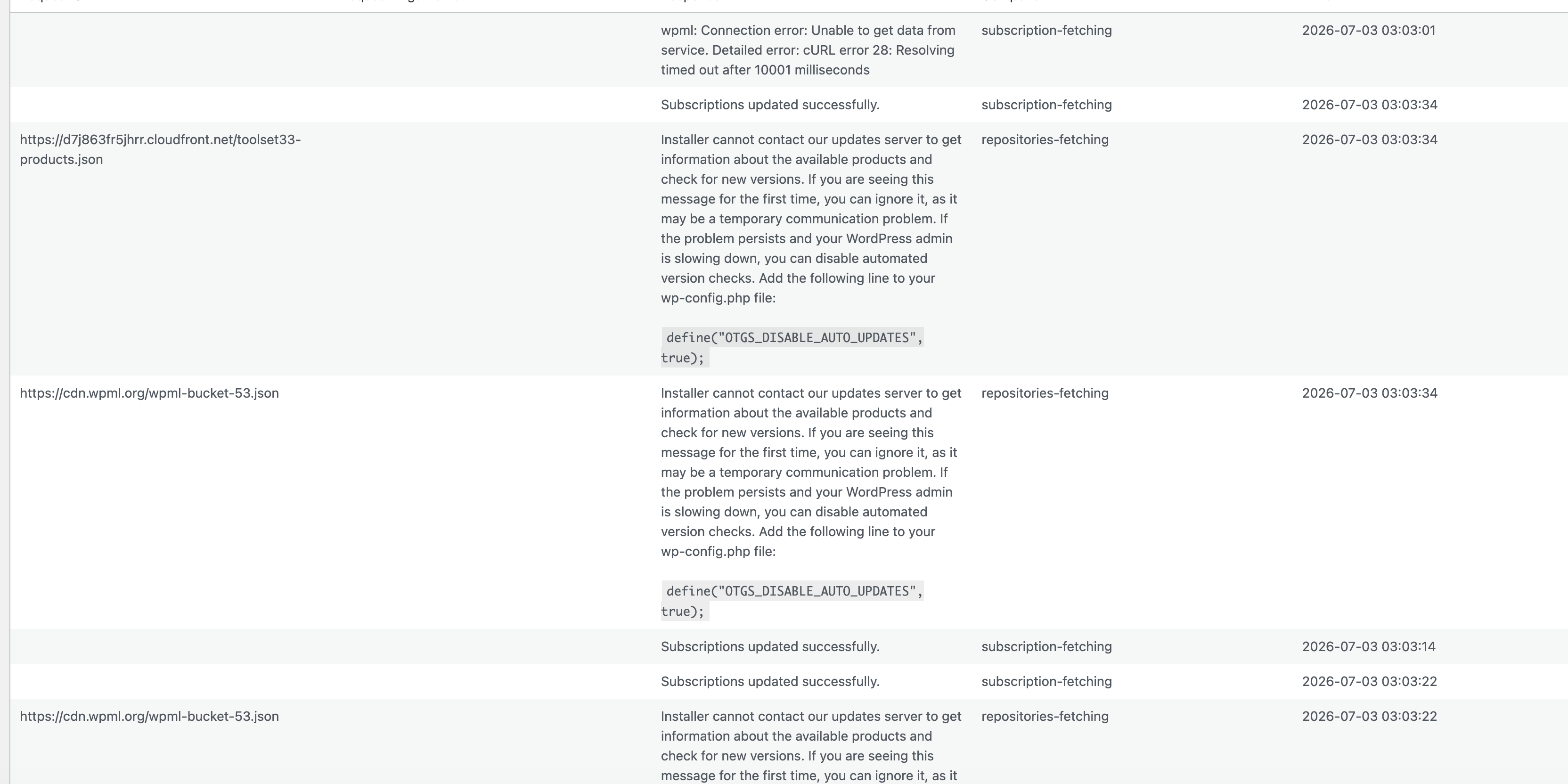

I checked the installer support according to the above instructions. When I clicked the "check now" button, the WPML API server and Toolsdet API server were sometimes working and sometimes showing errors.

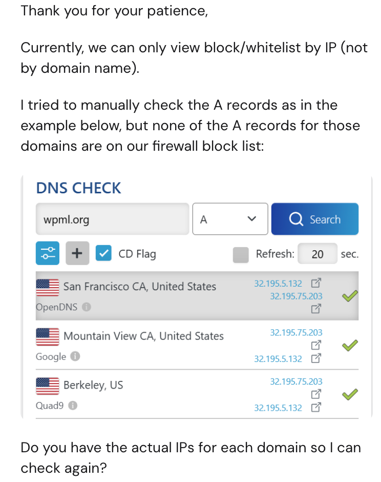

March 13, 2026 at 7:56 am #17894560
devinw-5
Hi, Andrey
Thank you for you reaching out.
And I have contacted with my Hosting platform, the feedback is attached.
Could you please provide me the detailed IPs, so I can investigate problems.
March 13, 2026 at 12:37 pm #17895537
Andrey
WPML Supporter since 06/2013
Thank you for your feedback.
There are no IP addresses available to whitelist—only domain names can be used.
I have also checked this with our system team, and I can confirm that your site is not being blocked on our side. This means the issue is most likely related to the hosting environment.
Please check with your hosting provider to ensure that outgoing connections are not being blocked. It could be caused by firewall rules, security policies, or other server-side restrictions.
