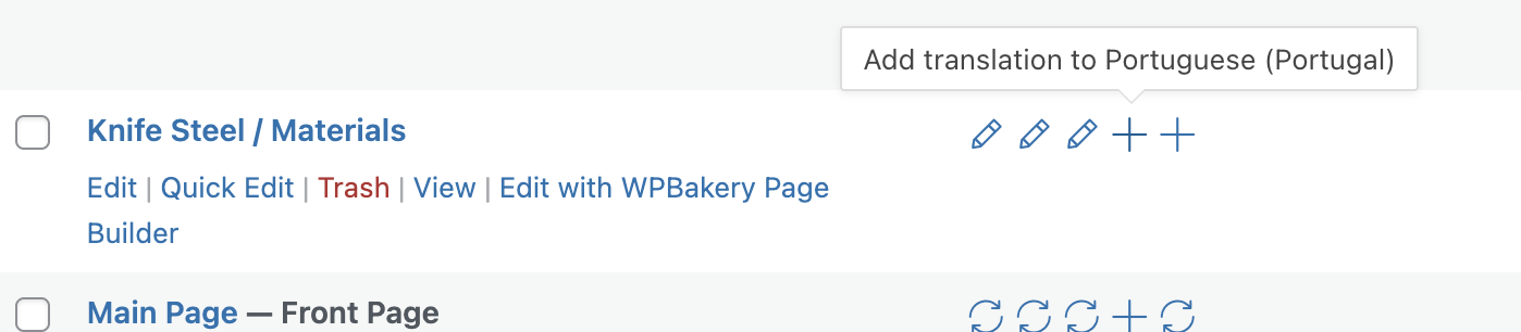

So to create a language version of the related page I click + sign on the right of the page name (ie: please see the attached 001.png as an example to create the Portuguese version of the page).
Then I copy the content from English verison and then change all the text (content) to that language (ie: Portuguese).
