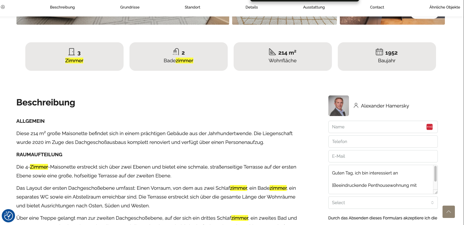

Otto
I visited the page, and it was properly translated, check the screenshot attached. All "zimmer" and no "rooms". Am I missing something?
It may be due to browser's cache. I suggest checking with a different browser or in incognito mode, or clearing the browser's cache.

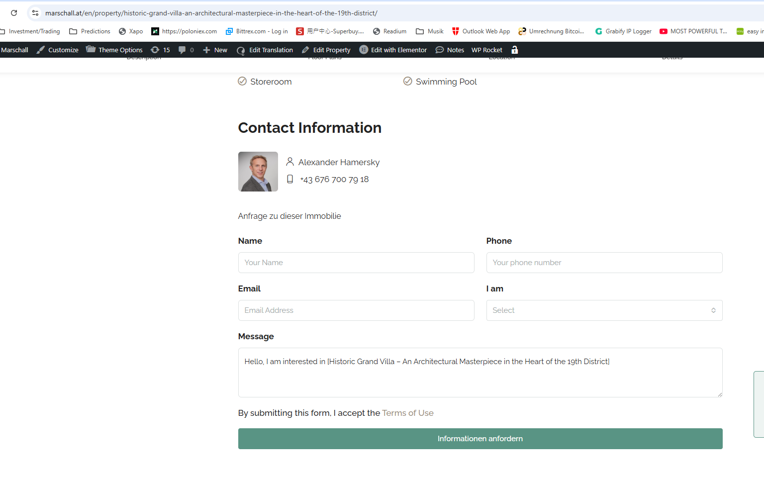

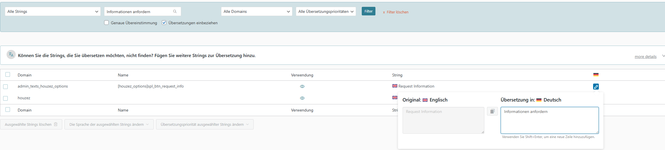

So to be more specific.
I will highlight multiple cases in screenshot where WPML config is correct (String TRanslation), but it shows DE String in EN Page.
You can find here, e.g.
Informationen Anfordern (Check Screenshot)
or other fields that are correctly configured in WPML but not showing correctly.
I tried cleaning WPRocket Cache, but also WPML Cache + Delete Ghost Entries.
