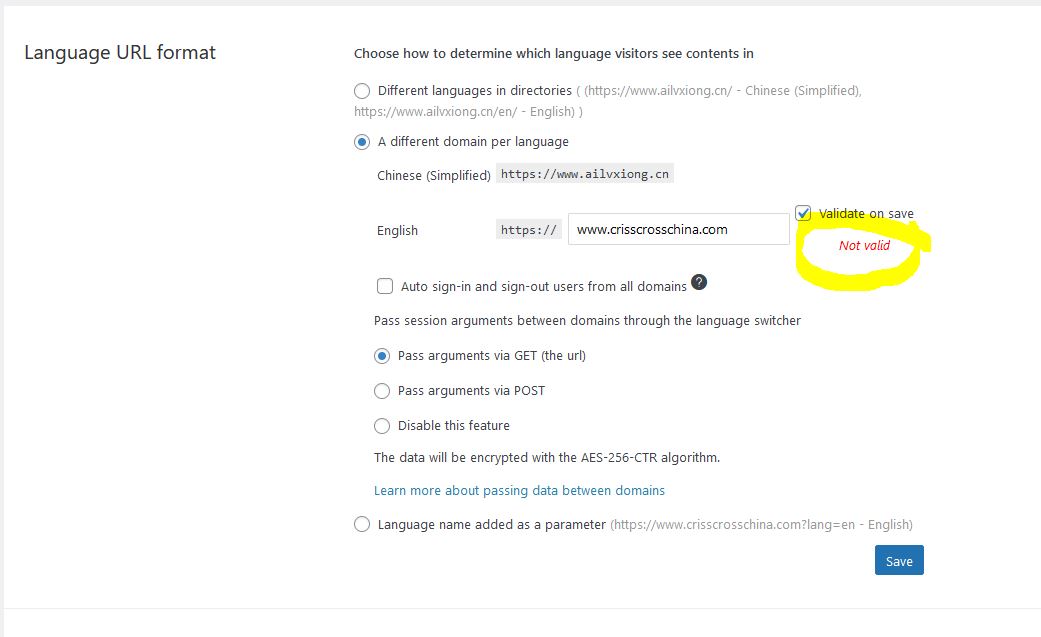

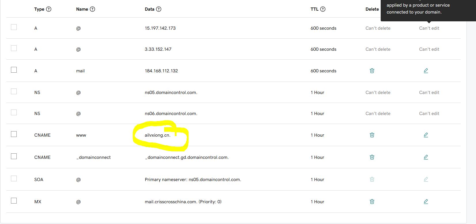

Can the issue be something with DNS? Should there be crisscrosschina.com or ailvxiong.cn in the picture 3 marked with yellow? This is from Godaddy DNS settings

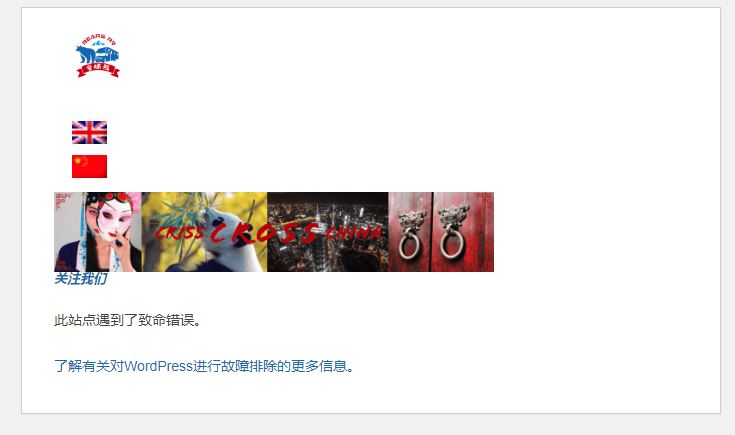

Hi, if I disable the string translation all looks ok. When enabling the pages gives this error

Same issue occured again. Cannot open Elementor pages
