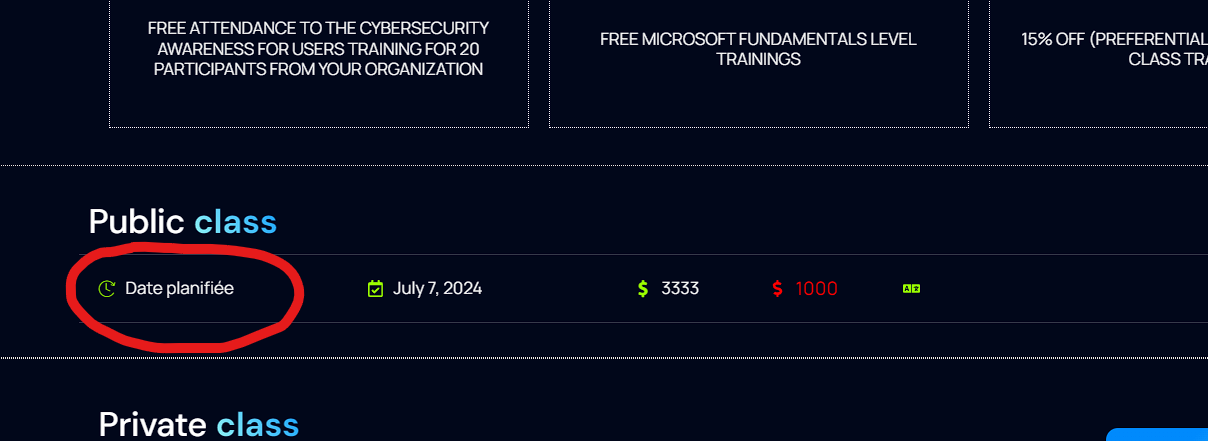

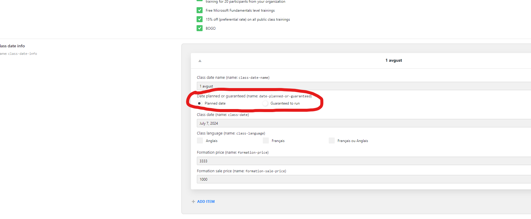

I have a custom post type called 'courses' with a repeater meta field containing fields like class date (date), class language (text), and Date planned or guaranteed (radio button). I created a query and listing that works fine in the main language. I managed to translate field names using WPML string translation in the admin and changed them to English names.
When I want to list dates in another language, I cannot translate the radio button values (e.g., 'date planned' to 'planifiee' or 'guaranteed to run' to 'date garantie'). The fields still show in the main language (French) when using the repeater query/listing display on the post page.
Where can I translate the radio button values in the repeater field?

update of problem.
Translation work with all fields from jet engine, except with radio button options. Those options, even translation is visible in admin area of custom post type, in listing in frontend its still pulling data from main language radio options .
All other fields (checkbox, text) are working ok, using wpml string translation is possible to translate them and its displaying normal on pages.
