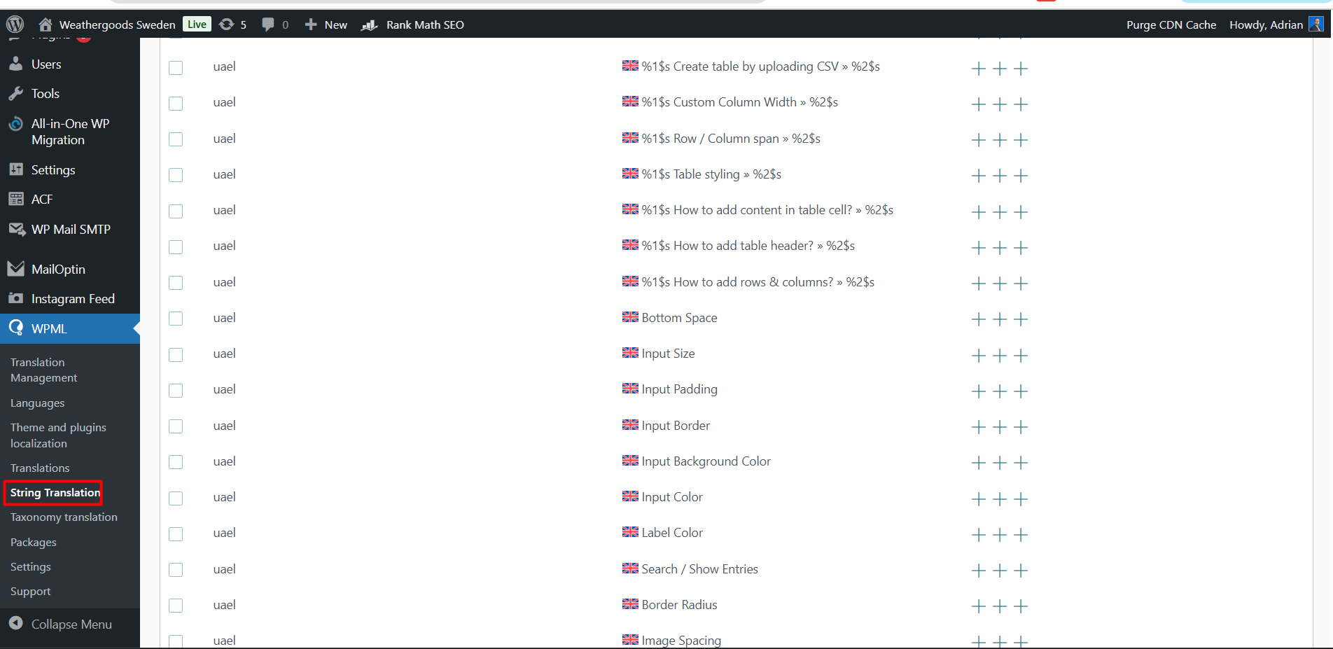

My developer says this -
unfortunately this version of the plugin did not solve the problem.
in my last research I identified the problem in the translation strings, this is done by the plugin "WPML String Translation"
1\. if you disable the WPML String Translation plugin, the error with klarna does not occur
2\. if I add a new language, the problem will not occur in the new language, the problem exists only in three current languages ​​FR, DE, SV
3\. if I leave the WPML String Translation plugin active and start deleting translation strings in the wordpress admin panel, after deleting some of the translations, the error also disappears
so my conclusion is that there is an error in the translation strings, but I can not understand which strings cause this error since there are a lot of translation strings, today I will also continue my research since I feel that I am very close to the answer
pass my research to wpml support, I think this should suggest a solution to them

You mentioned your developer found corrupt files - can you please tell me which files they found that were corrupt, and what exactly was corrupted? I did review the screenshots but saw String Translation, nothing related to a file. I'll be happy to review the file that you found and share your findings with our development team once I have more information.

After many hours our developer managed to fix the issue with the corrupted files. He spent hours going through them to find the corrupted strings and fixed the issue with the klarna checkout staying disabled. This also fixed the issue with the payment options not showing in klarna. It is very unfortunate that I had to spend alot of time money and stress when it I feel it could have been solved earlier if the issue had been attended to, but since there where no proper replies to my developers feedback on the issue, we had to try to solve the issue ourselves. WE where very lucky to find a developer who is a wpml expert and did not give up on us or the issue.
