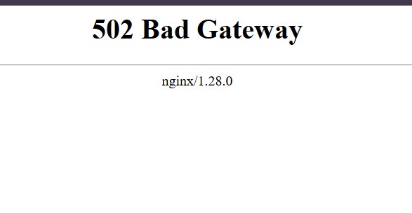

December 4, 2025 at 9:36 am #17633199
Noman
Thanks for sharing the login details. I’m unable to access the wp-admin page as it’s showing a Bad Gateway error, as you can see in the screenshot. Could you please check this on your side?
Thank you
