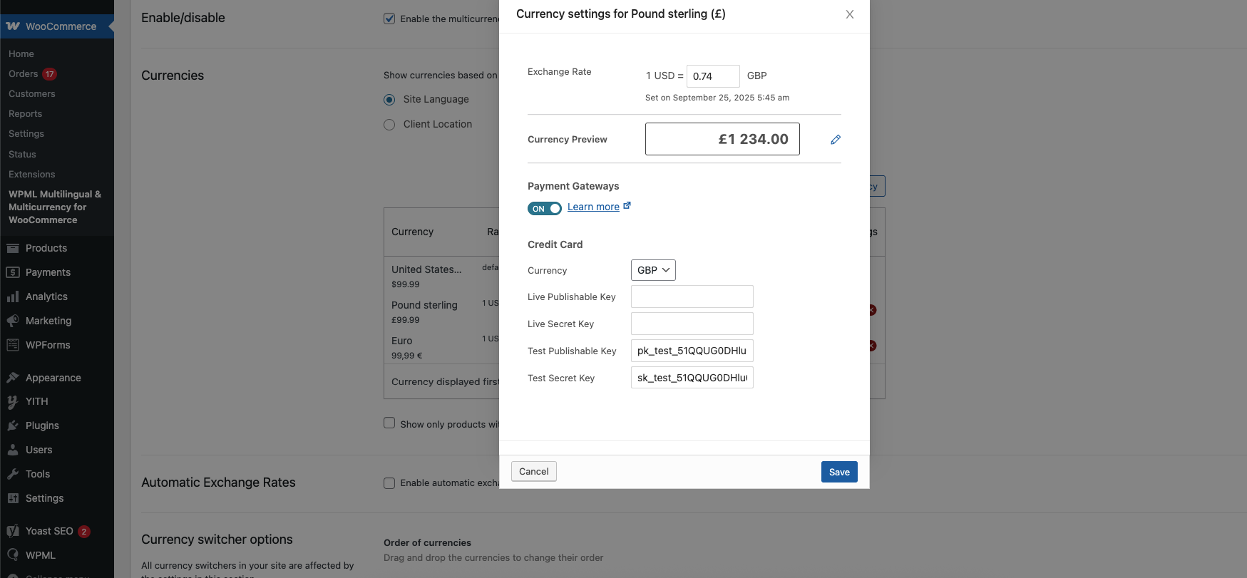

We are using the WPML Multilingual & Multicurrency for WooCommerce plugin on our WooCommerce site, which supports three currencies: USD, EUR, and GBP. We have a multisite setup, and our store URL is: hidden link. We need to receive payments through different Stripe accounts based on the selected currency: USD transactions should be processed through Stripe Account A, and EUR and GBP transactions should be processed through Stripe Account B. The payment process is working correctly, and the funds are being received in the appropriate Stripe accounts based on the currency.
For USD orders, refunds work as expected via Stripe Account A. For EUR and GBP orders, refunds fail with the following error message in an alert box: There was a problem initiating a refund: No such charge: 'ch_3SDKOrDHlu6YHS740zjkE033'.
Could you please help me out to resolve the issue with refunds for EUR and GBP orders?
Is there any specific configuration needed for handling refunds with multiple Stripe accounts?

October 3, 2025 at 7:09 am #17453509
veronicaC-12
Hi Bobby,
To test this issue, you can set up the WooCommerce Stripe Gateway along with WPML configured for multiple currencies, such as USD, GBP, and EUR. Please ensure your Stripe account is properly set up. On the product page, use the language switcher to place orders in different currencies. For configuring payments in each currency, kindly refer to the previously shared attachment and use the same Stripe publishable and secret keys for the EUR and GBP languages as well. Then, try placing and refunding orders to better understand the issue.
It appears that there is no problem with using multiple Stripe keys for order placement - orders are being placed successfully using two different Stripe accounts. However, the refund process does not seem to work as expected. If your plugin supports multiple payment options, it's important to ensure that all payment-related scenarios, including refunds, function smoothly.
Currently, while the order placement works, the refund may fail - especially when processed in a different currency. It seems that during a refund, the system might be using credentials from Stripe Account A instead of Stripe Account B, causing it to not locate the correct charge ID and resulting in a failed refund.
Please let me know if you need more details.

One item I want to clarify on is, how are you configuring the multiple stripe accounts?
Are you adding separate stripe API keys per currency configuration?
October 4, 2025 at 6:35 pm #17456252
veronicaC-12
Hi Bobby,
Yes, we are adding separate stripe API keys per currency configuration!
