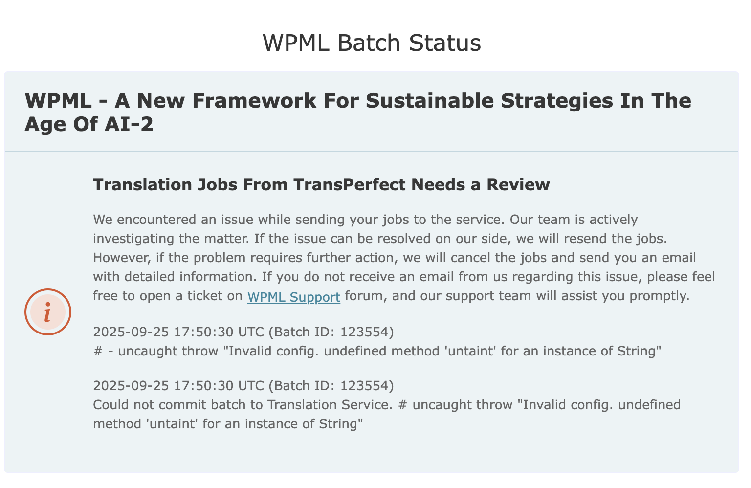

I am trying to resolve an issue with WPML not translating in Global Link / Transperfect for my site hidden link. I can't find my old support ticket for the project at hidden link. I am following the documentation titled 'Translation Jobs From TransPerfect Needs a Review'. There was an issue while sending jobs to the service, and the team is investigating. If the issue is on their side, they will resend the jobs; otherwise, they will cancel them and notify me via email. I have not received an email yet. The error log shows: 2025-09-25 18:26:36 UTC (Batch ID: 123556) - uncaught throw "Invalid config. undefined method 'untaint' for an instance of String" and 'Could not commit batch to Translation Service.'
WPML is not translating in Global Link / Transperfect. Error message: 'Invalid config. undefined method 'untaint' for an instance of String'.

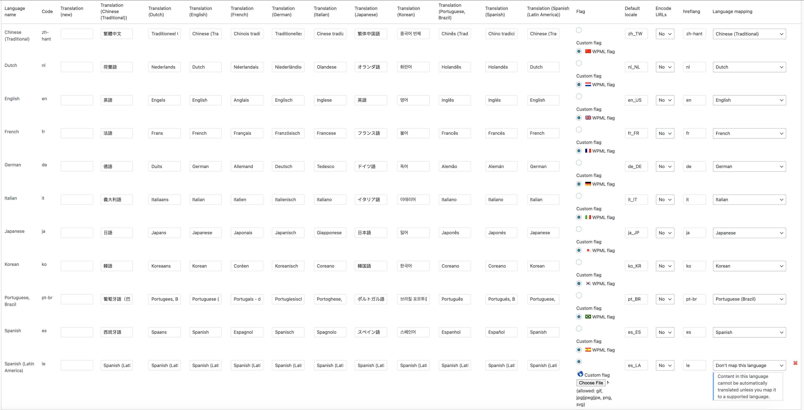

Please let me know if mapping the language correctly had any impact on the error that you were receiving. If the error is still happening when sending to translation, I will inform the translation proxy team so that we can get this fixed for you.
September 25, 2025 at 10:18 pm #17434052
BlogAdmin
The mapping had not changed, and it does not work. Please inform the translation proxy team as soon as possible, please

Hi, just in case it's helpful, I've attached the full mapping. Let me know if Spanish (Latin America) needs to be changed. On September 21, 2025 it worked fine with these settings. Thanks

This is Ahmed Mamdouh from the translation proxy team.
I checked our logs and I found that there is an error coming from the TransPerfect API.
I informed them of all the needed information, and they are investigating the issue right now.
It would be great if you could also follow up with them.
Ahmed Mamdouh.
October 1, 2025 at 5:23 am #17447103
Ahmed Mamdouh
Kindly be informed that the issue has been resolved.
Please try again and let me know if you need any other help.
