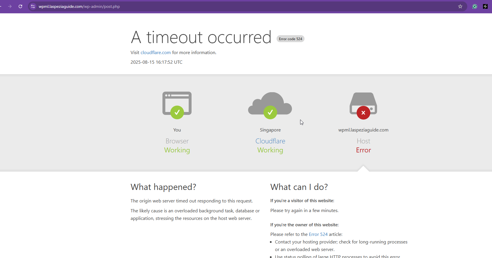

August 15, 2025 at 4:41 pm #17323986
Thanks for your reply. While opening the report, I tested with WPML plugin deactivated and the Error code 524 - A timeout occurred issue persists. This doesn't seems to be related to WPML after all and you'll need to reach out to your hosting provider for further assistance. Here is what I've done.
1. Deactivated WPML plugin.
2. Edited this page hidden link
3. Clicked Update
4. Error code 524 - A timeout occurred shows as shown in the attached screenshot.
