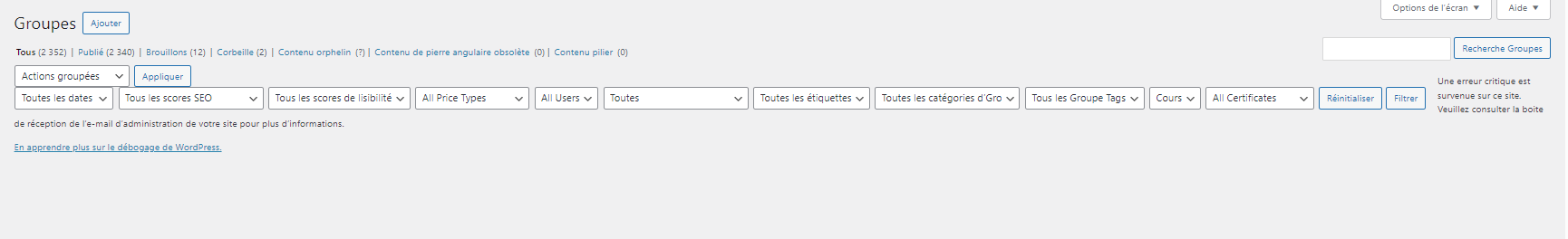

February 21, 2024 at 6:21 pm #15329971
mustaphaG-2
When i access to the link hidden link , i'm getting the problem in the screenshot attached

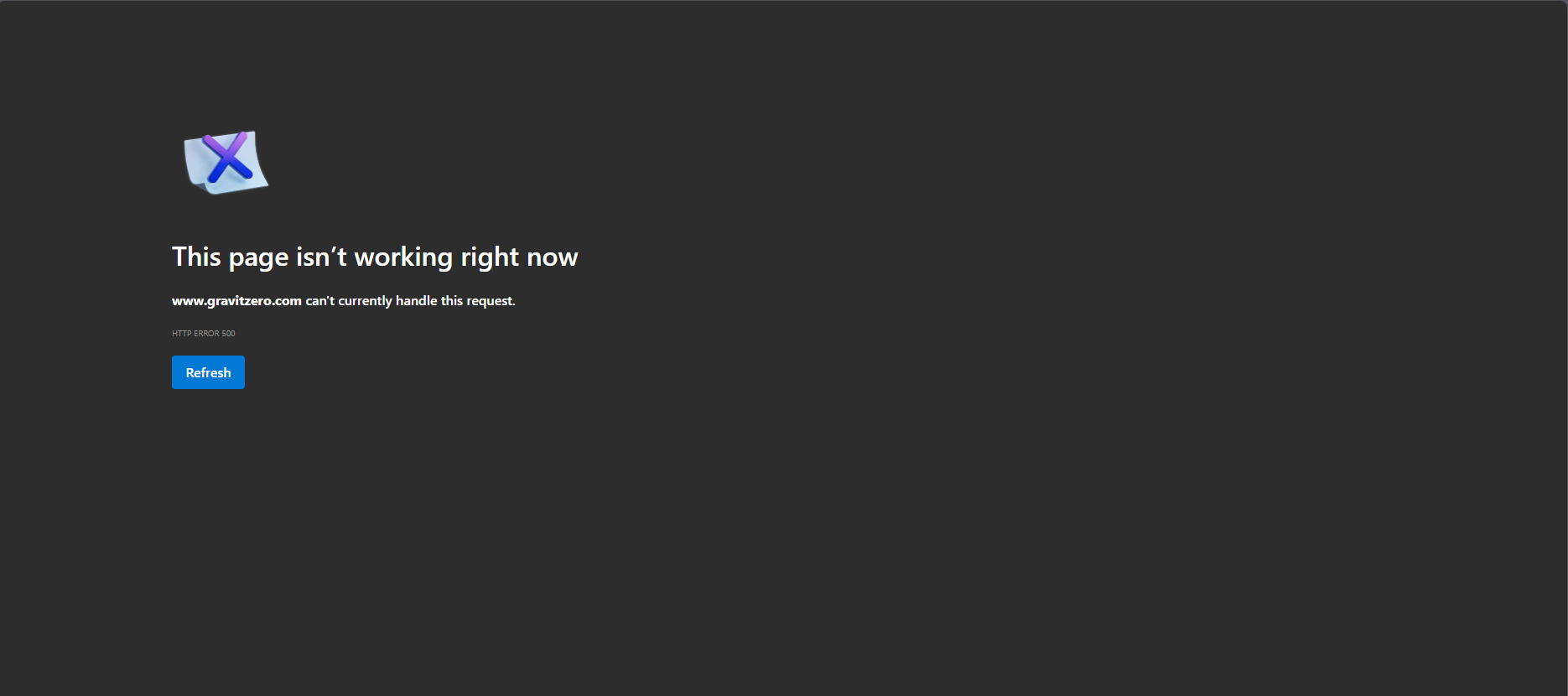

February 21, 2024 at 7:34 pm #15330267
mustaphaG-2
Btw , sometimes i get this page with critical error :

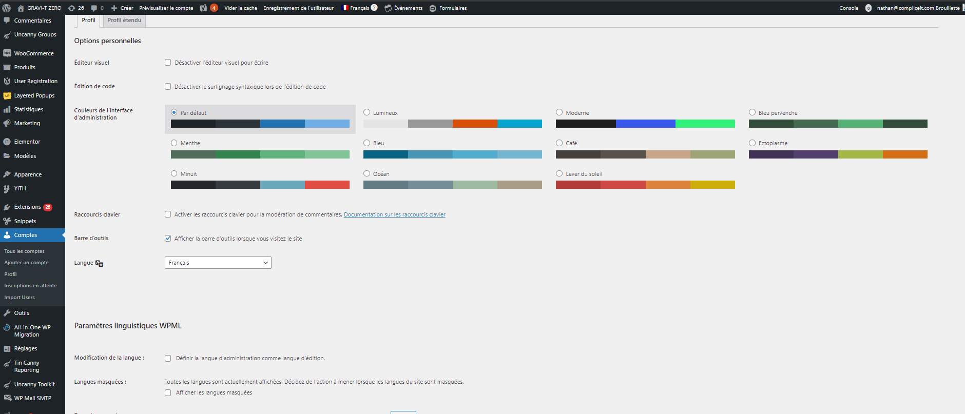

February 22, 2024 at 7:51 pm #15335497
mustaphaG-2
I just found why you couldn't reproduce the issue , in fact the problem occurs only to users that have French as default language (see attached image) , i just changed the default language of the account i provided and could reproduce the issue

February 26, 2024 at 6:28 am #15342265
Waqas Bin Hasan
WPML Supporter since 05/2014
Thank you for the updates.
I was able to reproduce the error by switching user profile language to French. Then I observed the debug.log for latest errors and found a lot of repeating errors.
I've stripped down to the most important ones, specially the ones which are "PHP Fatal error". These are the errors which break the site and mostly are about "Allowed memory size of 536870912 bytes exhausted", see the stripped down version of the errors below:

The "allowed memory exhausted" error is related to server/hosting settings (or resources) so I recommend checking with your hosting/service provider. See https://wpml.org/forums/topic/allowed-memory-size-of-536870912-bytes-exhausted-tried-to-allocate-20480-bytes/#post-11770711 for details.
There are other errors in the log which also refer to different 3rd party plugins/theme. I recommend, updating all plugins because I see several needing an update.
I haven't deactivated any plugin in your site, there are 65 plugins active, many needs an update and since it is a live site, I am unable to take risk to test directly there.
If after updating plugins and consulting with your hosting provider about resources, you still run into the same issues, I'll recommend preparing a staging site by cloning the complete site. We can arrange for a temporary license of buddyboss for testing.
