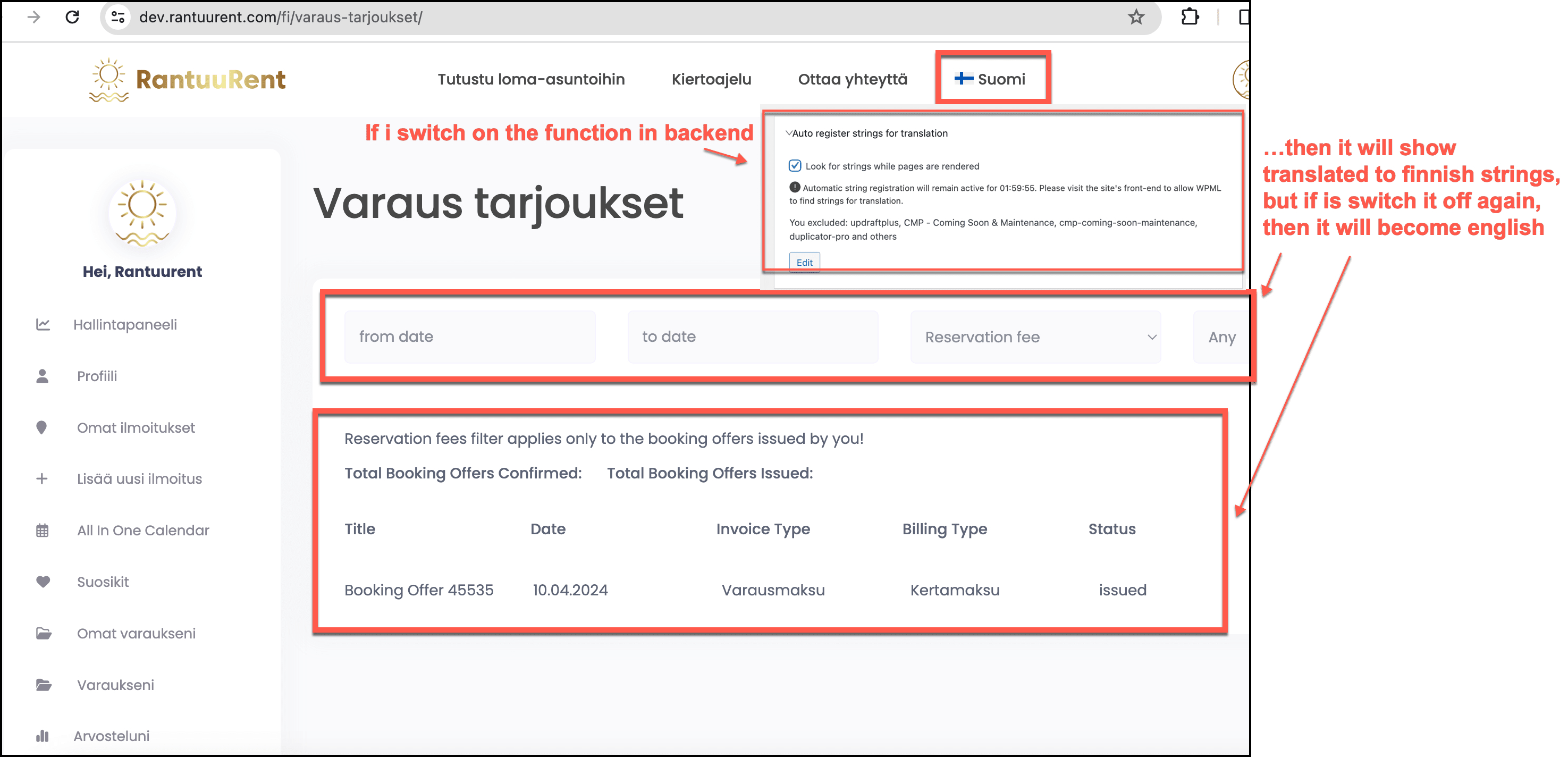

I am trying to: translate the invoices page strings, WPML found the strings with the functions switched ON: "Look for strings while pages are rendered". I see the translated strings while the options is set. Soon as I turn this function OFF, then the strings become in English again.
I expected to see: the translated result.
Instead, I got: language strings in site default language (english).

I've checked your screenshot and I think I know what's going on here. If there are other language files outside of the WPML language folder, they could indeed cause conflicts.
Performing a full backup before making any changes is always a good practice to ensure you can revert to a stable state if anything goes wrong. Once you've backed up your site, you can proceed with removing the language files outside of the WPML language folder.

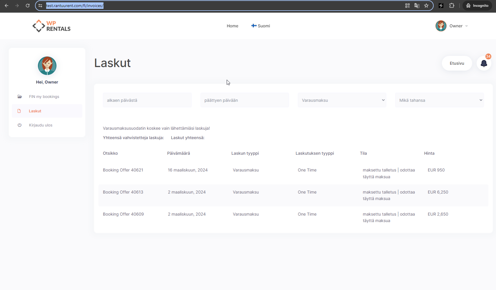

I'm able to fix most of the issues as shown in the attached screenshot. However, I'm still having some issues trying to translate some other strings like Booking Offer and One Time.
