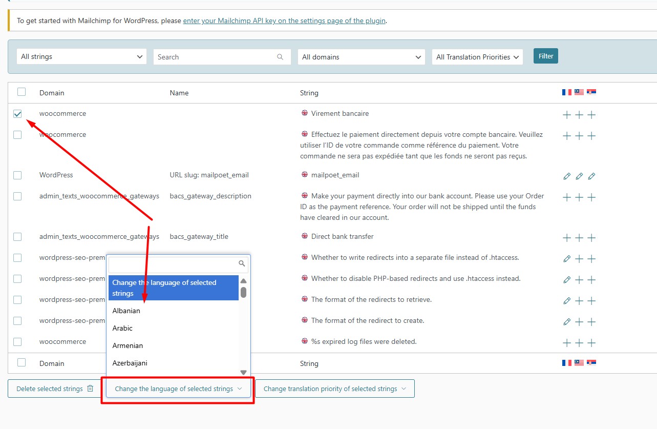

I added the code and i do the scan on my plugin.
Now the banner_image_url exist on string translation, but the language that found is English and NOT el (greek) wich is the default wpml language.
This happens for all string translations!
This is wrong because the actual strings is greek.
Why?
December 23, 2025 at 11:12 am #17684368
Noman
Thank you for contacting WPML Support. This issue usually happens when the site default language is other than English and You should be able to assign to correct source language by following the step-by-step instructions from this doc: https://wpml.org/documentation/getting-started-guide/string-translation/how-to-change-the-source-language-of-strings/
Thank you

Yes, here i can change the default translation language.
Thanks.
