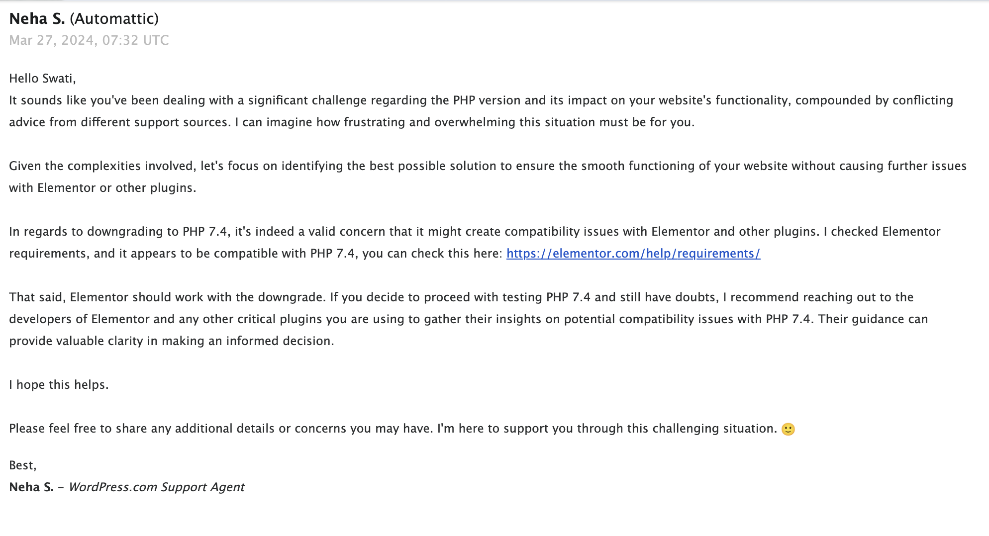

March 27, 2024 at 8:09 am #15453817
ashkanN-2
Lucas, we're reaching out to the WordPress team to figure out the most practical solution for our situation and resolve the issue. I'll pass along their latest feedback in case you have any input. (Refer the screenshot.)
Additionally, are you still using the duplicator package access, or should we revoke it? Please let us know.
March 27, 2024 at 11:53 am #15455287
Lucas Vidal de Andrade
WPML Supporter since 11/2023
Downgrading can be a practical option. Please note, that you might encounter "Deprecated" warnings if you do that. They're only warning sand should not affect the functioning of the website.
As for the package, you can revoke it.
