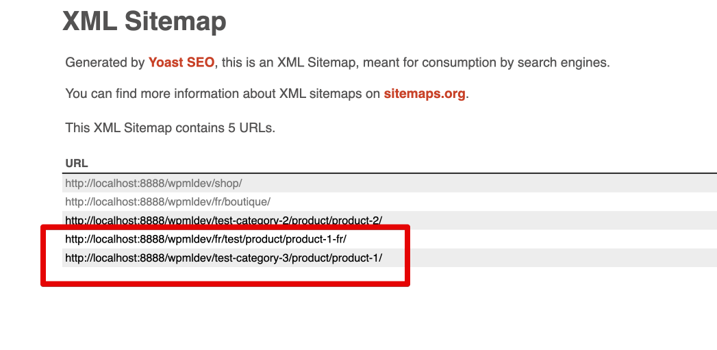

I've tried to replicate the issue on my site but didn't see the same as you reported. What I have:
- a product in English and a translation in French
- a primary category in English and a translation in French
- a primary category in English and no translation in French
If the translation product has a different primary category, it still shows in the Yoast sitemap as well. Please check the attached screenshot.
Can you please share clear steps to replicate the issue? Or share the temporary access (wp-admin and FTP) to your site so I can take a better look at the issue. It would be better to have a testing site where the issue is replicated. Your next reply is set to private to share the info.
